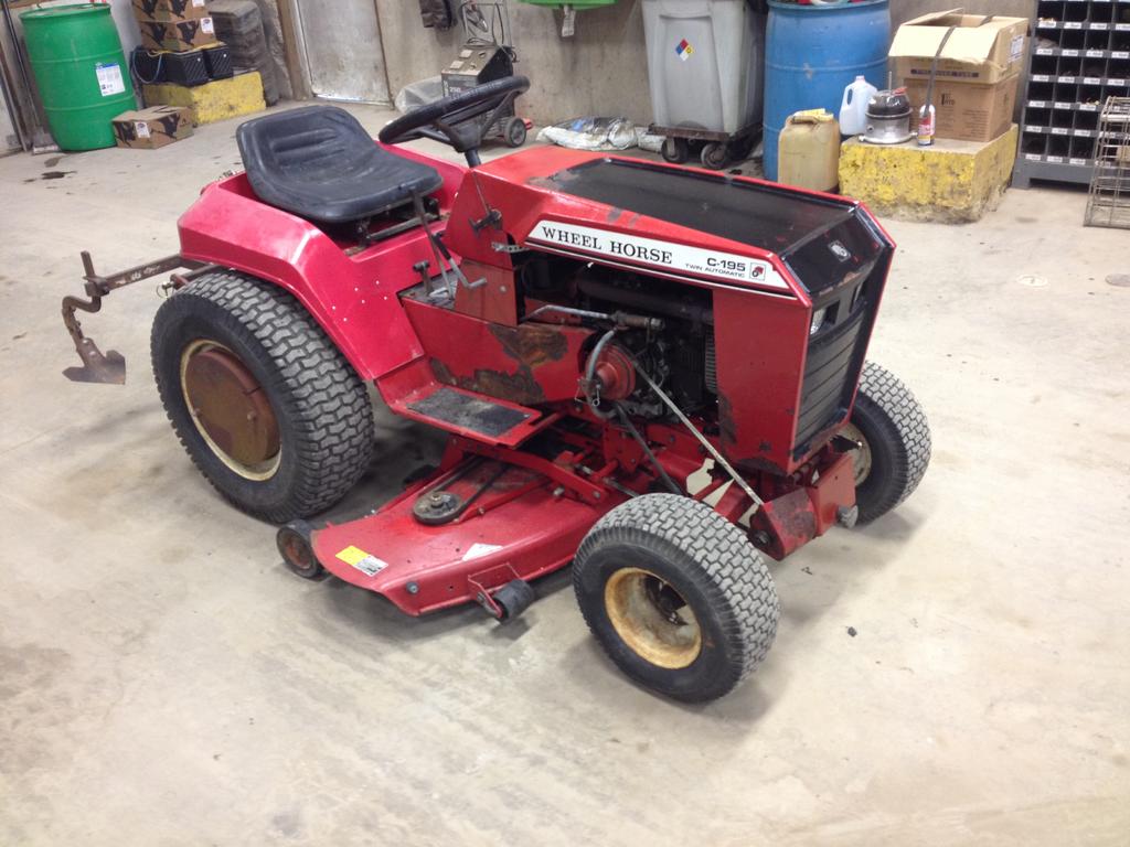

BPEisenhower 553 #1 Posted April 21, 2018 Good afternoon Horse fans! I got bored and power washed the garbage find C195. I found this over a month ago and now have the itch to repaint this summer and find decals. Any advice on color and paint brand is welcome. I also washed Raider 14 and think it will be painted first but needs wiring and find correct decals too. It had bold white letter like the no names had. The people that gave me the C195 saw it today and can't believe it runs/mows and moves. I was told it was junk and have rocks in my head for wanting to keep it. Now that it's operating again, them people want it back. Lol. No, too bad. The gravel in my head won't move. Long story short, this was my great grandfathers tractor. It was sold in 91 at his auction when I was 12 and kept track of it for 27 years. Sadly it sat outside after it left our farm but now is back in the same shed when delivered in 82. Thank you all for the help with everything so far! Any information, advice on paint and decals is welcome. Have a great day and enjoy Horsing around! 🎉😊 2 2 Share this post Link to post Share on other sites
boovuc 1,090 #2 Posted April 22, 2018 I use Rustoleum Sunrise Red for my WH Red match. (close to it). For Blackhoods, I use a flat black to paint the hood's top and surrounds. Gloss black doesn't look original at all. For Blackhood wheel rims, Rustoleum Antique white is almost perfect if you can find it anymore. I haven't bought any in years. For decals, the only source you need to go to is this gentleman: https://www.redoyourhorse.com/ 1 1 Share this post Link to post Share on other sites
BPEisenhower 553 #3 Posted April 22, 2018 19 minutes ago, boovuc said: I use Rustoleum Sunrise Red for my WH Red match. (close to it). For Blackhoods, I use a flat black to paint the hood's top and surrounds. Gloss black doesn't look original at all. For Blackhood wheel rims, Rustoleum Antique white is almost perfect if you can find it anymore. I haven't bought any in years. For decals, the only source you need to go to is this gentleman: https://www.redoyourhorse.com/ Thank you for taking the time to help me! I wasn't sure about restoring or leave it be but, all the pictures I see of these WH repainted makes me believe it is aching for a fresh coat 😀 Share this post Link to post Share on other sites
peter lena 9,331 #4 Posted April 22, 2018 having a black hood c 85 for 36 years, I use the gas grill, black satin finish for the best look, not bright and shinny , just a clean satin finish. I also use premium décor gloss " fiesta red " for the main color. simple easy , prep , tape/paper masking and paint, keeps tractor looking fresh. just stay after it . pete Share this post Link to post Share on other sites

JERSEYHAWG / Glenn 4,499 #6 Posted April 22, 2018 Very nice machine. Always wanted one of those. I used Rustoleum regal red on my 854 when doing it over, the Super C is a beast of a rig. Good luck. Glenn Share this post Link to post Share on other sites

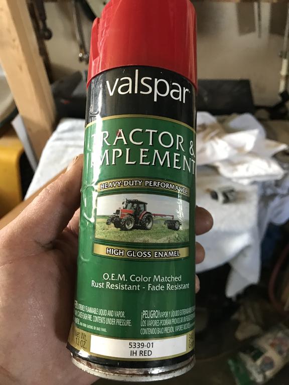

BPEisenhower 553 #8 Posted April 22, 2018 I've been hunting all day for Valspar Restoration IH Red and everyone I spoke to says it was discontinued 4 years ago 😢 So, it's either Rustoleum Sunrise Red or possibly go to Case IH dealer for paint. Is there a hardener for Rustoleum or is it compatible with Delthane/ Delstar? Share this post Link to post Share on other sites

PeacemakerJack 10,743 #10 Posted April 22, 2018 (edited) 13 hours ago, BPEisenhower said: I've been hunting all day for Valspar Restoration IH Red and everyone I spoke to says it was discontinued 4 years ago 😢 Here is what you are looking for... If you google ”Valspar 5339-01” you will find all kinds of it still available on line ranging from $6-$15. I have found it to be a really decent paint for spray bombs. I believe they also have this available in qts and pints if you prefer to “roll your own”. Other pro painters on here may disagree with me and I would respect their opinions more than mine. However, for the DIY guy, this is a really good product. Lowe’s was my go to for this product but I just got off the line with an idiot there who wasn’t willing to help me. He said, “We Don’t Have that on the shelf.” I said, “you ordered it for me in the past from your Valspar supplier by number.” He said, “Sorry sir, I can’t help you!” THANK YOU CAPTAIN OBVIOUS! So—hopefully this helps you in your search for some paint! I’m fairly confident that if you have a Lowe’s near you and a willing person at the paint counter that they can order you a case 6 cans from Valspar direct... Edited April 23, 2018 by PeacemakerJack 3 Share this post Link to post Share on other sites

Sarge 3,470 #12 Posted April 28, 2018 Not many truly good paints left out there in the consumer market - that later version of Valspar is not nearly as good in solids content as the original Restoration series, which is the problem with most brands you buy now whether in quarts or spray cans. If I'm out to get a really good paint job - it gets automotive grade single stage enamel. Otherwise, most all of the implement paints are almost worthless now except for maybe the Van Sickle, although I have yet to personally try it. There are hardeners still available, try hunting for an older automotive store that sells finishing supplies and the oldest guy behind the counter. Sarge Share this post Link to post Share on other sites
elliot ness 1,916 #13 Posted April 28, 2018 Banner Red from ace hardware stores works great and looks good. Share this post Link to post Share on other sites
