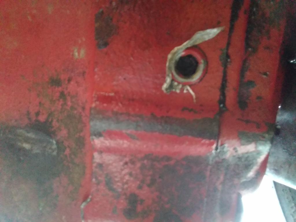

pfrederi 20,260 #26 Posted May 22, 2018 The drain is an allen hex. Usually packed with crud so it can be hard to fin. You will probably need to clean it out before using a 1/4 inch allen wrench. 1 1 Share this post Link to post Share on other sites

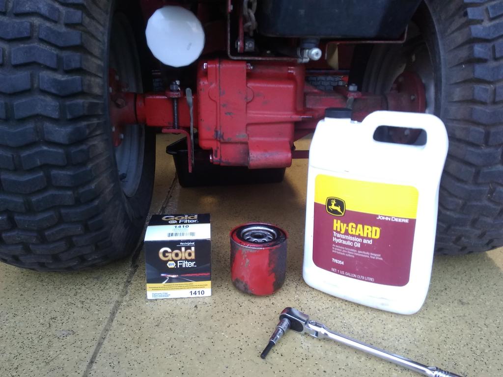

GREYGHOST 65 #27 Posted May 23, 2018 The Captain pulled me off yesterday. I was able to get A couple of hours with this Ol Girl today. I found the drain plug thanks to. According to what I found in the manual here on line said 5qts of 10W-40. In my pictures you can see what I chose to use. I'm a Green/Red guy. So I chose the Green brand after researching the JD TURFGUARD. I've been using it for many years and I've got gallons of it. But since my system wasn't totally empty I only added 3 1/2 gallons and it's overfilled. I'll correct that tomorrow. I flushed the crankcase then added 1 1/2 qts of 20W-50. The book says 30W, after talking with a local retired old time Troy Bolt & Wheel Horse Dealer. And reading and hearing horror stories about the Kohler Hand Grenade issue. I chose to use my Harley Davidson's oil. If that oil can survive and provide the protection in my Bike it should do fine in this Kohler. My next repair will be new plugs, & points &_Air filter. I did catch a fuel leak tonight under the air cleaner. It was a deteriorated fuel line. As I'm looking back and wondering why I chose this model & this particular tractor I'm just not sure? Share this post Link to post Share on other sites

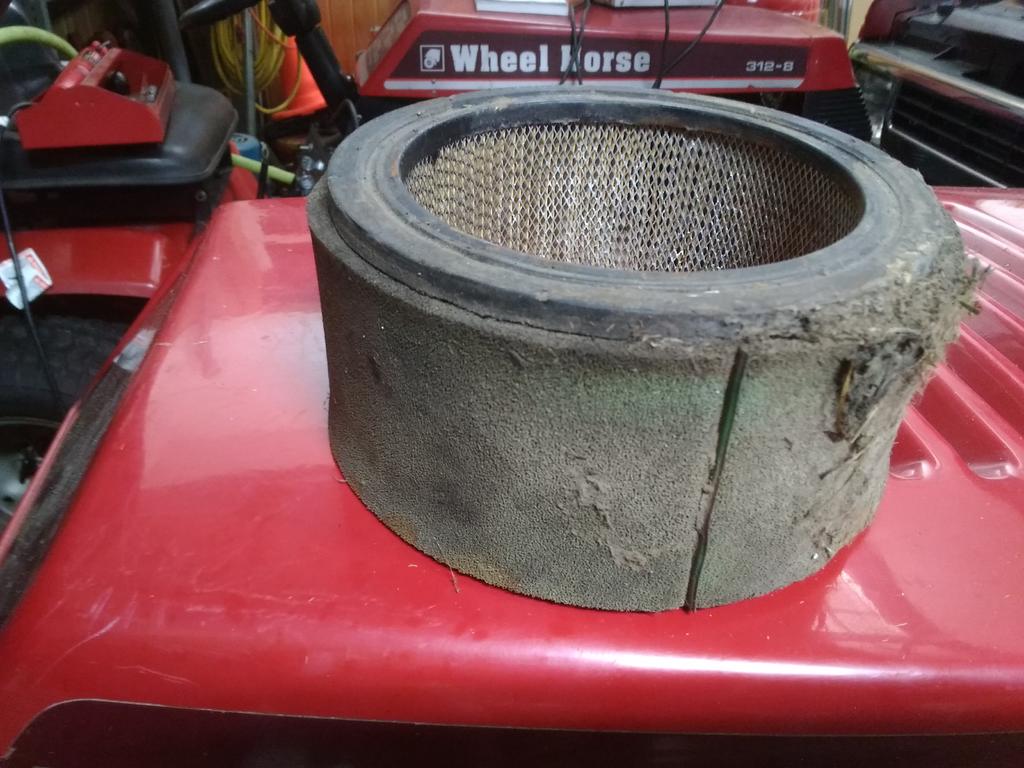

GREYGHOST 65 #28 Posted May 23, 2018 (edited) 320 hrs. Of VERY MAINTENANCE NEGLECTED HORSE. That should be a CRIME!!!! Edited May 23, 2018 by GREYGHOST Share this post Link to post Share on other sites
