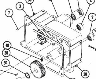

Daniel N 6 #1 Posted April 12, 2018 I just bought a 1970 GT 14 and I can't seem to find a drain plug. How do I drain it? Thanks for you help Share this post Link to post Share on other sites
gwest_ca-(File Mod) 11,718 #2 Posted April 12, 2018 The 1/4" NPT drain plug is item # 49 located in the left rear corner on the bottom of the case. The plug is flat with a hex hole for an Allen wrench. The hole may be full of dirt making it hard to find. Clean the hole out well and tap the Allen wrench in to make sure it bottoms in the hole so you don't strip the hex. Being a tapered pipe thread they require a thread sealer and don't need to be singing tight. Garry 3 Share this post Link to post Share on other sites
953 nut 62,113 #3 Posted April 12, 2018 Your GT-14 left the factory with Dextron ATF in the transaxle, but many were changed over to 10 W 30 later on. Either one is fine but they don't mix well so be sure you replace it with the same fluid as is presently in there. ATF is pink and 10 W 30 is amber. As can be seen in Garry's drawing there is a hump in the floor of the transaxle housing so it is best to jack up the front of the tractor to ensure complete draining. You should also replace the filter, it is a NAPA 1410 hydraulic oil filter, regular auto oil filters will not work. 3 Share this post Link to post Share on other sites
