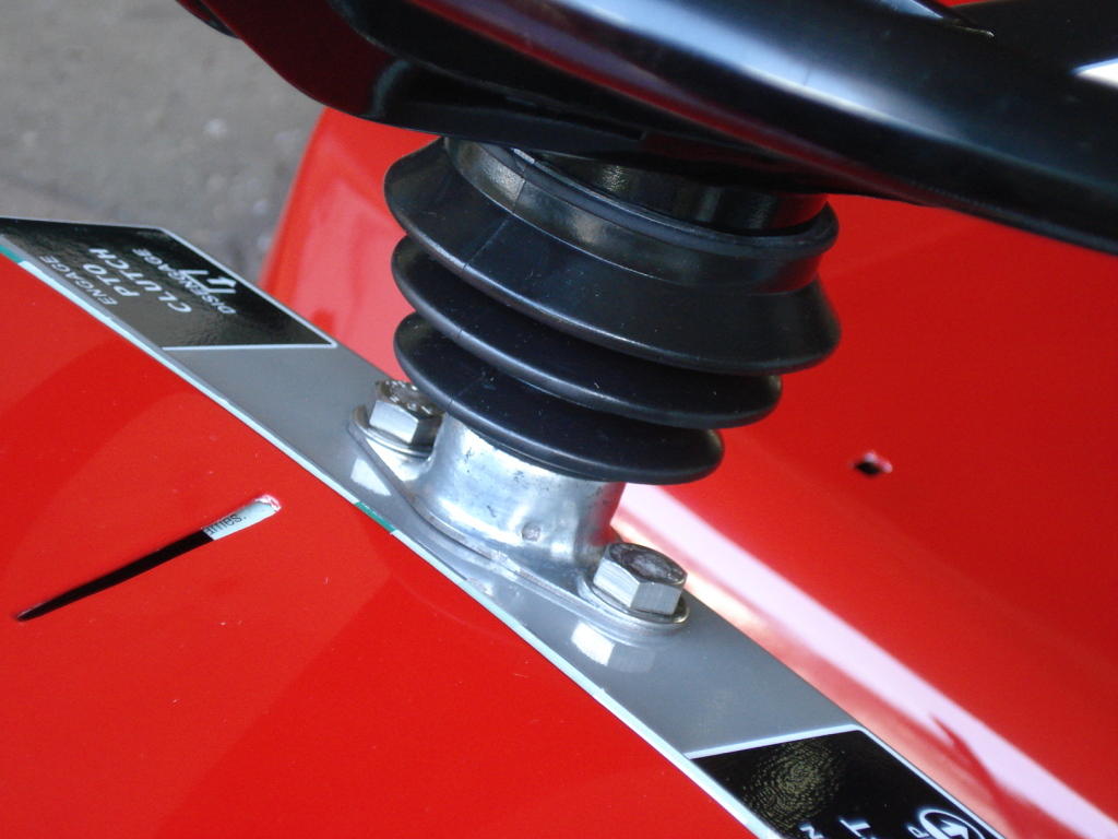

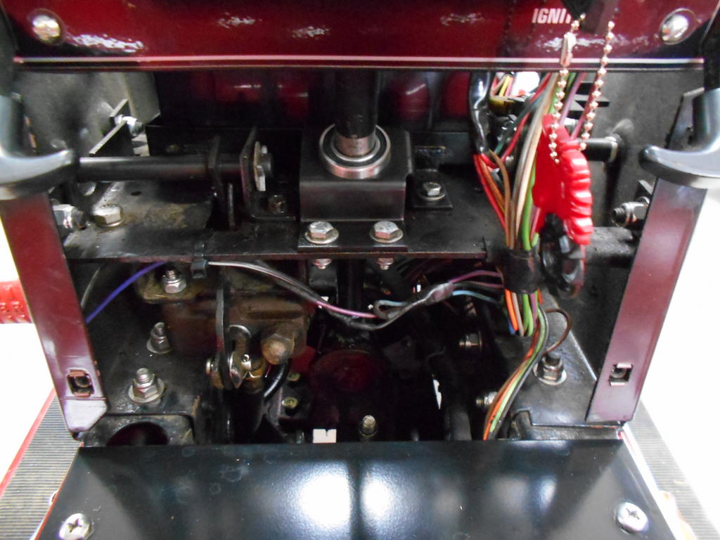

Eric Friedrichsen 112 #8 Posted April 12, 2018 A couple of years ago I restored a much abused 414/8 that had a similar problem (among many). I used a mounted sleeve bearing from McMaster Carr that I modified to accept an angled zerk and now it is part of my routine servicing. The inst. panel on the 400 series tractor is different then yours but yours looks easier to make this modification. I then fastened the steering shaft lock under the bearing. The result is a smooth shaft with no play in that location. See the attached picture. Eric 9 3 1 Share this post Link to post Share on other sites
mikeeyre74 290 #9 Posted April 12, 2018 That’s an interesting idea with that roller bearing there, but like you said, it’s a different arrangement. I don’t believe there’s enough room to mount anything with flanged wars on it like that... and since it’s just aluminum or some type of other alloy, it’s not going to be as strong as steel. It might be possible to use through bolts through the dashboard and use spacers under those flanges tho... the only drawback being some exposed bolt heads on the top side of the dashboard. Hmm. But the trade off might be worth it? I’ll consider that. Share this post Link to post Share on other sites
Eric Friedrichsen 112 #10 Posted April 12, 2018 Hi Mikeeyre74, It is a mounted sleeve bearing. A frictionless bearing is not needed as there is very little motion there. Could you mount it underneath with a steel support plate and only the bolt heads would project through on the top. The cover tube over the shaft (on the exterior I made from an old backpack blower tube. You could make one to cover the bearing or bolt heads. Good luck, Eric Share this post Link to post Share on other sites

Anglo Traction 761 #13 Posted April 12, 2018 Adding a better bushing to strengthen the Steering was quite straight forward when I refurbished my 74 C-120 several years ago. I used the same Flanged Bushing that is used on the lower forward Steering Shaft- There was enough space below for 3/8" UNC (SAE) nuts and lock washers. Solid as a rock. 5 Share this post Link to post Share on other sites

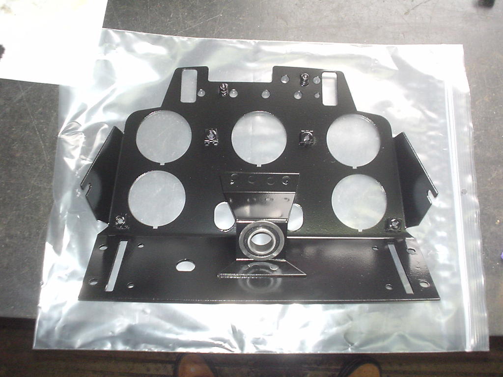

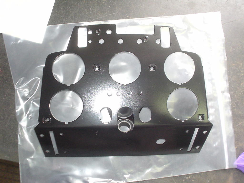

cleat 8,740 #14 Posted April 12, 2018 A ball bearing up there will reduce steering effort as well. I have upgraded all of my 520's that way with flanged wheel bearings (same as in the front wheels of the majority of Wheel Horse tractors with 3/4" spindles) and steering effort is reduced along with all play gone from the steering shaft. Hole is drilled to the proper OD of the bearing and it is pressed into place. This is for an early 520 that has the bearing in the battery support area. And this is for a later 520 that has the bearing in the dash. This may not work on yours but it is an idea. Cleat 3 Share this post Link to post Share on other sites
