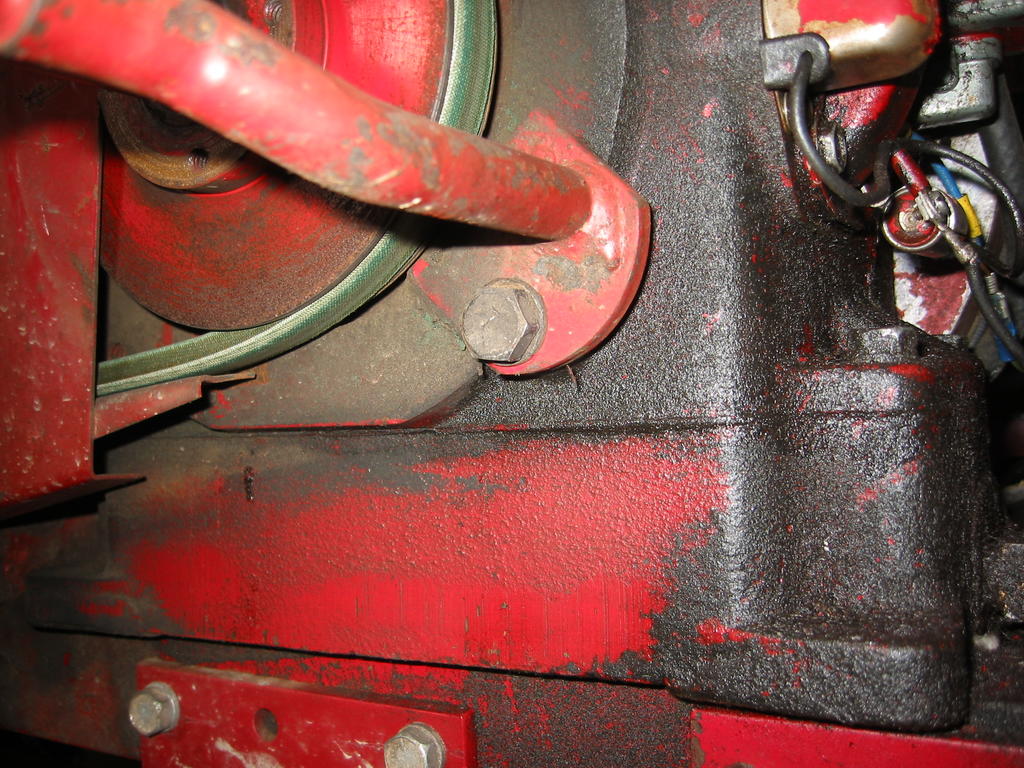

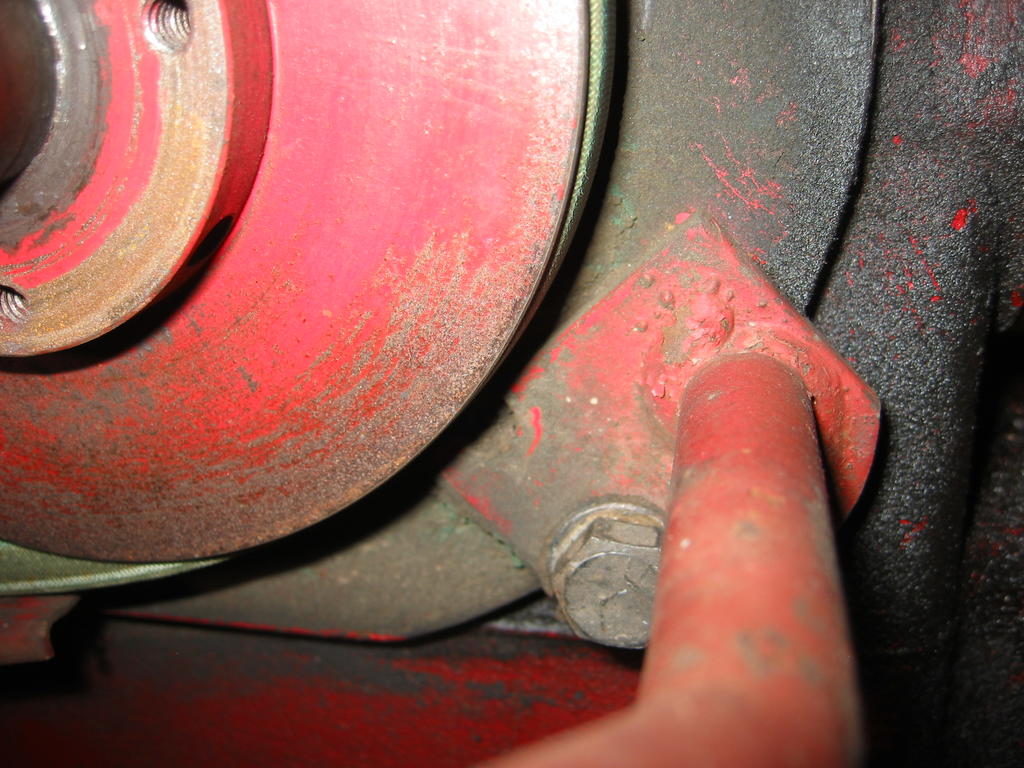

mikeeyre74 290 #1 Posted April 7, 2018 I’m trying to hook up the old style PTO, on a non-original engine. I can see how there is a large bolt hole and a small bolt hole next to each other on the engine block and clearly the post that holds the PTO lever on the block goes in the larger one, but there is a small half moon cut out on the mounting base for the post. Is something supposed to go there? It seems like it would interfere with the engine pulley? This is the bolthole I am concerned about. It seems odd that the post is held down by only one bolt, and not any other kind of locator or another bolt? Share this post Link to post Share on other sites
pfrederi 19,922 #2 Posted April 7, 2018 (edited) Only one bolt. There should be a roll pin Correction SET SCREW in the small hole in the block the notch on the PTO pushes against it Kind of hard to see in the second picture hidden by the pulley . Edited April 7, 2018 by pfrederi Share this post Link to post Share on other sites
mikeeyre74 290 #3 Posted April 8, 2018 Set screw? Ok, I'll have to round one of those up then, as it's missing here. Thanks! Share this post Link to post Share on other sites
pfrederi 19,922 #4 Posted April 8, 2018 (edited) I have never pulled one to see the length. You only want the amount sticking out to be no more than the thickness of the PTO Plate. Edited April 8, 2018 by pfrederi Share this post Link to post Share on other sites
