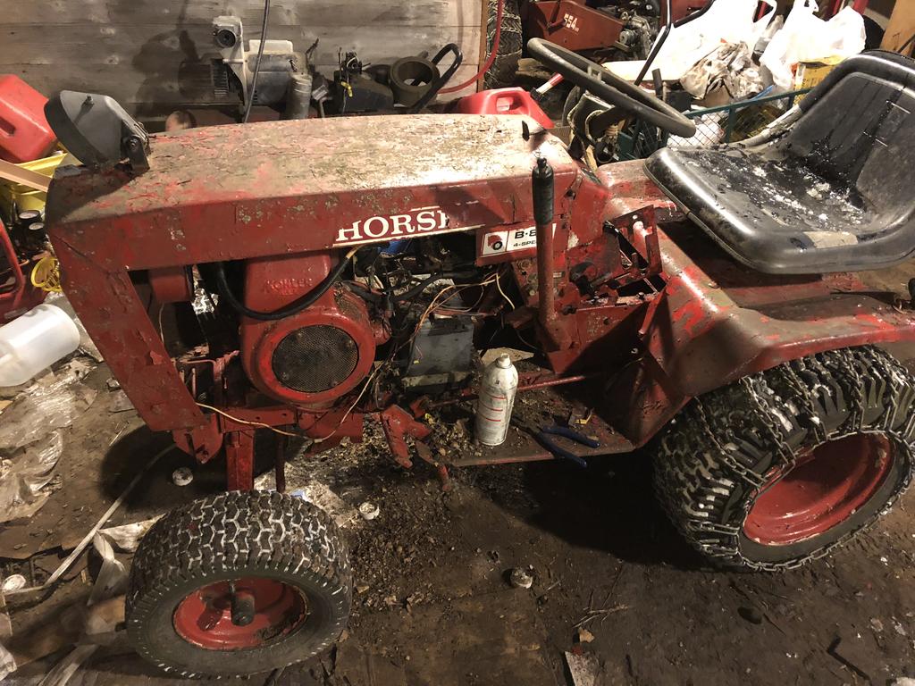

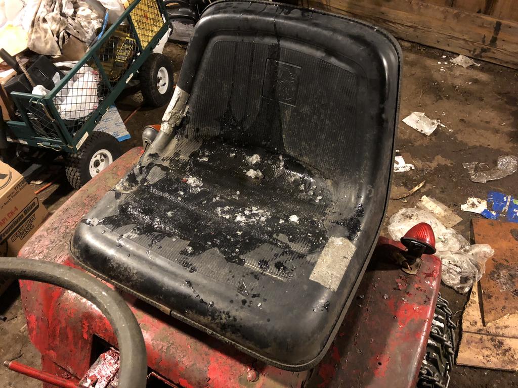

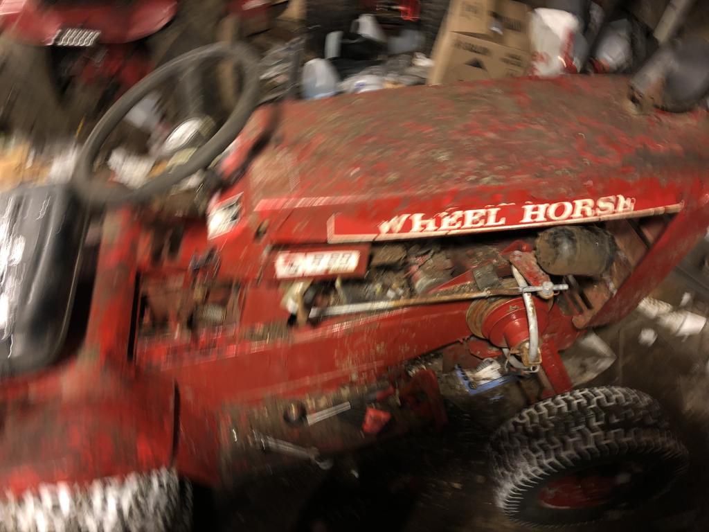

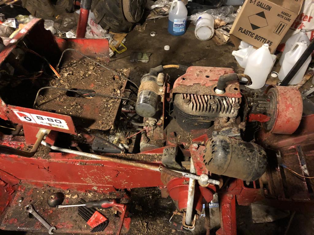

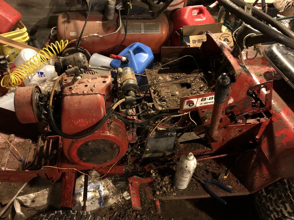

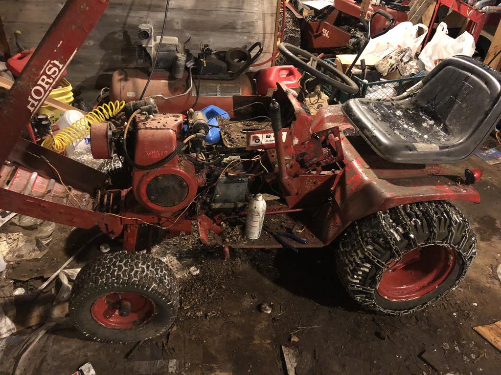

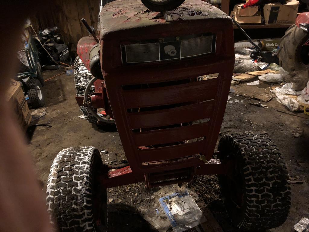

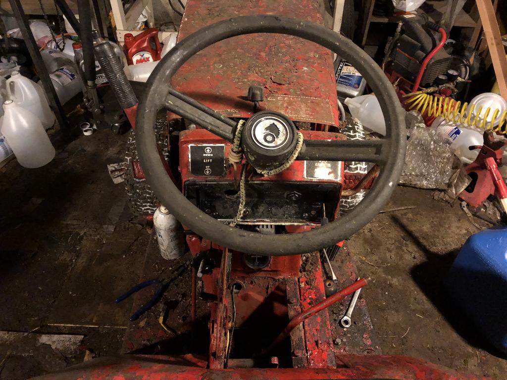

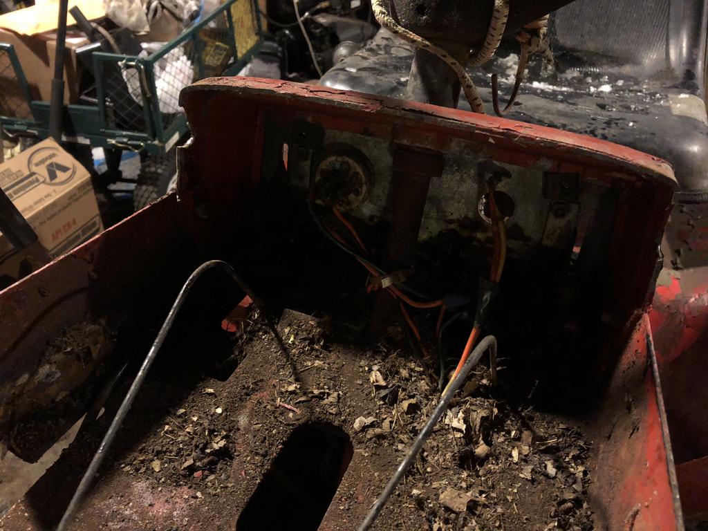

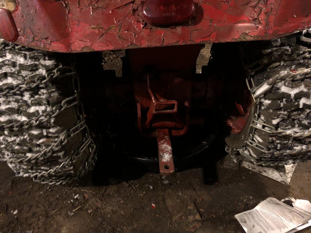

Deadguy 864 #1 Posted April 7, 2018 As some of you are aware, a few weeks ago I picked up a couple of basket case 8hp Horses, a B80 and a 8hp 4 speed. Now that the 8hp 4 speed is running well, I figured it was time to look at the B80. I got it into my workshop and started the initial exam. Everything is covered in peeling red barn paint. All the control cables are rust frozen. The fuel line is dry rotted. The transmission is lubricated with ice. The wiring is...questionable. The engine is not seized. The metal is mostly straight, though there is some rust. Tonight I managed to do the initial exam, loosen up the throttle cable and governor linkage, remove the fuel tank, and remove a critter nest from behind the dash. So far I see nothing but...potential? 8 7 Share this post Link to post Share on other sites

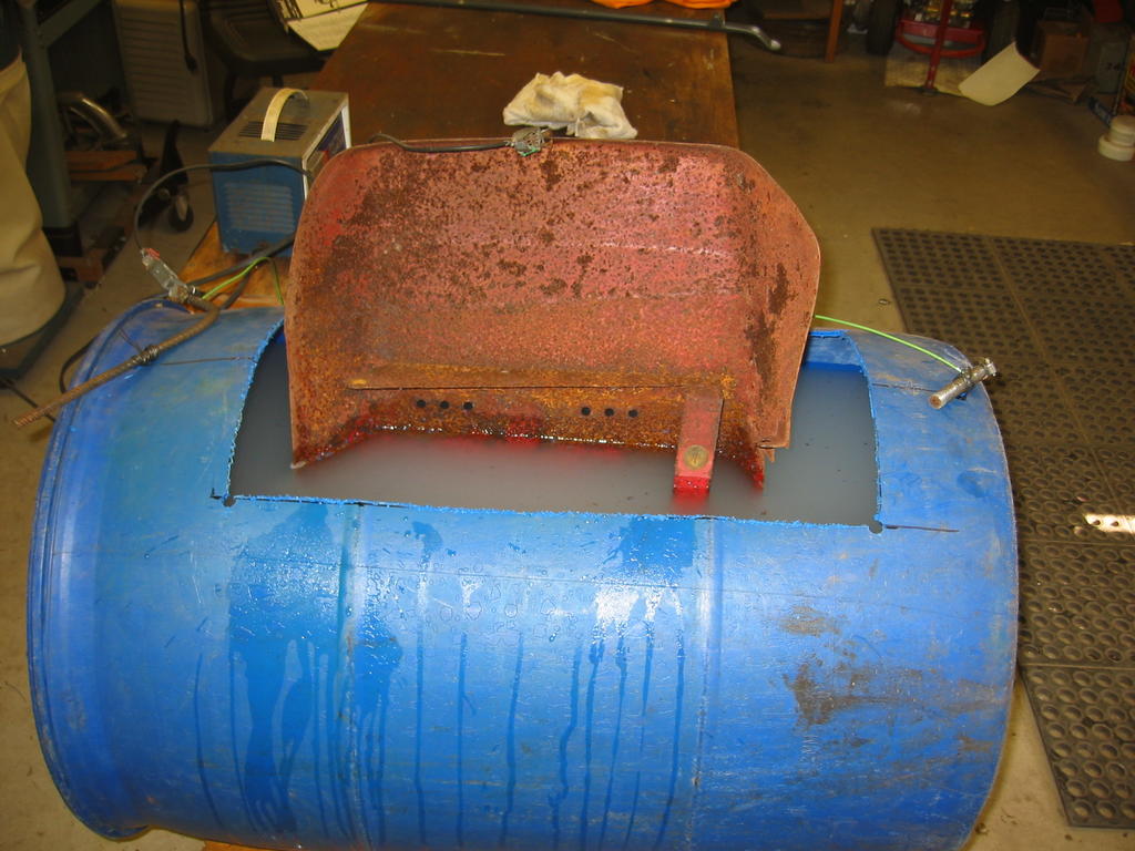

ohiofarmer 3,383 #10 Posted April 7, 2018 That will buff out. Or, you can do it all with very little elbow grease. paint like that will come off in the electrolysis tank. It will take a few days, but the dividend is not removing any metal that is not rusted. The rust even comes out of the pitted areas and they can be filled successfully. On a job like the hood, you need big fat annodes. Maybe 2 inch angle iron or fence posts...Plenty of wait time, but not a lot of work If you decide to use just abrasion, these little beauties work pretty well so long as it is a larger flat area. A bolt sticking out will tear them up.https://www.harborfreight.com/4-1-2-half-inch-nylon-abrasive-wheel-94017.html Share this post Link to post Share on other sites

pfrederi 19,917 #12 Posted April 7, 2018 I use junked disc brake rotors and weld an old bolt on them to hang them at the ends of the barrel . 4 2 Share this post Link to post Share on other sites
ohiofarmer 3,383 #13 Posted April 8, 2018 8 hours ago, Deadguy said: This electrolysis doodad sounds interesting.... Yep. The main thing to remember is to keep wire brushing the annodes morning and evening at the minimum to keep the rust flying off the part you want to clean. A manual battery charger is better than one of the new electronic ones as well. pfrederi has a great setup with the big surface area a brake drum provides Share this post Link to post Share on other sites

DennisThornton 4,773 #16 Posted April 8, 2018 On 4/7/2018 at 1:51 PM, pfrederi said: I use junked disc brake rotors and weld an old bolt on them to hang them at the ends of the barrel . Never thought about cutting a barrel that way! Nice! 1 Share this post Link to post Share on other sites
pfrederi 19,917 #17 Posted April 8, 2018 1 minute ago, DennisThornton said: Never thought about cutting a barrel that way! Nice! I have it on a heavy duty movers dolly so i can move it around. (slowly to avoid sloshing) Takes two passes to do fenders and hoods wish I had something bigger. 1 Share this post Link to post Share on other sites

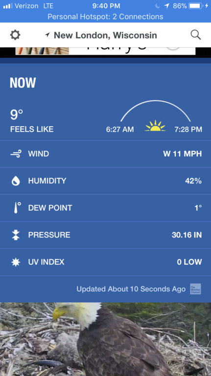

Deadguy 864 #18 Posted April 8, 2018 6 hours ago, RandyLittrell said: To the man working on a dirt floor and ice still on the tractor. I was raised to make do, but you are one hardy soul!! I am a wimp, I gotta have a concrete floor and heat now that I am older. Hats off to ya brother!! Randy Right now there is ice on everything, the overnight lows are still dropping into the single digits. And to think that one year ago on this day, the ground was already thawed, i was plowing the garden, and it was in the 60’s outside! 2 Share this post Link to post Share on other sites
DennisThornton 4,773 #19 Posted April 8, 2018 35 minutes ago, pfrederi said: I have it on a heavy duty movers dolly so i can move it around. (slowly to avoid sloshing) Takes two passes to do fenders and hoods wish I had something bigger. I have 2 or 3 275 gal oil tanks that I intend to use. One for a sandblaster, another for a molasses rust removal tank and if I'm careful for an electrolysis tank. But, BIG tanks take LOTS of liquids. Not so bad on the electrolysis side but more so on the molasses side. Or other chelating chemicals A wooden frame and some heavy poly (with some protection!) might better suit your needs if your barrel is not big enough. 3 Share this post Link to post Share on other sites

ebinmaine 77,374 #21 Posted April 8, 2018 2 hours ago, pfrederi said: .......Takes two passes to do fenders and hoods wish I had something bigger. Measure the minimum size you need and get a box store storage tote a bit bigger. Share this post Link to post Share on other sites
