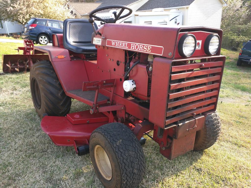

dennyandcarrie 9 #1 Posted April 6, 2018 I had a question about a statement I made in a for sale post and it was requested that I explain what I meant by saying the tractor had a "Turning Brake Kit". If you look at the picture below you can see the two pedals that allow you to break each wheel independently of each other. This is a feature that is on larger tractors so that if you have one wheel start to loose traction you can apply the break to the spinning wheel to get traction to the other wheel. I have the original price list for the tractor which shows what the gentleman that purchased it chose for his options and they had it listed as "Turning Brake Kit". I guess they called it that since if you applied the brake to one side it could help you to turn more quickly. 2 2 Share this post Link to post Share on other sites

pfrederi 19,920 #4 Posted April 6, 2018 It was "Standard" on D200 optional on other Ds Share this post Link to post Share on other sites
