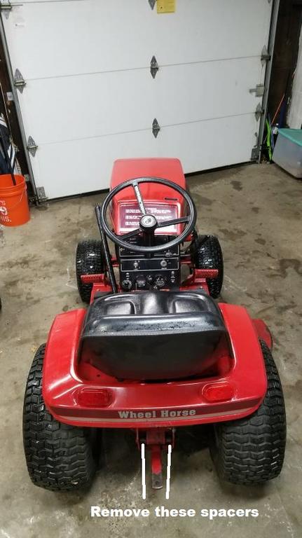

cpic1 0 #1 Posted April 6, 2018 I have a 417-A. Can I use any slot clevis hitch or are they different? Share this post Link to post Share on other sites
Tankman 3,523 #2 Posted April 6, 2018 (edited) I believe you can. Let's see what the Jockey's say. Betting they agree. Haven't used one in years but, welded flatbar to many implements to fit the slot hitch. Here's the slot hitch adaptor. the vendor has more. https://www.ebay.com/itm/Toro-Wheel-Horse-Slot-Hitch-Adapter/222900779564?epid=941808571&hash=item33e5ebfa2c:g:ZNkAAOSwNgxWDI~H Edited April 6, 2018 by Tankman Share this post Link to post Share on other sites
wallfish 18,221 #3 Posted April 6, 2018 (edited) Any Wheel Horse slot hitch will fit. It attaches to the 3/4" pin where the spacers are now for the draw bar. Edited April 6, 2018 by wallfish Share this post Link to post Share on other sites
Ed Kennell 42,130 #4 Posted April 6, 2018 Here we go, Wheel Horse slot hitch or Brinley style clevis hitch. 1 Share this post Link to post Share on other sites
SylvanLakeWH 28,567 #5 Posted April 6, 2018 24 minutes ago, Ed Kennell said: Here we go, Wheel Horse slot hitch or Brinley style clevis hitch. Isn't the answer yes" to both? Curious... Share this post Link to post Share on other sites
Ed Kennell 42,130 #6 Posted April 6, 2018 Yes, they both fit like John said by removing the spacers. There was a long debate some time back about the nomenclature of the two different style hitches. 2 Share this post Link to post Share on other sites
