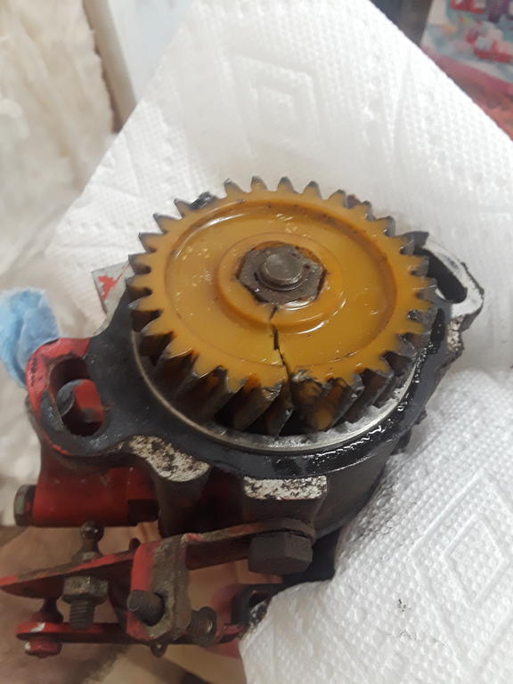

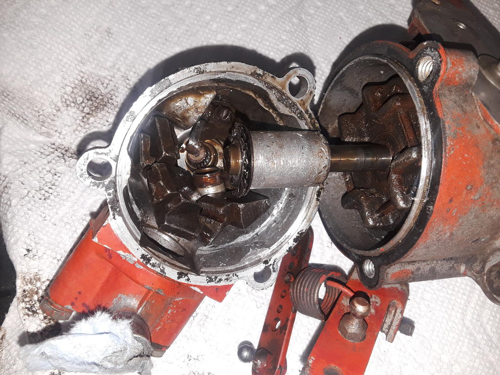

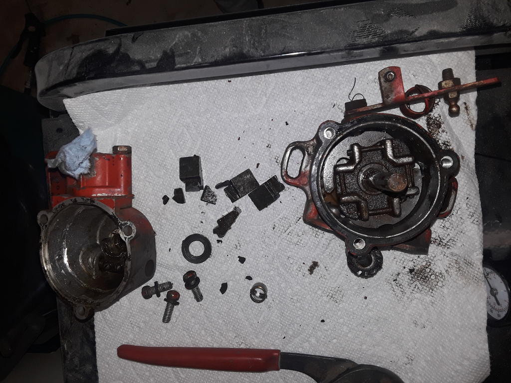

giantsean 59 #11 Posted April 8, 2018 I don't know about you guys.. but I am beginning to suspect that perhaps this governor assembly might not be operating within design specification. I've been wrong before though... Share this post Link to post Share on other sites
Sarge 3,470 #12 Posted April 8, 2018 Yeah - I'd say that's not within the original parameters of how it was designed to function, lol...looks like it exploded. Amazing it ran at all prior, that's a lot of damage. Sarge Share this post Link to post Share on other sites
giantsean 59 #13 Posted April 8, 2018 Yep... and ironically after dumping out all the mangled guts, the points pushrod is very clearly and visibly working . I even pulled out the dial indicator and found .0005 movement at best, so pulling it off was the next obvious step. It does make some sense now: - Last fall - Engine under load, hear loud pop/bang, engine stumbles but keeps running at a lower RPM. I HAD been working it pretty hard. - Overheating, smokeshow, hard starting. Limp it back to garage - One more test start before winter - pass - Jump to winter and I try to move it.. will not start at all - for a while it seems like it wants to (one or two detonations) - Test a couple months later, results as posted in this thread I am guessing what happened is the bang was the unit shredding, the rest from loss of advance. The variable start from crud jamming up the mechanism, perhaps getting worse over time due to settling, until the pushrod would no longer actuate. I will change the oil (hopefully my testing did not distribute too many metal particles) and rebuild the carb anyway, but for now it seems the mystery is solved. I sourced a used governor from the Bay for 75 bucks, and I will keep whatever parts of mine survived for later. Might be worth picking up one more spare just in case, and a new set of points to boot. Sincere thanks for everyone's help! On my way to becoming the K-series governor guru! 1 Share this post Link to post Share on other sites
