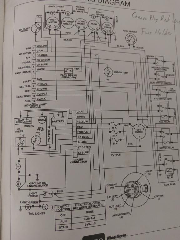

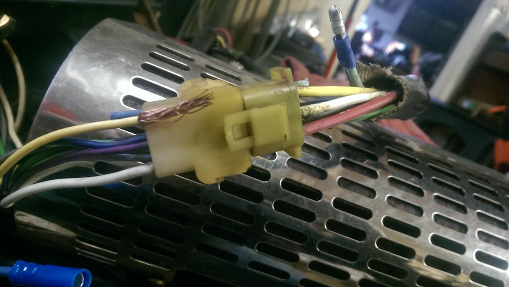

cleat 8,715 #18 Posted April 3, 2018 6 hours ago, TC10284 said: I'll do a compression test as soon as possible, along with checking the plug, wire, and coil. What would you guys suggest about the wires connected with wire nuts? Mostly that one that has four wires in one wire nut - two reds, two whites. Is that not an issue? Here is the wiring diagram. Later model 520 wire diagram.pdf It looks like they removed the PTO safety switches and also the seat switch. If you follow the wiring diagram and see which wires are supposed to connect then you can determine if yours is now wired properly. You do not have many if any safety switches currently functional. Cleat Share this post Link to post Share on other sites
Steve_O 25 #19 Posted April 3, 2018 6 hours ago, TC10284 said: Mostly that one that has four wires in one wire nut - two reds, two whites. Is that not an issue? this is where the fuse block used to be (part# 67-7160). I'd replace the fuse block. 1 Share this post Link to post Share on other sites

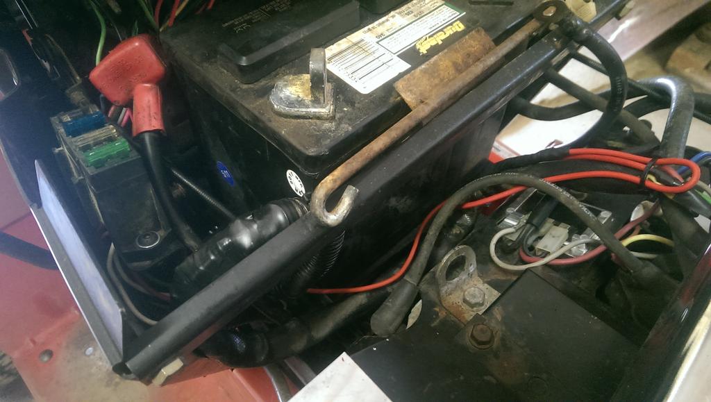

WVHillbilly520H 10,377 #20 Posted April 3, 2018 11 hours ago, TC10284 said: So I did a little testing today after work. It took forever to get it started, BTW. First, I took the fuel hose off the carb to see if the fuel pump was pumping. It was, although it wasn't a steady stream. I guess because I was only turning it over and the engine wasn't running. Attached are some pictures I took of the wiring. Note that I did NOT do any of that. If it were me, and it were possible, I would have soldered them back together and used heatshrink tubing. See if you notice any issues here: https://imgur.com/a/5f7yS OK first on the fuel pump it's a "pulse" style pump there for it only "squirts" fuel on a vacuum pulse faster as the rpms pick up, second the wire nutted wiring is where the fuse panel used to be (not good) also looks like the main charging wire is burnt and corroded (the 12-14 ga wire running by the battery) you need to download the demystification guide from here for your model (IE 73501/2) 520H for the wiring diagrams and trouble shooting also the Onan engine service manual will help too, I suggest going through and checking ALL the wiring/connections for corrosion/breaks ect especially the 9 pin plastic connector between engine and the rest of the dash wiring, here's a few pics of how it could/should look after cleaning up the harness, BTW looks like it could use a good thorough cleaning front to back, take the rear fender pan off I suspect major dirt/grease build up on the hydro pump/fins, as well as good time to change out the fuel lines and maybe the fuel shut off on the tank, Jeff. 1 Share this post Link to post Share on other sites
TC10284 113 #21 Posted April 3, 2018 (edited) To all that replied: So it looks like I not only have an engine problem, but a wiring problem to resolve. The person I bought it from said "it ran fine" (it had a 48" deck) just "shook sometimes". OK, I will order a new fuse box (67-7160) and see if I can get that rebuilt. It might be a challenge for me, so I may have to come back for advice. As far as the safety switches, the only ones I'm concerned about I guess would be the PTO safety - just in case for whatever reason if I fell out of the seat while mowing, even though I don't have anywhere near rough terrain at my house. I get the point of it though. Also an oil level safety or temp safety switch, if that's even a feature in the first place. Can you tell if those have been removed or what to look for, if applicable? I'll also check all the wiring and connections for corrosion, etc. Edited April 3, 2018 by TC10284 Share this post Link to post Share on other sites

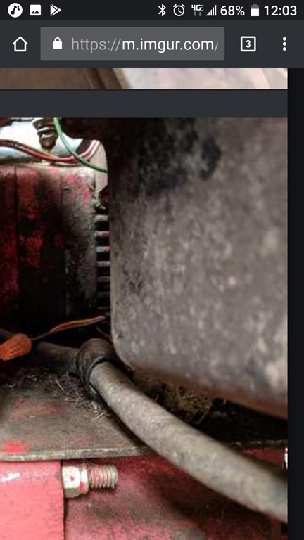

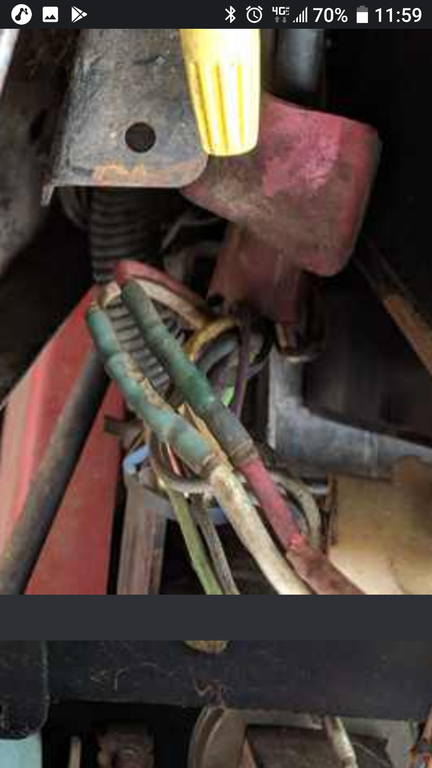

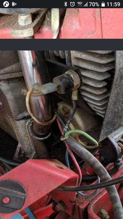

TC10284 113 #22 Posted April 3, 2018 5 hours ago, WVHillbilly520H said: also looks like the main charging wire is burnt and corroded (the 12-14 ga wire running by the battery) I'm not seeing what you're seeing. Sorry. I'll go look closer after work. Share this post Link to post Share on other sites
WVHillbilly520H 10,377 #23 Posted April 3, 2018 9 minutes ago, TC10284 said: I'm not seeing what you're seeing. Sorry. I'll go look closer after work. This first pic white and red wires...and as far as I can tell your engine temp sensor is still hooked up second pic of yours...there's also a hydro(trans temp sensor as well) and again your pic look at the build up (grass/oil) under the fuel tank I just used a pic of mine as reference and it just had 236 hrs on it when it got it little to no maintaince, Jeff 1 Share this post Link to post Share on other sites
