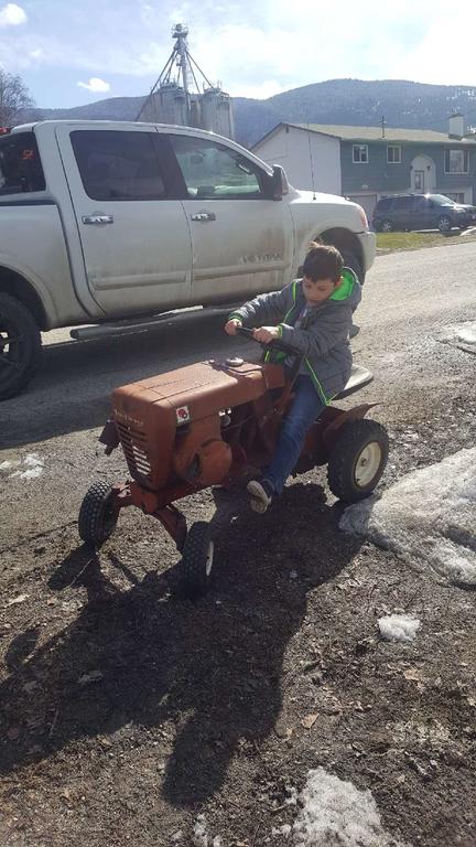

Lambeater 14 #1 Posted April 1, 2018 Good morning guys, I just purchased a 33R in great shape which my grandson can drive. The only thing that is in not great shape are the wheels. I would like to put the next size up on and make it look more like a tractor with ribs on the front and lugs on rear. Not sure what rims would fit and which tires to get. At present it has 3.50-4 front and 4.00-8 rear. Any help would be appreciated. thx Darryn 3 Share this post Link to post Share on other sites

Lambeater 14 #8 Posted April 1, 2018 Thanks Terry found the front tires no problem. I think the backs look like Carlisle 4.80-8 power tracs Lambeater 1 Share this post Link to post Share on other sites

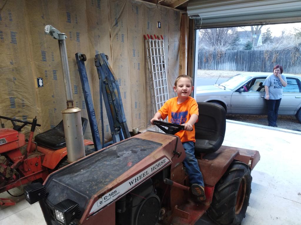

ClassicTractorProfessor 5,371 #16 Posted April 5, 2018 I've been looking for a Lawn Ranger for my nephew for a while now, he loves my C125 but it's a bit too big for him yet 1 Share this post Link to post Share on other sites

RandyLittrell 3,906 #18 Posted April 6, 2018 I too would like to have one for my grandson, I wish they made a hydro in the lawn ranger series but I don't think they did. Randy Share this post Link to post Share on other sites
