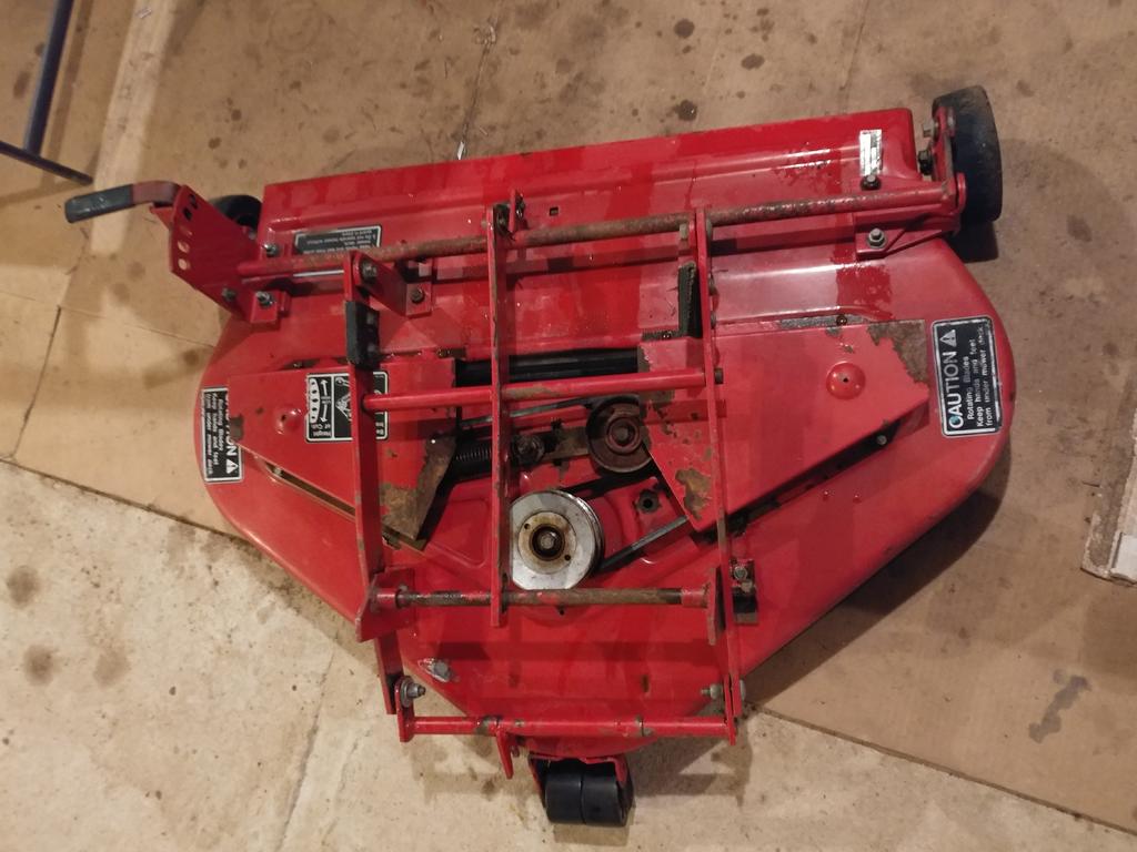

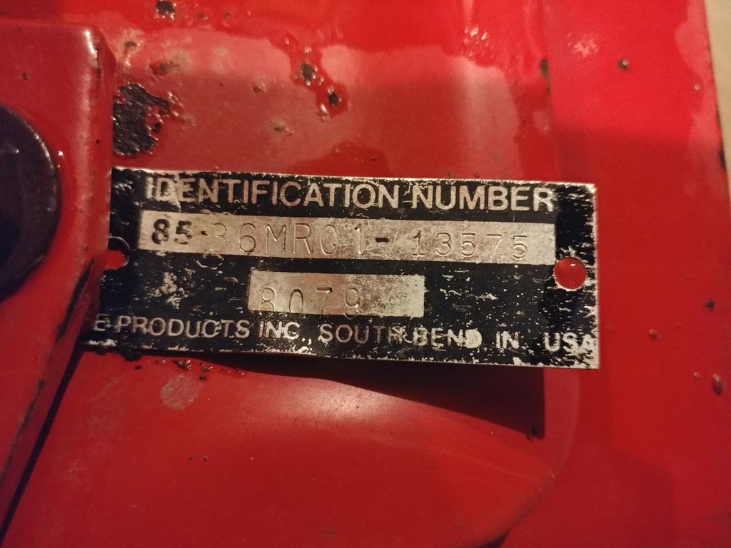

Joshn569 273 #1 Posted March 30, 2018 Im getting ready to go through my deck. Is there anything I need to look out for besides the obvious stuff? And Replace the blades or can they just be sharpend? I took a pic of tag, any info on how to decode it is much appreciated. Share this post Link to post Share on other sites
varosd 1,185 #2 Posted March 30, 2018 obviously, re bend back the height adjuster and it looks like the main lift bar looks a bit bent too. I love my 36 RD deck, I feel it was the best cutting deck. typical rust /rot areas where they put baffles in on some of the RD decks. clippings would collect in there and rot out the deck lift bolts. How is the underside? Share this post Link to post Share on other sites

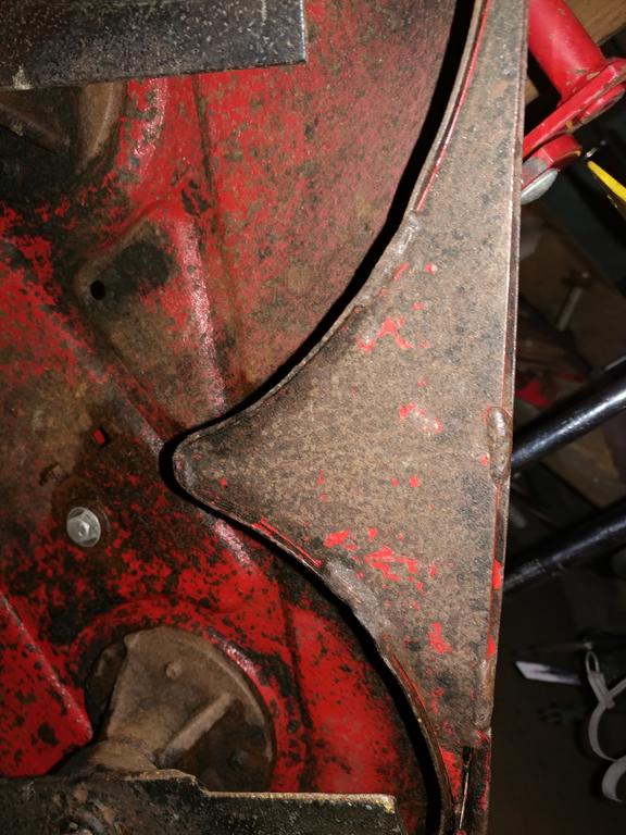

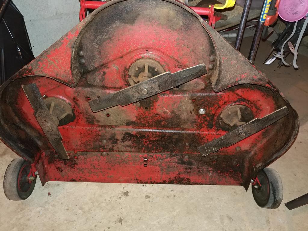

Joshn569 273 #5 Posted March 31, 2018 45 minutes ago, varosd said: obviously, re bend back the height adjuster and it looks like the main lift bar looks a bit bent too. I love my 36 RD deck, I feel it was the best cutting deck. typical rust /rot areas where they put baffles in on some of the RD decks. clippings would collect in there and rot out the deck lift bolts. How is the underside? To me it looks to be in good shape, no major rust or rot 4 Share this post Link to post Share on other sites
varosd 1,185 #6 Posted March 31, 2018 looks good. but dig into the slots for baffles. original paint? they had some baffles on some other different decks over the years. i guess they tried to improved mulching? the problem came with clippings collecting in the dead space of the baffles. 1 Share this post Link to post Share on other sites
608KEB 796 #7 Posted March 31, 2018 I cut triangle shaped holes into the flat steel on the underside that's used to reinforce the deck. It makes it easy to clean out. Also prevents moisture from building up and rusting out the deck. Share this post Link to post Share on other sites
peter lena 9,308 #8 Posted March 31, 2018 have my original 36 rd from 1982, regular service is the key . drilled one 1, 1/8 " holes in the reinforcement triangle , both sides for clean out and oil soak down. regularly ( lubriplate cable and chain spray ) it down to feed the metal and stop rust. twice a year oil down / clean bottom side of deck, leave it upside down in sun , to heat up and dry out, ( just the opposet of the life it lives ) . also do this at end of season , so oil can soak into metal upside down over winter, deck looks fresh and no rust. ( what a concept ). I like royal purple grease in my spindles, smoother faster running, also for my pto needle bearing, that deck and drive just runs without effort. replace wheels , home depot has them for 7 $ each, solid poly with steel axel hole, grease able . sorry don't have the link on that, easy to track. replace blades as needed , Kevlar belts, d&d internet. the deck looks good and savable, don't let it die , the metal looks starved for lubrication to me , save it while you can . pete 1 Share this post Link to post Share on other sites
