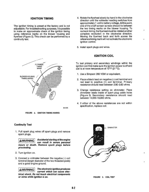

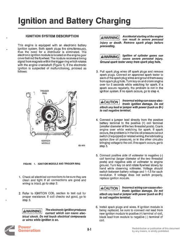

onanparts.com 185 #3 Posted March 26, 2018 Here is the coil and module testing info. New coil if needed is under $100.00 Ignitiontest.pdf CoilTest.pdf 2 Share this post Link to post Share on other sites
