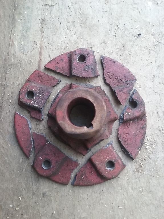

wallfish 19,332 #16 Posted March 26, 2018 (edited) 57 minutes ago, ebinmaine said: Is your hammer OK? Are you now making Wheel Horse puzzles? That now looks like the weaker hub, you proved your point! Looks like you were aggravated getting it off and said "I'll just smash this %#$^%*& thing with a hammer" Edited March 26, 2018 by wallfish 3 Share this post Link to post Share on other sites
ebinmaine 77,382 #17 Posted March 27, 2018 1 hour ago, wallfish said: Is your hammer OK? Are you now making Wheel Horse puzzles? That now looks like the weaker hub, you proved your point! Looks like you were aggravated getting it off and said "I'll just smash this %#$^%*& thing with a hammer" Yes the hammer is fine. It didn't even get a good workout. I was using an Estwing contractor grade 28 oz. Framing hammer. I Don't mess around during destruction processes! I like the idea of the puzzle or wall art !! "Looks like you were aggravated getting it..." OK now for the record... I DO occasionally experience these types of short bouts with irritation (RARE to be honest).... hehehehe.... but in this case I was legitimately curious.. ".....said "I'll just smash this %#$^%*& thing with a hammer" THAT part is TRUE. Oh I do SO love busting up stuff !!!! 1 Share this post Link to post Share on other sites
