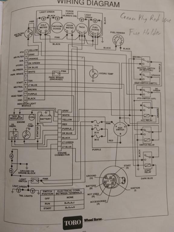

Walhonding520 25 #1 Posted March 24, 2018 I know this is a dumb one but I can’t find an answer by searching, so I apologize in advance. Should my 520 keep running with the parking brake on? Share this post Link to post Share on other sites
c-series don 10,525 #2 Posted March 24, 2018 I don't have a 520 but all my Wheel Horses run with the parking brake on. Share this post Link to post Share on other sites
rmaynard 16,552 #3 Posted March 24, 2018 (edited) Go to the file section, look for a file called "demystification guide for 1985-2001", search for your model/year, then find the "spark (ignition)" circuit. If there is a parking brake switch in the circuit, you will see it and your question should be answered. Edited March 24, 2018 by rmaynard 1 Share this post Link to post Share on other sites
Ed Kennell 43,016 #4 Posted March 24, 2018 Mine runs with the brake on and off. If yours stops when you push the brake, I would think there is a short to ground in the switch. 2 Share this post Link to post Share on other sites
WVHillbilly520H 10,376 #5 Posted March 24, 2018 On my '95 the column shifter doesn't always return to neutral and when setting the parking brake the engine will stutter/shut off if I don't physically make sure it's in neutral so it could be you're issue just another safety switch, Jeff. 1 Share this post Link to post Share on other sites
KC9KAS 4,744 #6 Posted March 24, 2018 Mine stays running, unless the motion control lever isn't in the "exact" neutral spot to trigger the neutral switch. 1 Share this post Link to post Share on other sites
Walhonding520 25 #7 Posted March 25, 2018 That might be the issue then with the motion lever. I thought I should be able to set the brake and get off with it still running. Share this post Link to post Share on other sites
AMC RULES 37,231 #8 Posted March 25, 2018 Don't you have to be in the seat... for your tractor to stay running? Share this post Link to post Share on other sites
WVHillbilly520H 10,376 #9 Posted March 25, 2018 With my '95 I have the seat switch disabled for mowing ditches so I can lean more to one side, but on the anniversary after its started and running as long as the motion control lever is in neutral with the brake set it will stay running is long as the PTO isn't engaged all 3 work in unison, seat/motion/pto along with the parking brake... 2 Share this post Link to post Share on other sites
