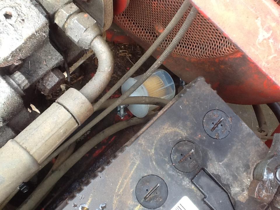

chris sutton 610 #6 Posted March 22, 2018 50 minutes ago, 953 nut said: If you have been running ethanol gas there is probably crud building up in the fuel system. After rebuilding the carb you should replace the fuel line and filter and run some Seafoam too. Ive cleaned the fuel tank and replaced all the fuel lines and filter 1 Share this post Link to post Share on other sites

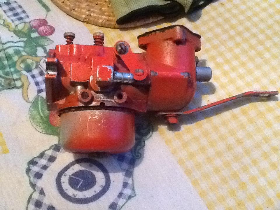

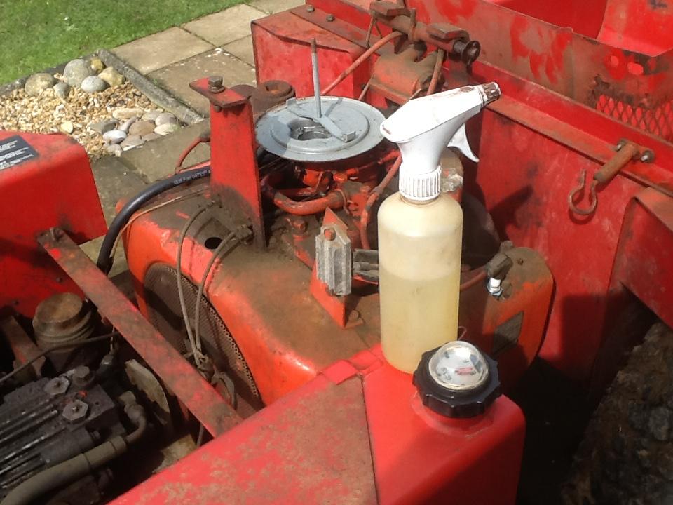

chris sutton 610 #10 Posted March 23, 2018 Just had another look this morning, first thing i did was to turn the fuel tap off. It started straight away and ran sweet on the fuel that was in the system and as it started to miss i gave it a swirt of fuel with a bottle and it plcked up and ran on both cylinders. I then turned the tap on and it started to miss with black smoke from the exhaust untill it chocked and stopped, then it wouldn't start. Next job is to remove the carb and have a look at the needle valve, it must be jammed open and dumping loads of fuel in the engine 2 Share this post Link to post Share on other sites

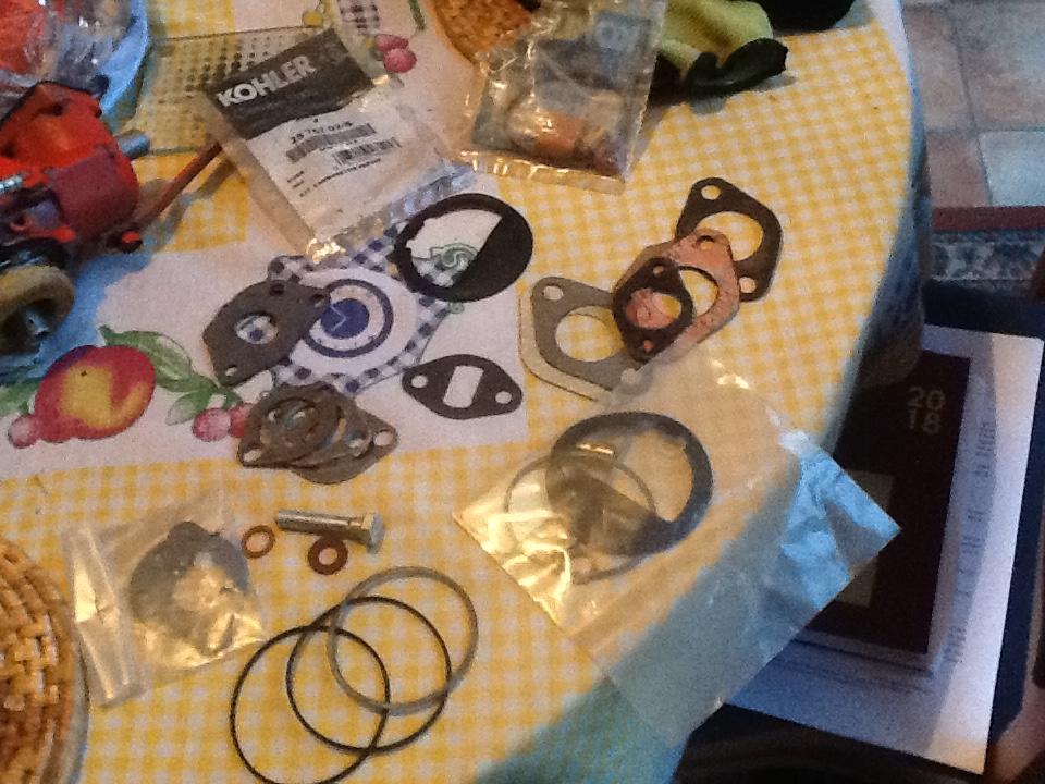

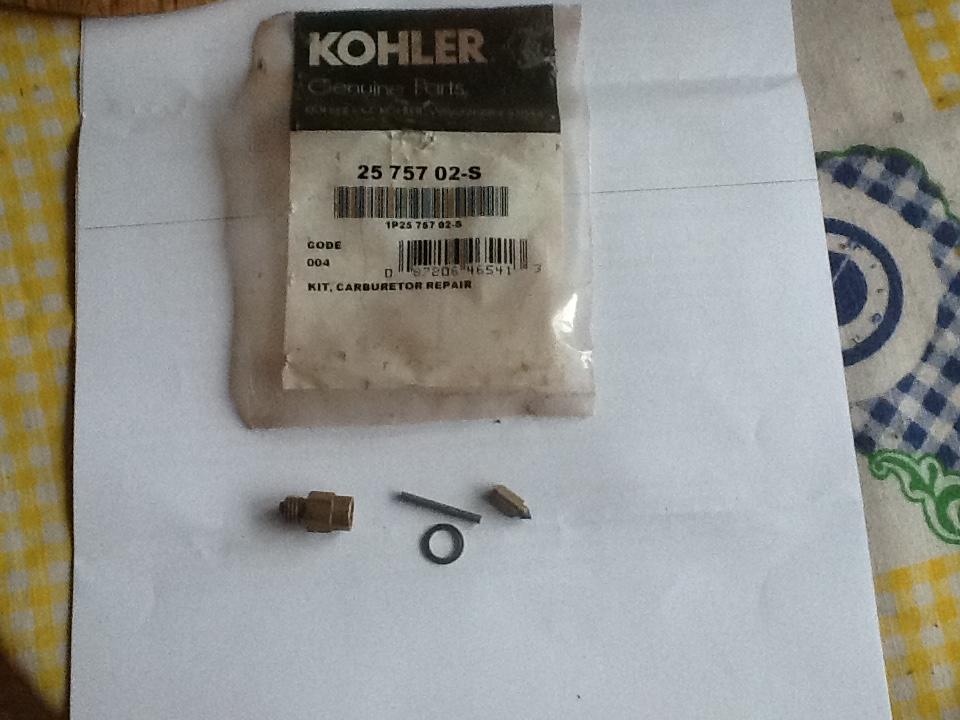

chris sutton 610 #12 Posted March 23, 2018 Had a look in my box of carb parts and found a new needle and seat and the gaskits. All back together now and ready to fit in the morning 3 Share this post Link to post Share on other sites

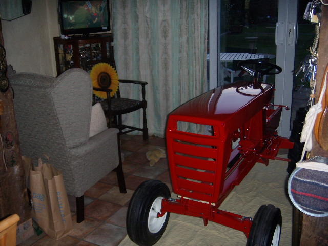

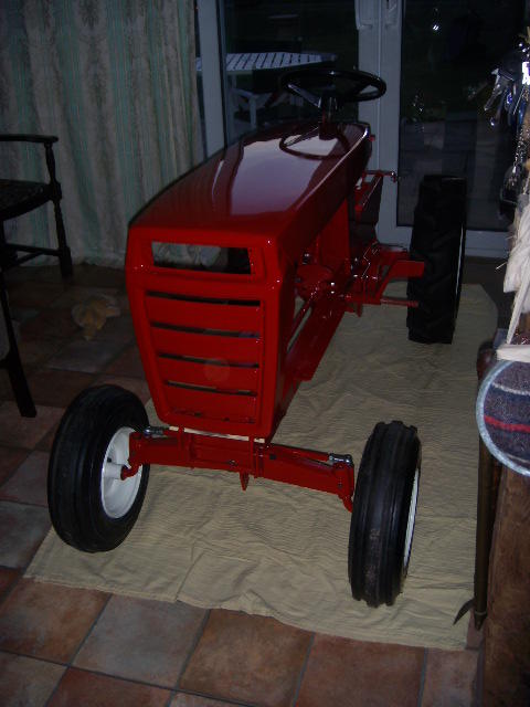

squonk 45,371 #13 Posted March 23, 2018 Is that in your kitchen Chris? 1 1 Share this post Link to post Share on other sites
chris sutton 610 #14 Posted March 23, 2018 4 minutes ago, squonk said: Is that in your kitchen Chris? Yes Mike, on the dinning room table. 1 1 Share this post Link to post Share on other sites

stevasaurus 23,568 #16 Posted March 23, 2018 Sounds like you got it by the short hair Chris. 1 1 Share this post Link to post Share on other sites
chris sutton 610 #17 Posted March 23, 2018 2 minutes ago, 953 nut said: Did you boil the carb out on the kitchen stove? I was going to pop it in the Ultrasonic cleaner but its really clean inside so I didn't bother 1 Share this post Link to post Share on other sites

classiccat 548 #19 Posted March 23, 2018 Did you give the float a shake when you had it apart? Share this post Link to post Share on other sites
chris sutton 610 #20 Posted March 24, 2018 14 hours ago, classiccat said: Did you give the float a shake when you had it apart? Yes, first thing i checked. all looking good and quite clean. 1 Share this post Link to post Share on other sites

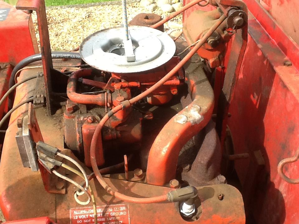

chris sutton 610 #21 Posted March 24, 2018 (edited) Carb all refitted now and a new manifold gaskit. It took a bit of encouragement to get it going but once running and tuned in it runs real sweet. Had it running for half an hour with no missfires or smoke so I'm pleased with that and its restarts easy. Edited March 24, 2018 by chris sutton 2 Share this post Link to post Share on other sites
