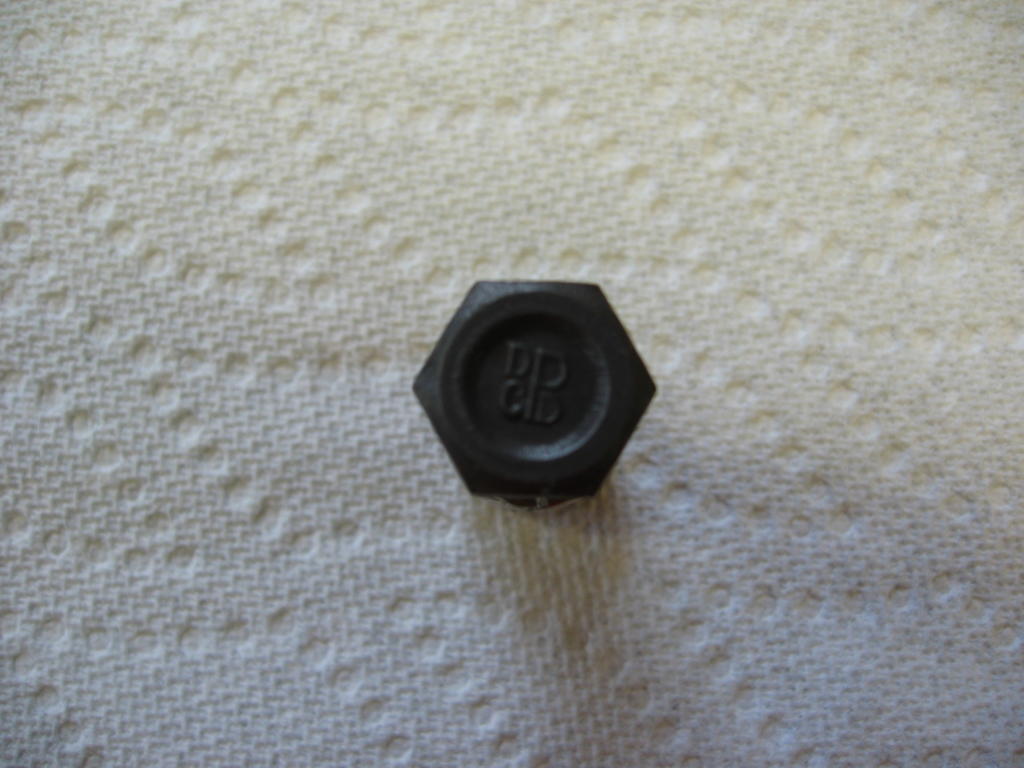

pfrederi 20,037 #11 Posted March 20, 2018 Bolts are not fool proof..They can back out, usually left side. Happened to me when plowing a few years ago with aC-175. Fell off several hundred feet from the shop major PIA (That is why old trucks had left hand thread lugnuts on the drivers side) Wheel horse spec'd bolts with a plastic plug in them to keep that from happening but over time plastic gives up. I am using these now. 5 Share this post Link to post Share on other sites

pfrederi 20,037 #18 Posted March 20, 2018 Snow plowing is hard on what ever you use to hold the wheel on. Think that when you are pushing heavy snow the front of the tractor wants to go sideways so you turn the wheels a bit to counter and they are slipping sideways. In my case I was plowing to the left and was counter steering so the wheel was being pushed hard against the bolt (in my case) and it unscrewed or in other cases pops off the e clip. 3 Share this post Link to post Share on other sites

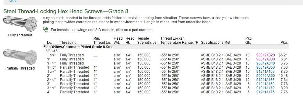

Pollack Pete 2,273 #23 Posted March 20, 2018 I'd use 3/8 in. fine thread bolts with red Loc-tite.You'll still get them out when you need to remove a wheel.If they did happen to loosen up,the fine threaded bolt takes more turns to actually fall out. 1 Share this post Link to post Share on other sites
