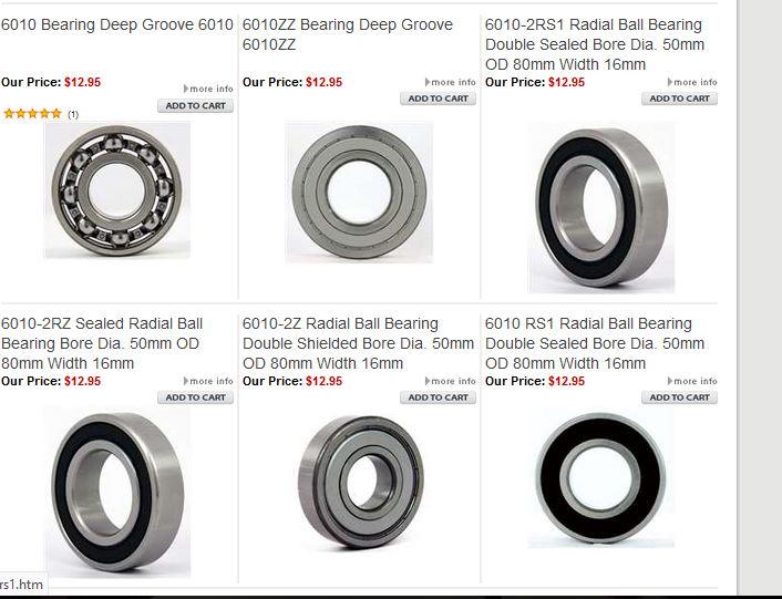

"Manic-Mechanic" 1,485 #9 Posted March 20, 2018 well, toro has that one for 153.39! I found one for 11.00-new so far! Quality? 1.950 x 3.140 x 6.30/1.870 x 2.950 x 6.30 Oldman Share this post Link to post Share on other sites
pfrederi 19,921 #10 Posted March 20, 2018 $56 was Timken Found these much cheaper 1 Share this post Link to post Share on other sites
"Manic-Mechanic" 1,485 #11 Posted March 20, 2018 (edited) Excellent, looks like 102914 is readily available! A japan made 6010 sealed, is 43.30 Applied Technologies in Chbg, PA. The other one, 102919 is the odd ball. 1.870 x 2.950 x .630inch or 47.498 x 74.93 x 16.02mm. Giving +0/- .010 should round it down or up? Lol! Oldman Edited March 20, 2018 by Oldman Share this post Link to post Share on other sites
pfrederi 19,921 #12 Posted March 20, 2018 25 minutes ago, Oldman said: Excellent, looks like 102914 is readily available! A japan made 6010 sealed, is 43.30 Applied Technologies in Chbg, PA. The other one, 102919 is the odd ball. 1.870 x 2.950 x .630inch or 47.498 x 74.93 x 16.02mm. Giving +0/- .010 should round it down or up? Lol! Oldman Couldn't find any bearing with 75mm outer other than 45mm or 50mm shaft. I think I would take the old bearing to a bearing place.... http://www.skf.com/us/system/ProductSearchResult.html Share this post Link to post Share on other sites
