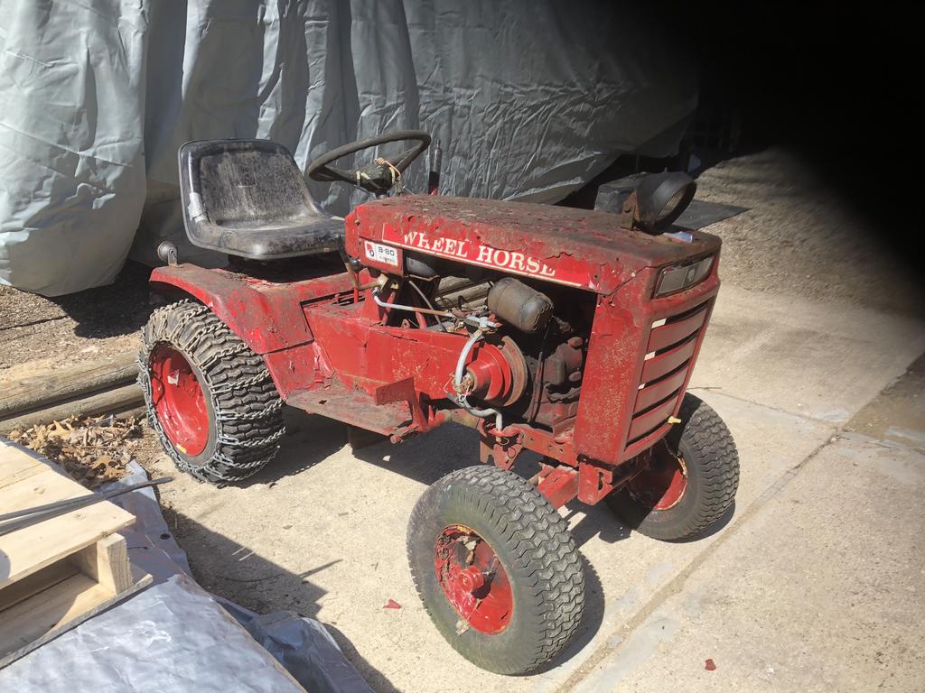

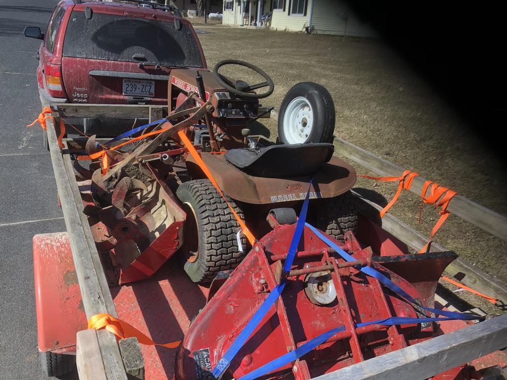

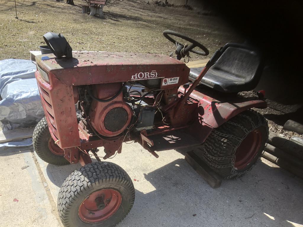

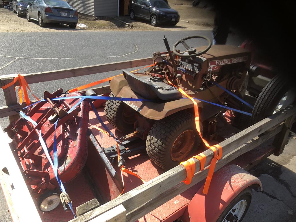

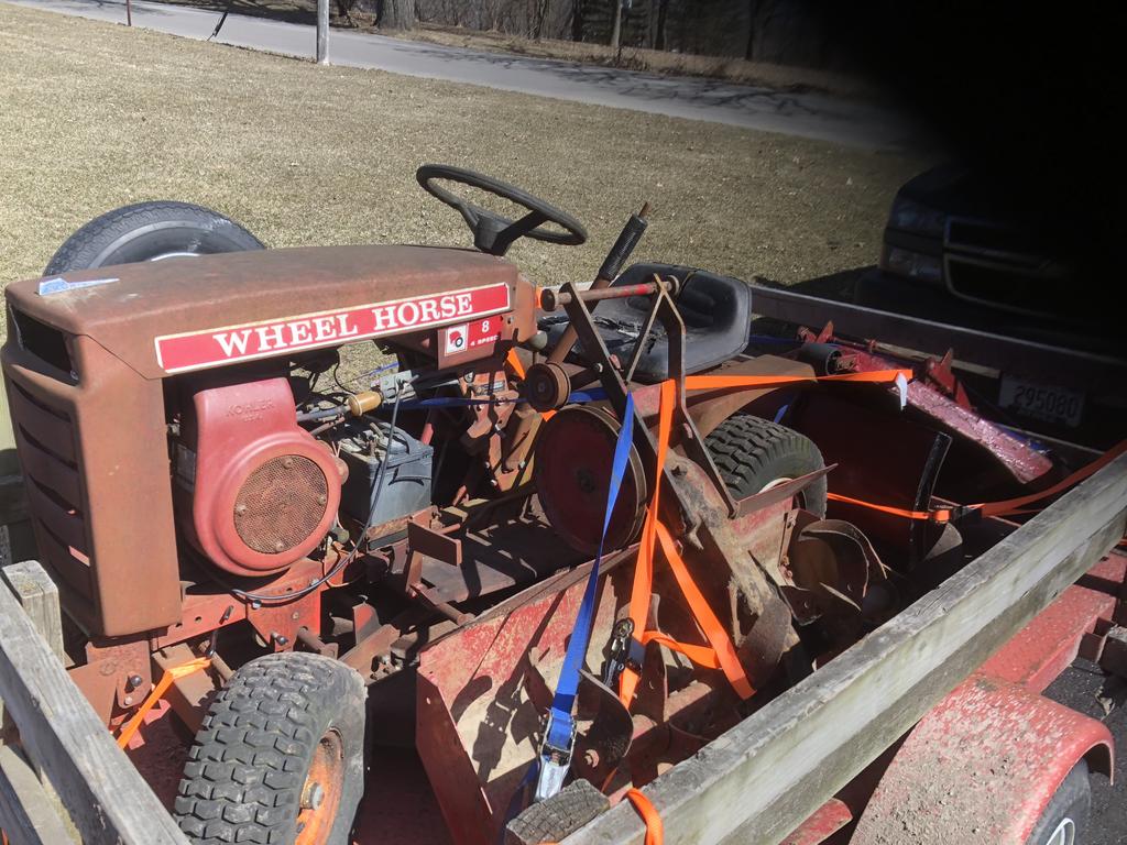

Deadguy 861 #1 Posted March 18, 2018 So I put in some driving time on Saturday, and wouldn’t you know it, some Horses followed me home again! I ended up with a patina’ed 1973 8hp and a 1974? B80 with a coat of peeling house paint. Neither are running at the moment, but the engines are free, everything is there, and the metal is straight. I also ended up with a snow plow, mowing decks, a tiller, and my father in law got a brinly plow and a Wheel Horse brand discer. I also met Joe in Polo, IL, and I will definitely have to stop there again. 13 1 Share this post Link to post Share on other sites
