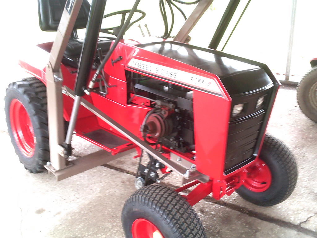

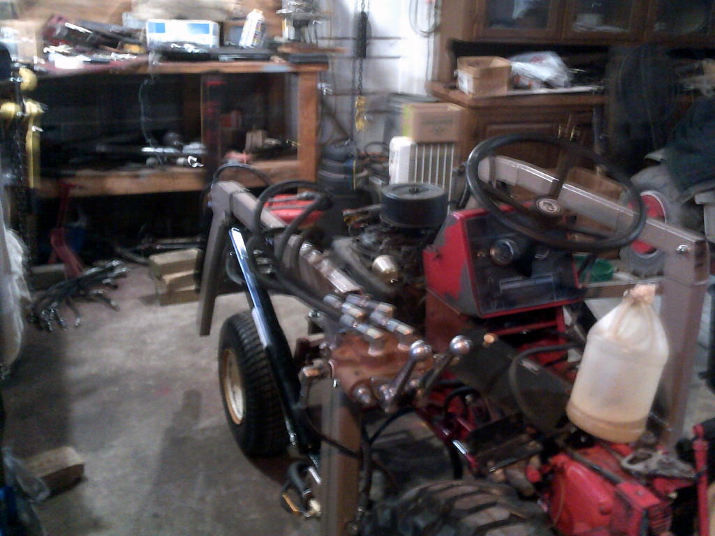

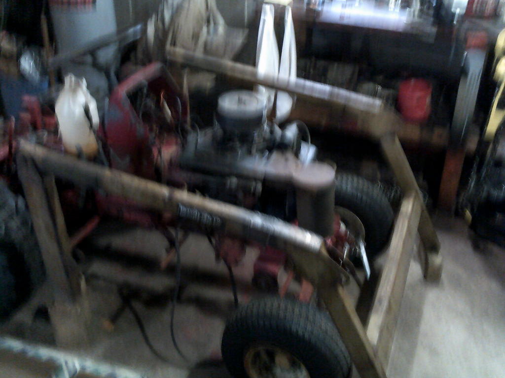

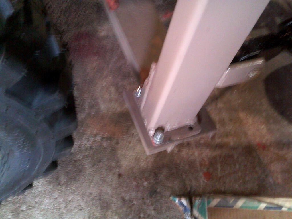

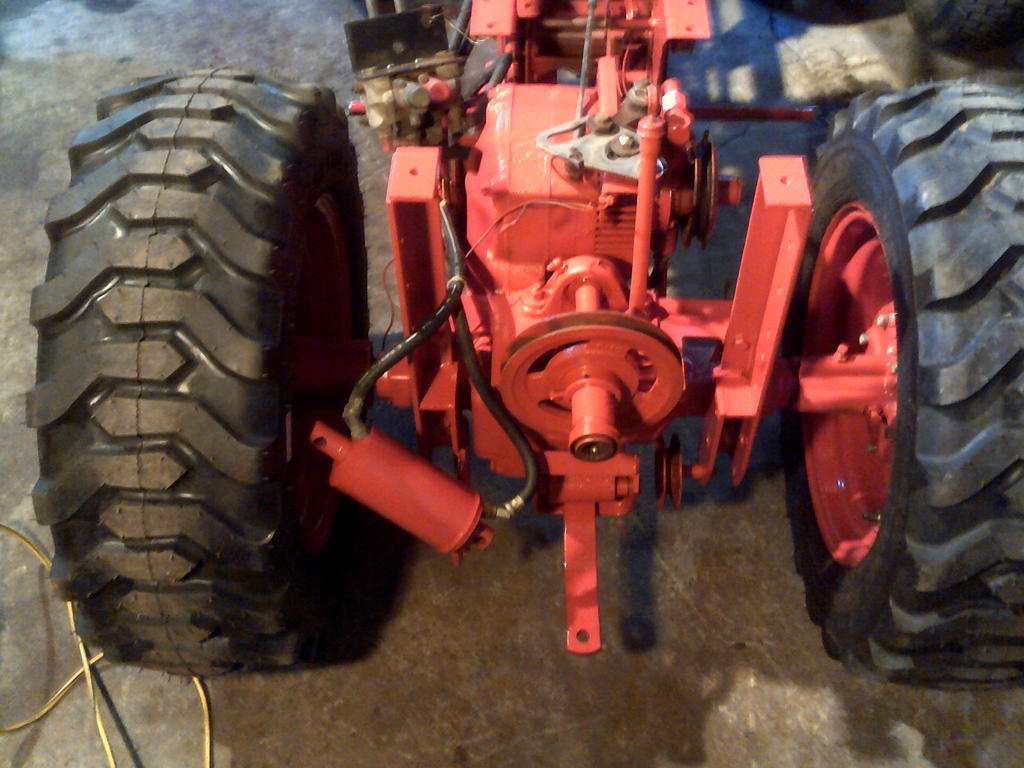

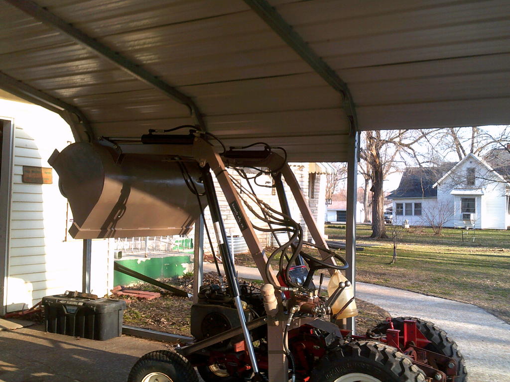

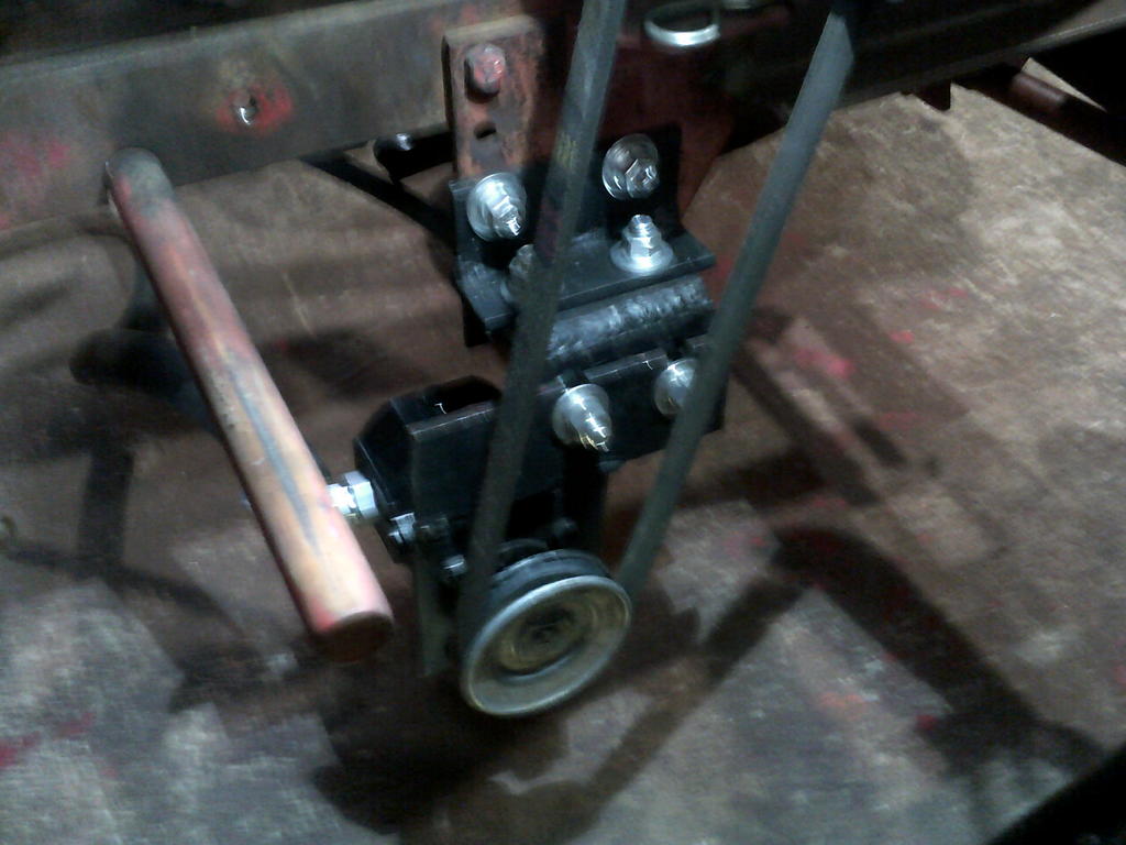

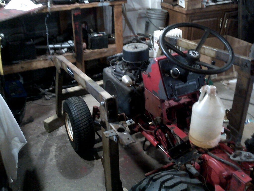

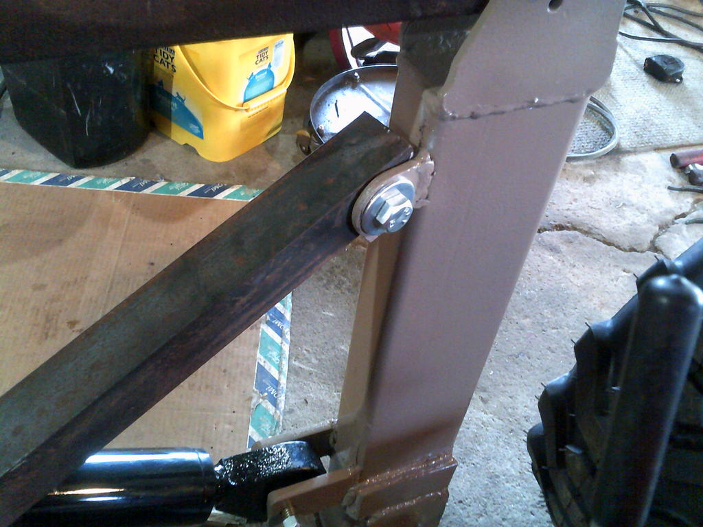

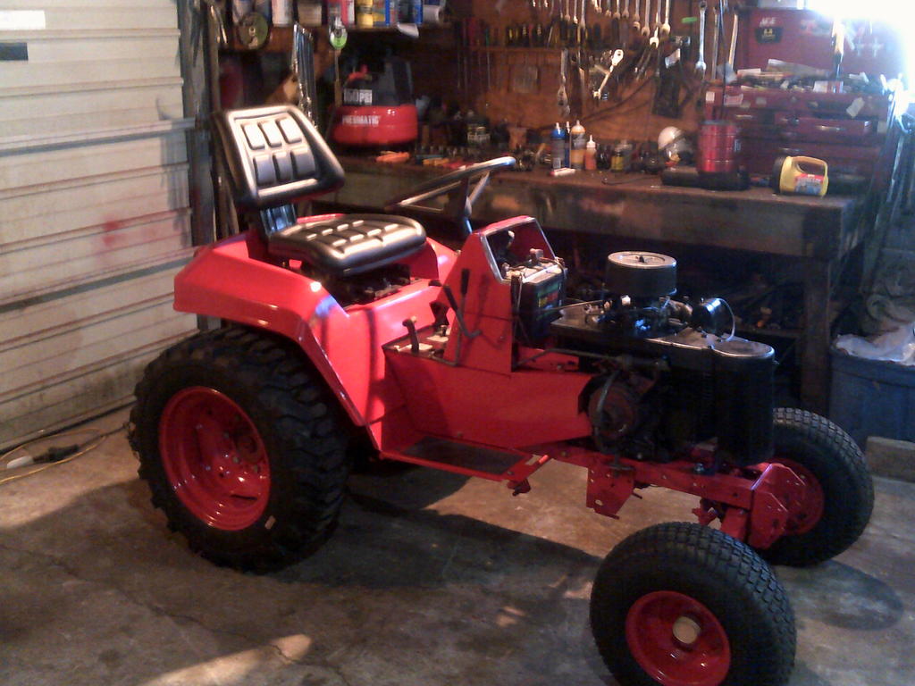

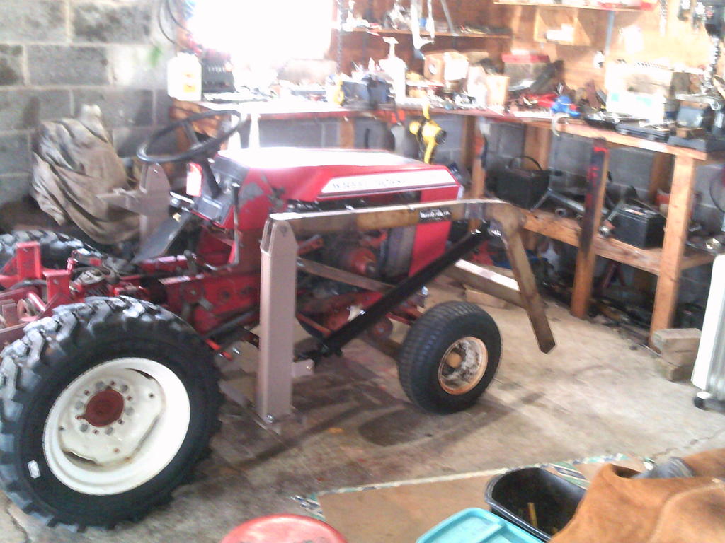

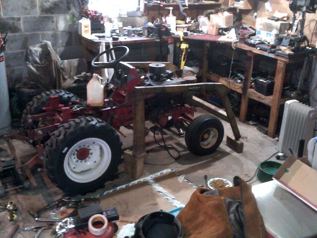

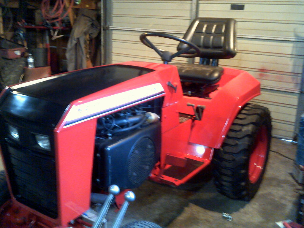

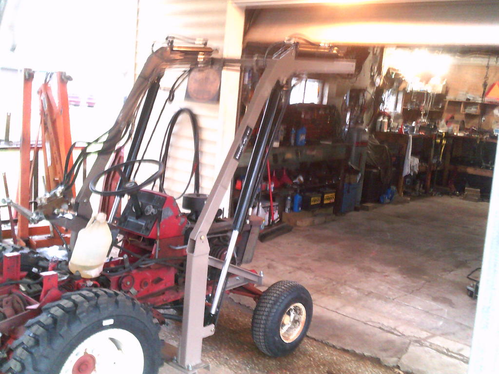

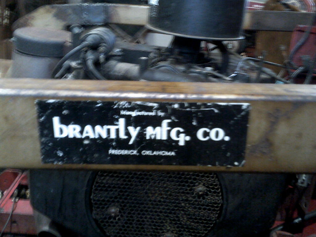

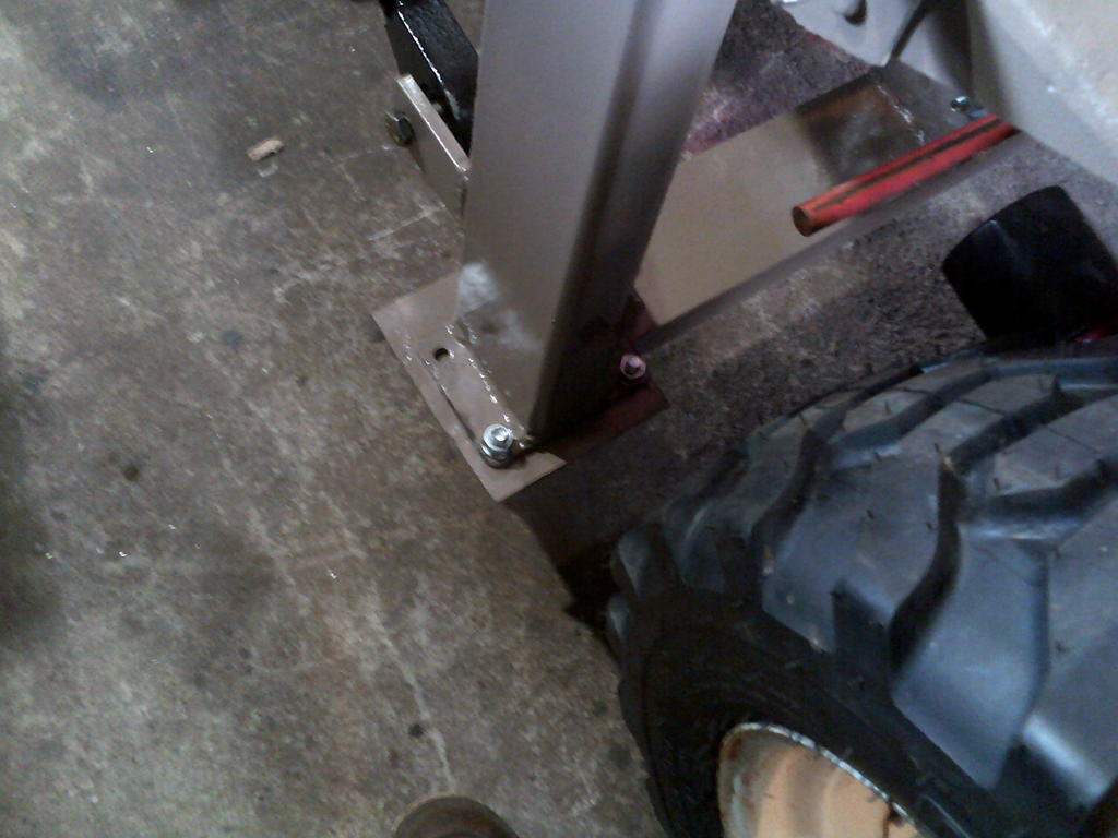

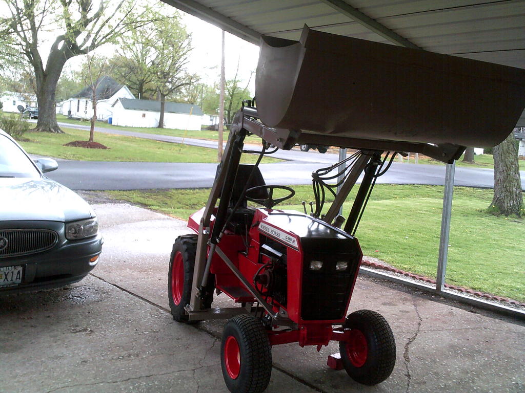

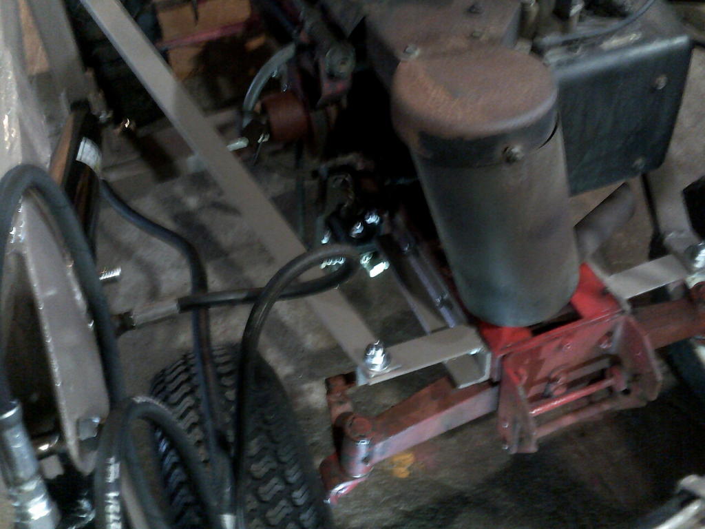

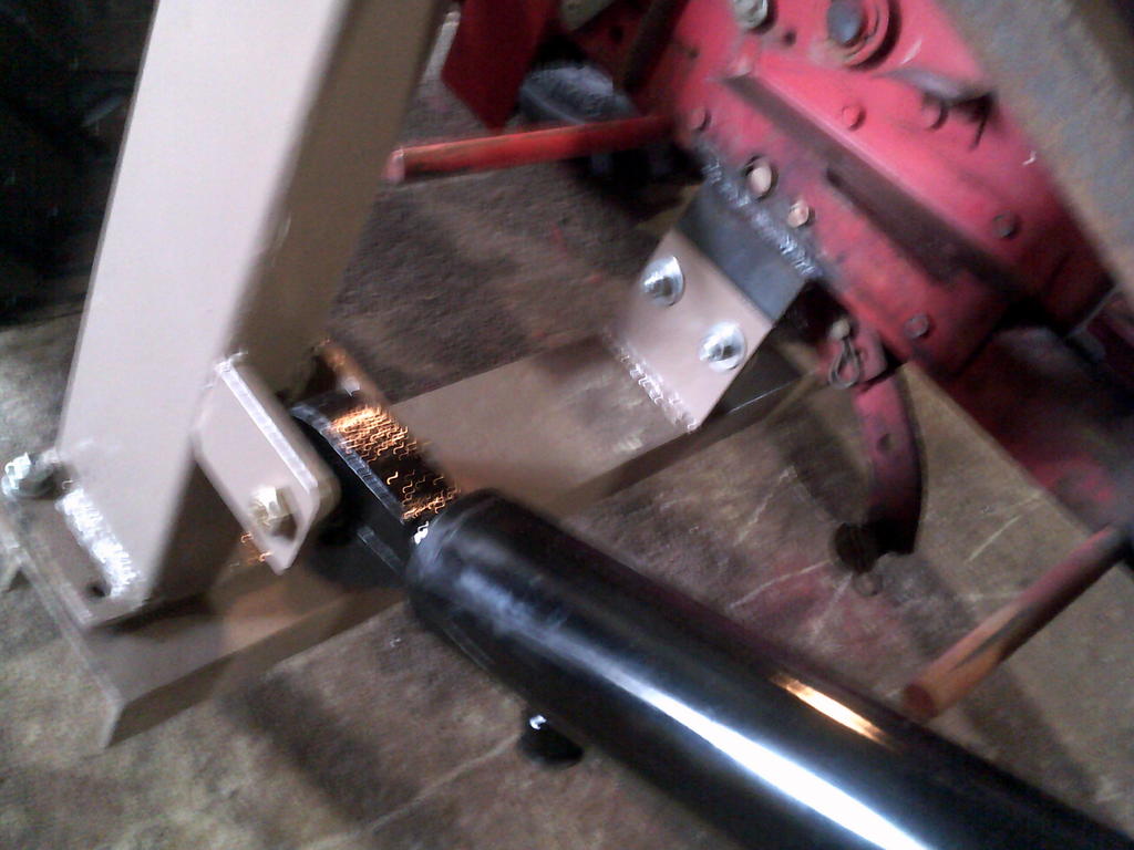

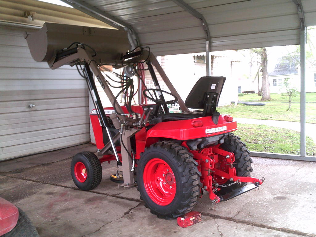

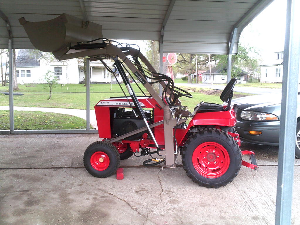

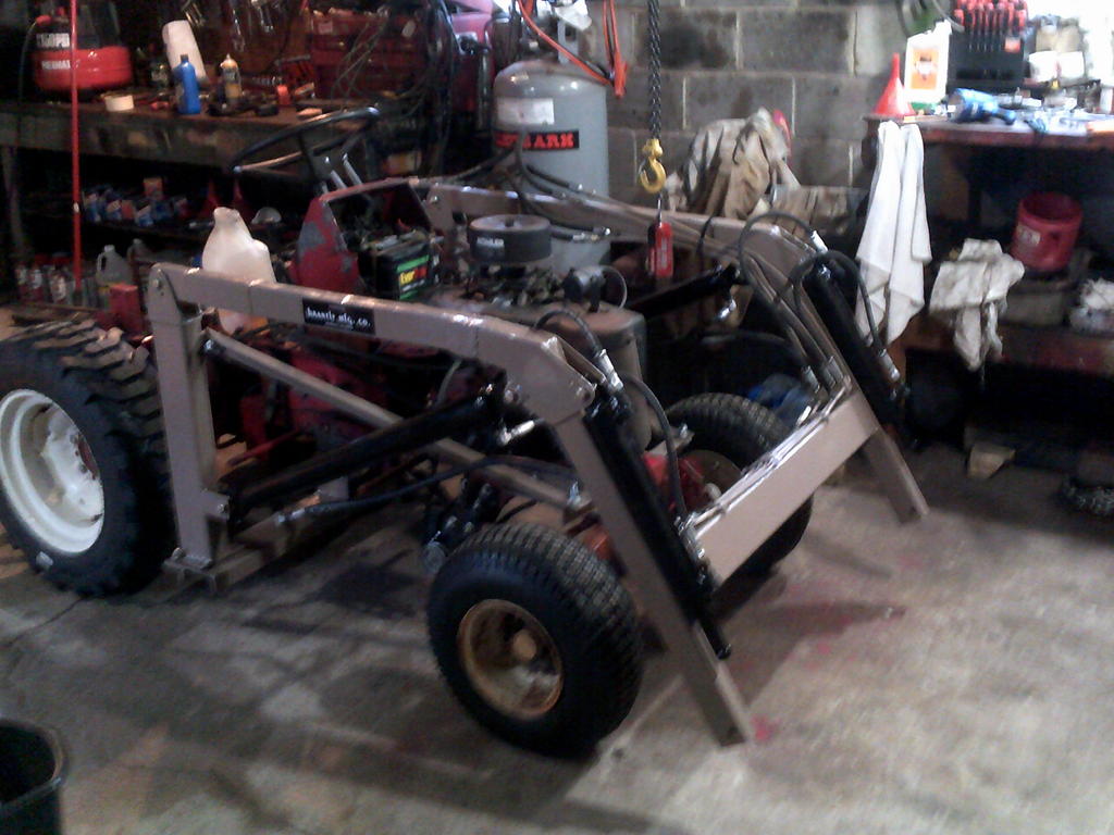

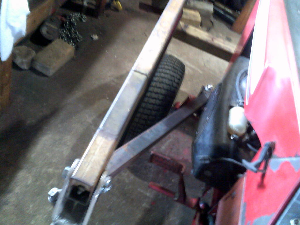

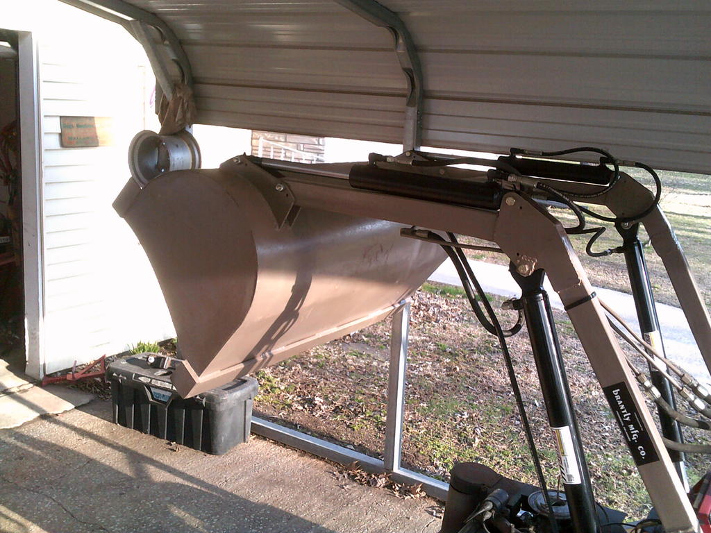

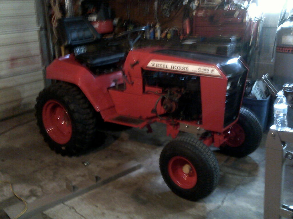

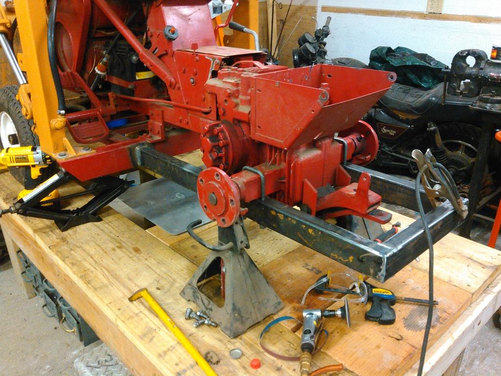

elliot ness 1,916 #1 Posted March 18, 2018 (edited) Started another Loader project yesterday, C195 and Brantly loader, The brantly's are a rear bird. The loader needs some work on the cylinders and 6 new lines. The C195 is going to get a full paint make over when the loader is finished. will keep the pics coming as I progress. Had to move all the tabs for the angle braces and for the new lift cylinders, the new cylinders are 4inches longer so it will lift over 6feet high now. , worked 2 days on the underside bracket. Should get the pump mounted this week. lots more to do. Edited March 25, 2018 by elliot ness more pictures 13 Share this post Link to post Share on other sites

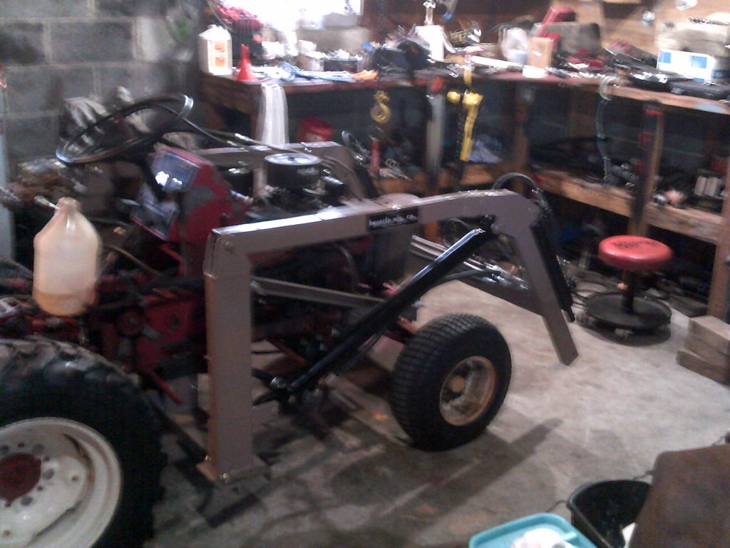

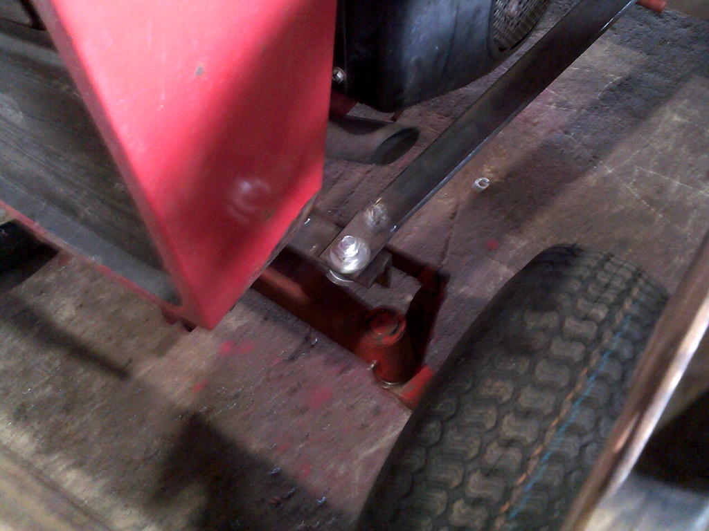

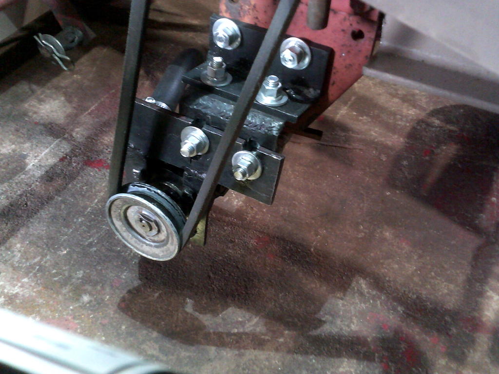

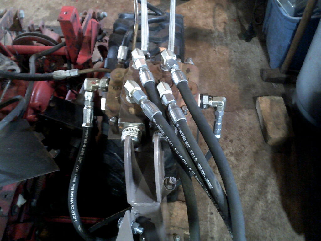

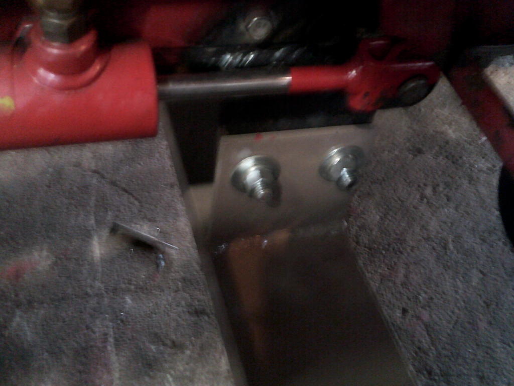

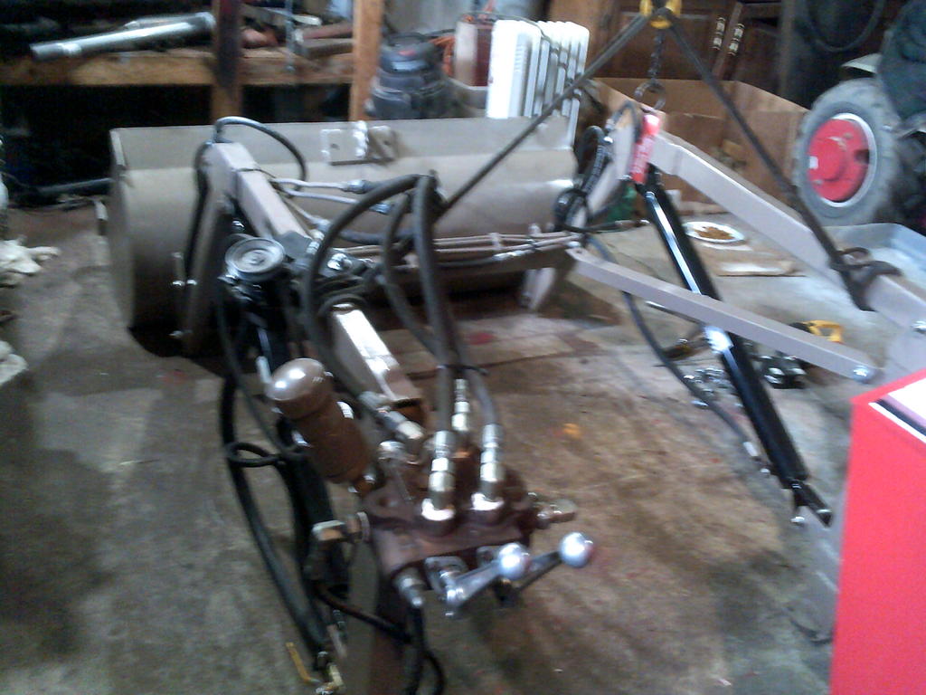

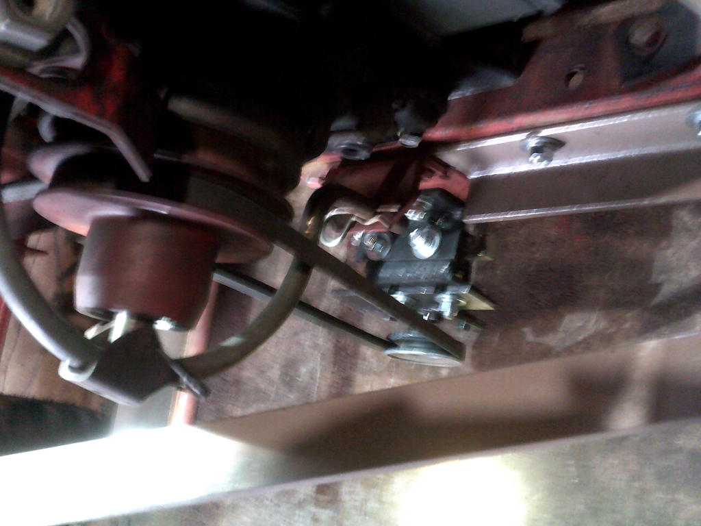

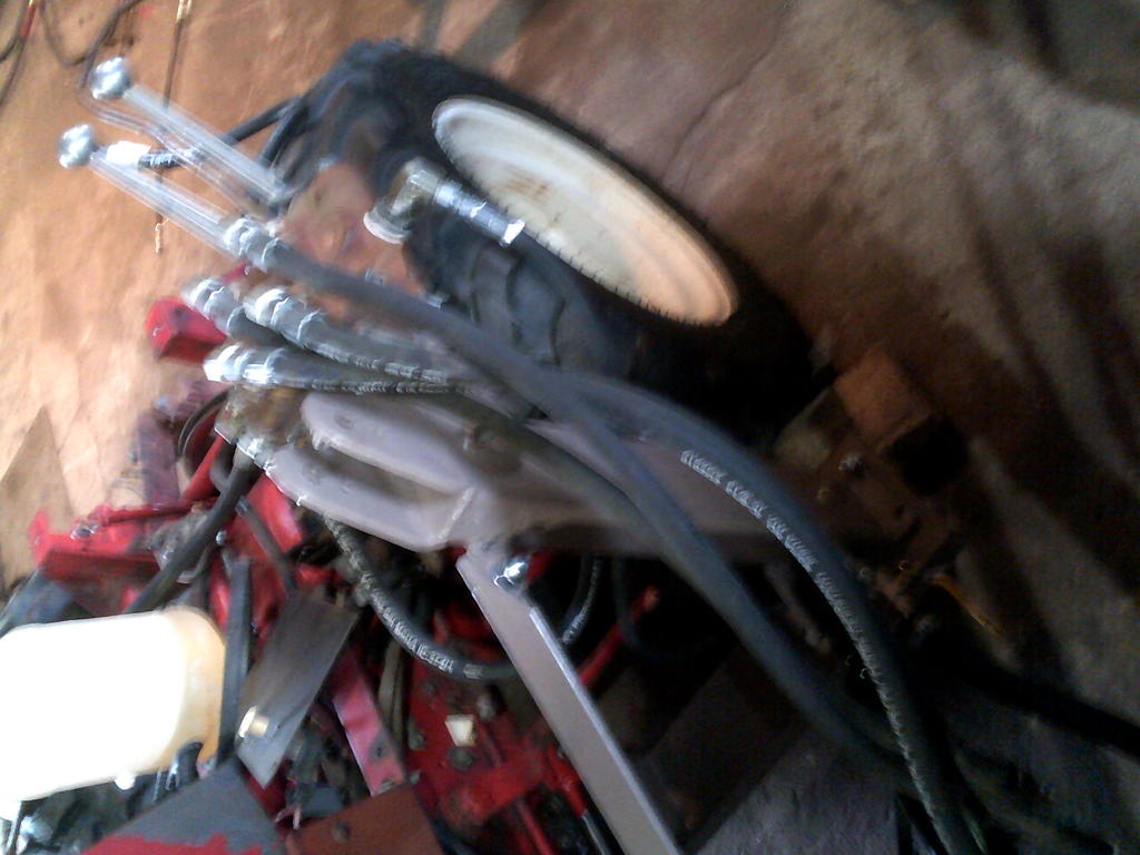

elliot ness 1,916 #4 Posted March 29, 2018 More pictures. Got the pump mounted plus a few more things. Will paint rest of loader when weather worms up. The pump is from Northern tool and it is bi-directional. .0285 ci. I have used them before and they work good. 3 Share this post Link to post Share on other sites

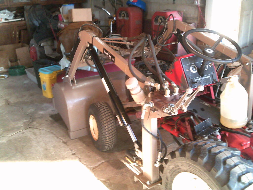

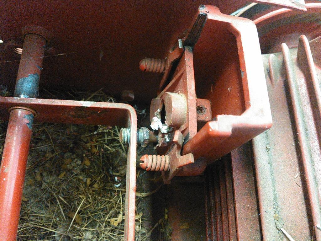

RandyLittrell 3,944 #5 Posted March 29, 2018 I would highly suggest tying the loader mount into the rear trans somehow. When I got my 1277 with a johnson loader on it, it was mounted much like yours. It puts all the stress on the frame so it would tweak back and forth to the rear end. I put it in such a bind that the hydro control ball popped out of the plate. I got that fixed then built a brace to the rear end. I made mine a little over the top from what I had to be, but now I can tell if a rear tire is low because the loader touches the ground off. I will throw a pic up just to show what I did. My way added a place for counter weight, but there are a bunch of different ways it could be done. That loader looks a heck of a lot like a johnson loader. 2 2 Share this post Link to post Share on other sites
elliot ness 1,916 #6 Posted March 29, 2018 1 hour ago, RandyLittrell said: I would highly suggest tying the loader mount into the rear trans somehow. When I got my 1277 with a johnson loader on it, it was mounted much like yours. It puts all the stress on the frame so it would tweak back and forth to the rear end. I put it in such a bind that the hydro control ball popped out of the plate. I got that fixed then built a brace to the rear end. I made mine a little over the top from what I had to be, but now I can tell if a rear tire is low because the loader touches the ground off. I will throw a pic up just to show what I did. My way added a place for counter weight, but there are a bunch of different ways it could be done. That loader looks a heck of a lot like a johnson loader. 1 Share this post Link to post Share on other sites
elliot ness 1,916 #7 Posted March 29, 2018 1 hour ago, elliot ness said: Yours Looks real strong. Share this post Link to post Share on other sites
RandyLittrell 3,944 #8 Posted March 29, 2018 (edited) 11 minutes ago, elliot ness said: I know its a little overkill but that is kinda how I roll! But.....there is no frame flex at all now. Here is a pic of how the hydro control looked. A person wouldn't have to to go all the way around the back, just to the rear axle would suffice I think, but I like tubing over angle iron, much stiffer. Edited March 29, 2018 by RandyLittrell 1 Share this post Link to post Share on other sites

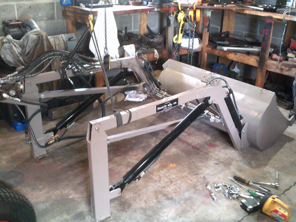

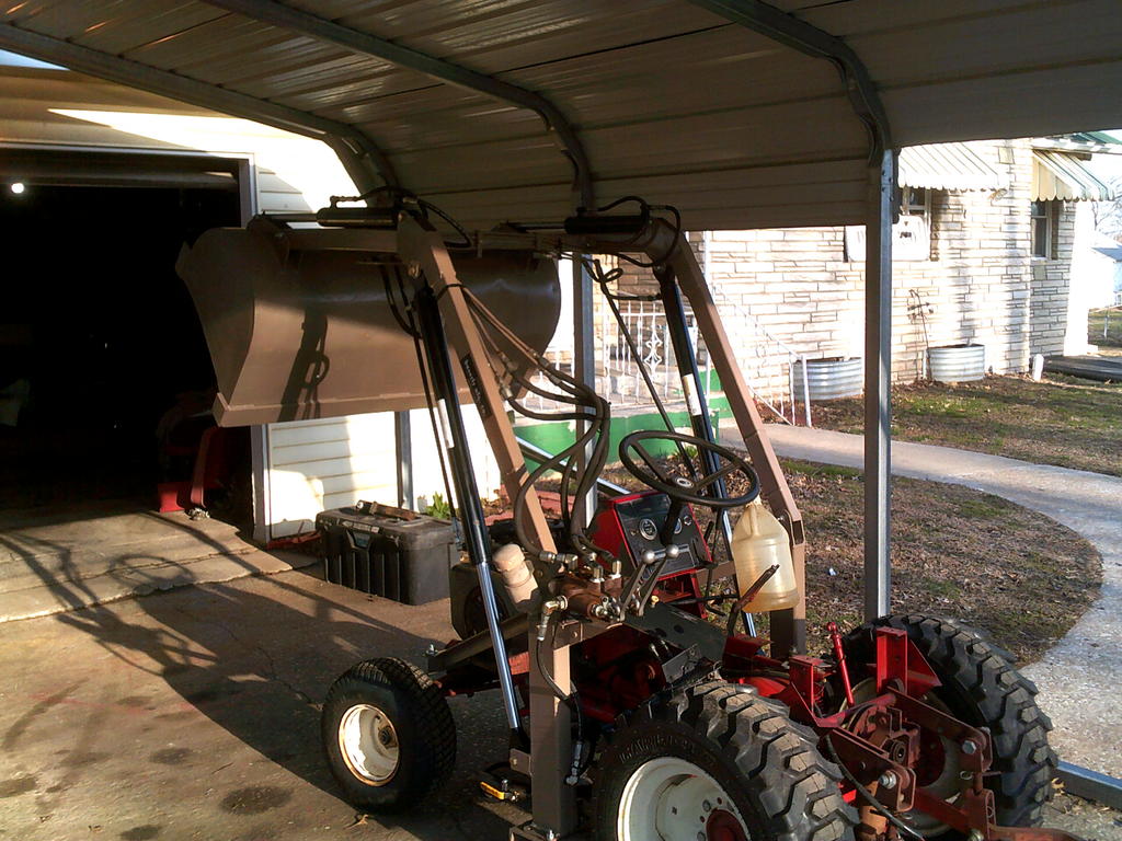

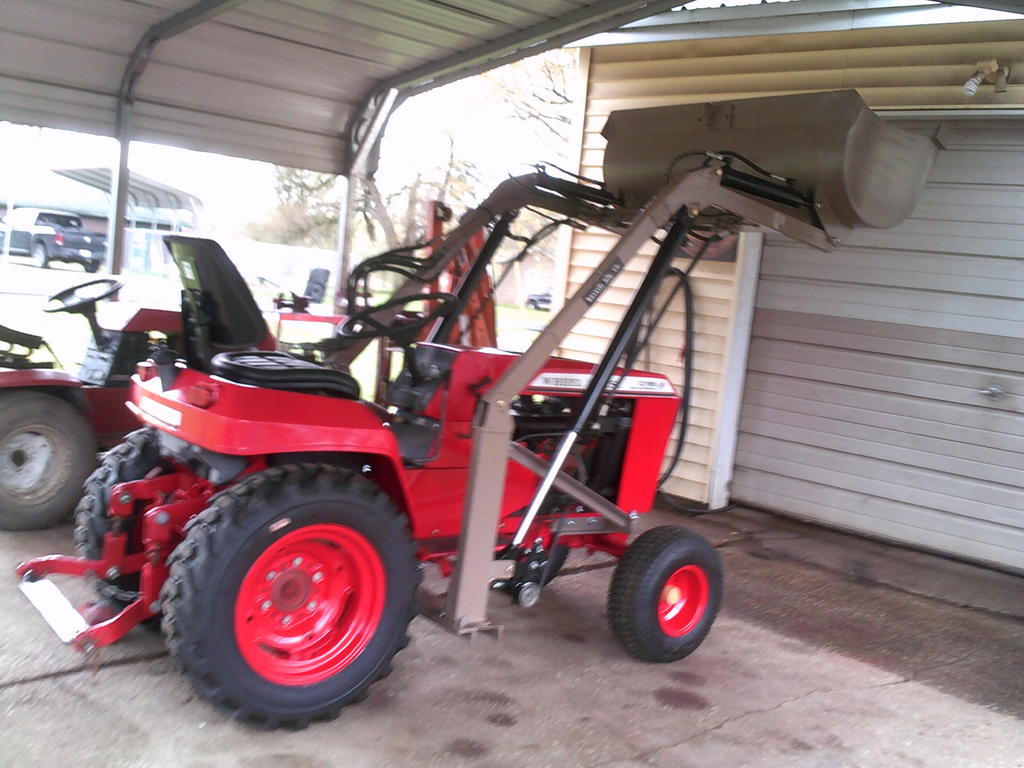

elliot ness 1,916 #11 Posted April 2, 2018 More pictures, A lot of loose ends to finish up, and the bucket needs finished. 2 Share this post Link to post Share on other sites

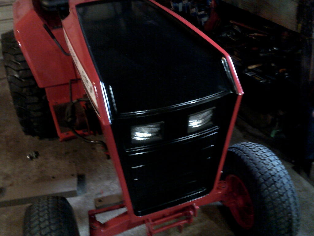

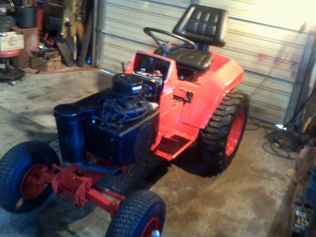

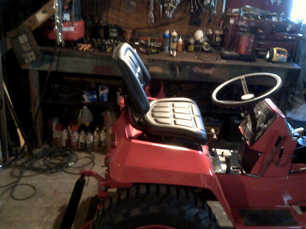

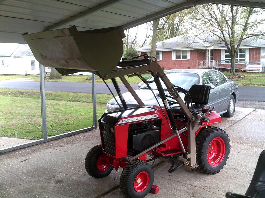

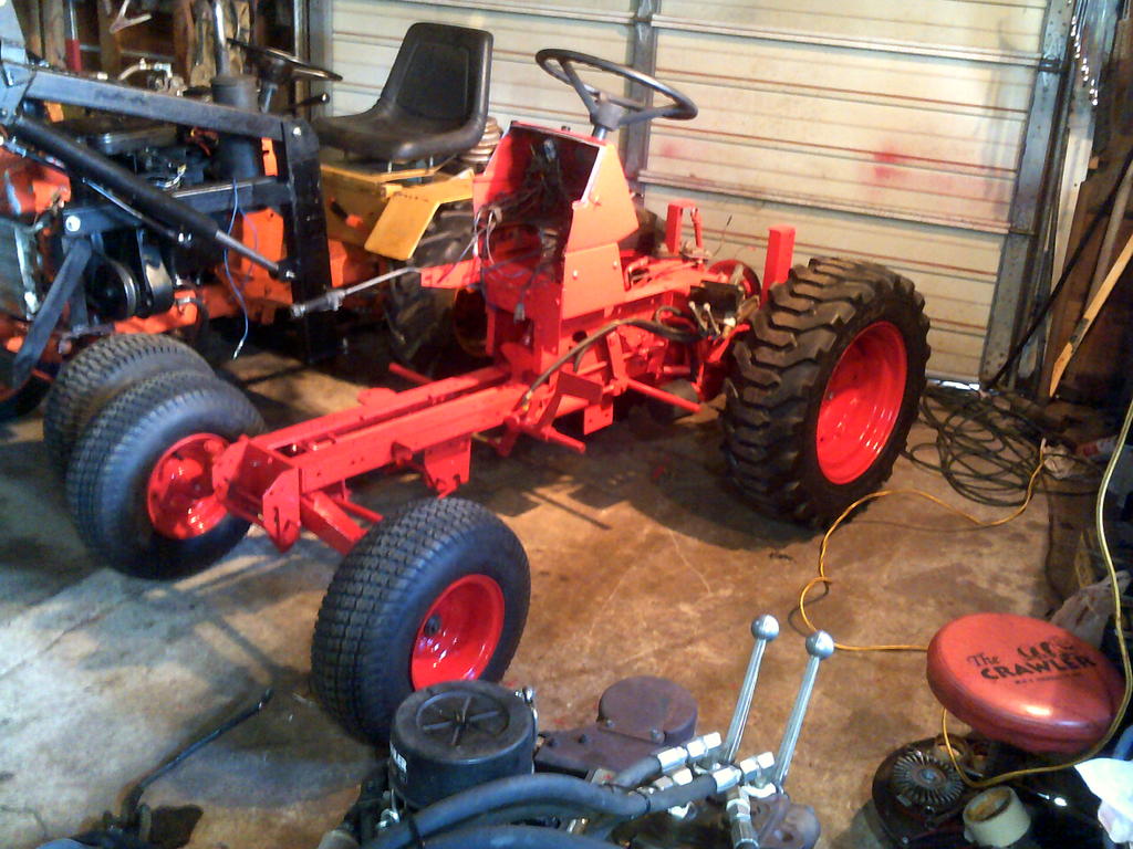

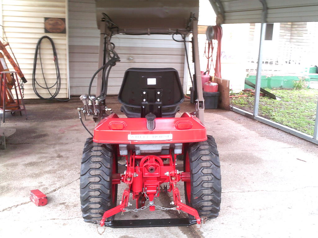

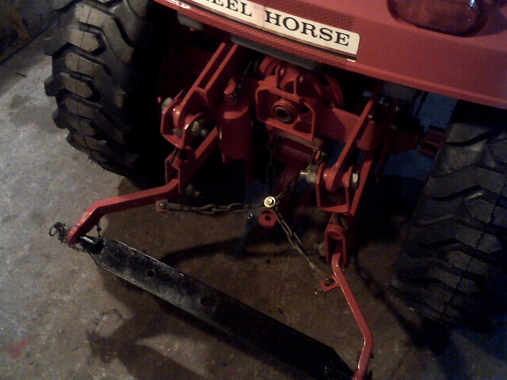

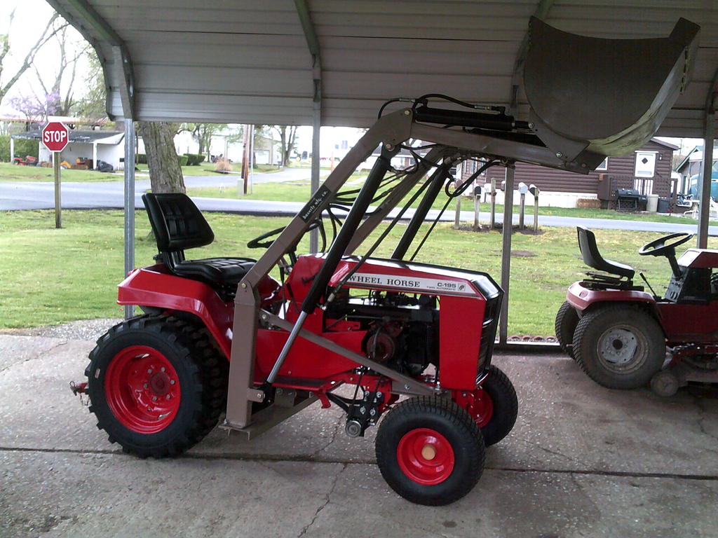

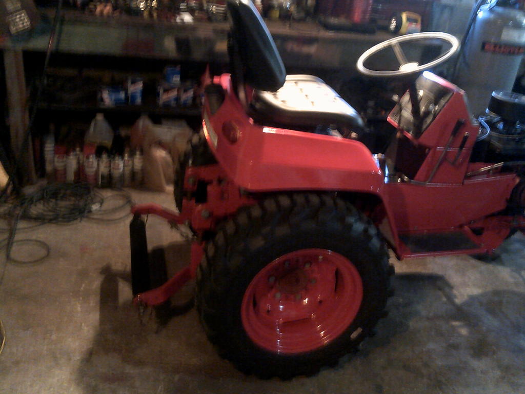

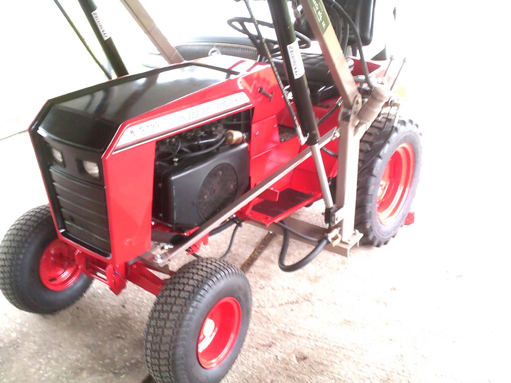

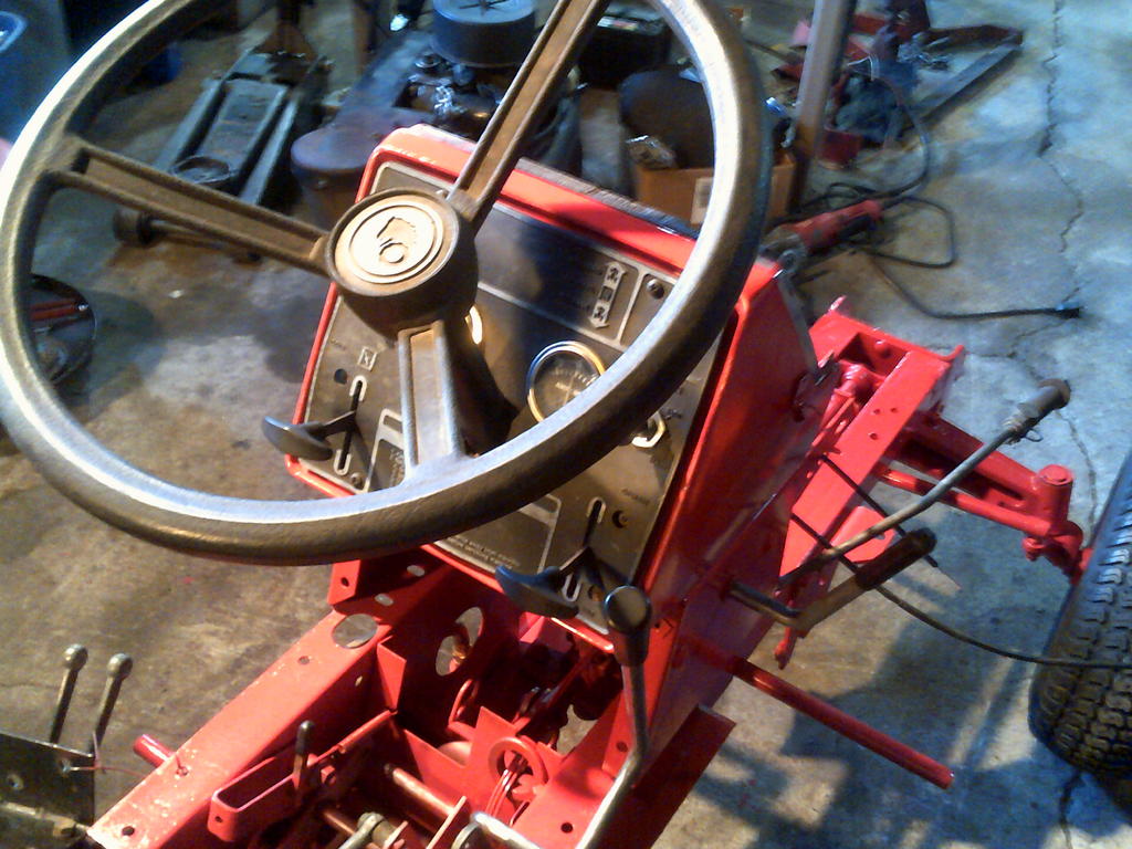

elliot ness 1,916 #13 Posted April 5, 2018 (edited) Finished with the loader. Now on to the tractor for a makeover. I am going to sell the loader if any one of you members are interested. PM me. or call 573-473-6944 Edited May 3, 2018 by elliot ness more pics 8 3 Share this post Link to post Share on other sites
AMC RULES 37,254 #14 Posted April 5, 2018 Man, you sure don't waste any time. FEL turned out great. 2 Share this post Link to post Share on other sites

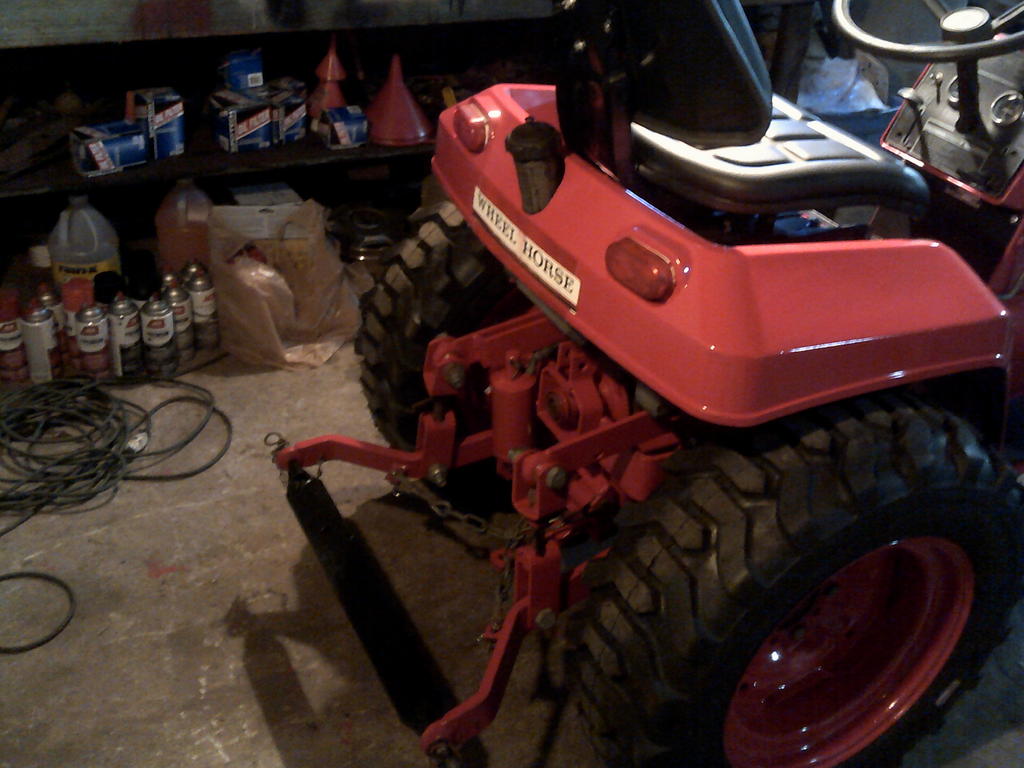

DennisThornton 4,773 #15 Posted April 5, 2018 I have a a 35 hp 4wd with loader and backhoe and I sit here drooling over both the C-195 and FEL! I really love my New Holland TC-35 but it would really be nice to have something smaller at times and (other than the lack of 4wd AND PS!) I think your creation is ideal. Any thoughts about adding PS? BIG rear weight? Again, very nice! How'd you make the bucket? 3 Share this post Link to post Share on other sites
RandyLittrell 3,944 #16 Posted April 5, 2018 The lift you getting out of that is awesome! Can't wait to see it all done and moving some dirt or gravel! Please keep up with pics, we love em! Randy 2 Share this post Link to post Share on other sites

Forest Road 595 #18 Posted April 12, 2018 BTW I run a bunch of weight. 50lb wheel weights. And 300+ on a ballast rack. I used a 2” receiver hitch to mount the ballast. Also have a ballast box I can swap in. Comes in handy when I doing chores as a tool holder, rope, shovels, chainsaws.... 1 Share this post Link to post Share on other sites
