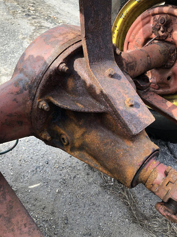

DennisThornton 4,773 #33 Posted March 21, 2018 Can anyone recognize what components were used to build this specimen? I'm satisfied that it's homemade and one of a kind (though I've been wrong...) but what was used to build it? I'm sure someone here knows! But I sure don't. Share this post Link to post Share on other sites
mikeeyre74 290 #34 Posted March 22, 2018 I tried googling those casting codes on the rear end, but it didn’t come up with anything useful. I simply have no idea what that gearbox might have come from either. The engine, Google says, probably came from a small sawmill, which these were pretty common in I take it? The whole plow mechanism and hydraulic pump appears to be from an early jeep CJ2 or thereabouts. That’s all I got! Share this post Link to post Share on other sites
DennisThornton 4,773 #35 Posted March 22, 2018 Mike, what if you started another thread asking to ID the rear end. Perhaps another to ID the trans. I can't believe that no one here knows those parts, just that they haven't seen this thread. 1 Share this post Link to post Share on other sites
cpete1 332 #36 Posted March 23, 2018 Holy Fabricators Batman, That thing is a THING OF BEAUTY, Transmission is definitely truck type stuff with band brake. The plow has parallel arms, angle capacity, hydraulics for gods sake.... wow... (Sorry for "drooling" on the key board guys, I just love this kind of stuff) Mikey, Thank you for the post.... Chris 1 1 Share this post Link to post Share on other sites
WHX?? 57,935 #37 Posted March 23, 2018 The thing that hits me is rear end front looks like it was almost cast specifically for the seat support so it might be supposed that the rear end was made for a GT? If so then there should be other tractors out there with this rear end? Unless that surface was for mounting shocks or struts on another vehicle? 1 Share this post Link to post Share on other sites

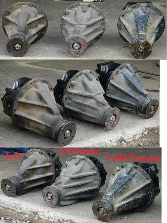

mikeeyre74 290 #39 Posted March 23, 2018 After asking a friend of mine for a little help, he pointed me towards Toyotas, and after a little poking around on the Internet with some identification guides, I’m pretty darn sure that’s a Toyota Land Cruiser differential. The place where the seat bracket bolts on, the Toyotas have an angled chunk of metal there that could be drilled and tapped where you could put that bracket and bolt it down. 1 Share this post Link to post Share on other sites
WHX?? 57,935 #40 Posted March 23, 2018 (edited) Thanks for putting holes in my boat Mike but you could be right ....from Wikipedia ...Production of the first generation Land Cruiser began in 1951 (90 units) as Toyota's version of a Jeep-like vehicle Edited March 23, 2018 by WHX14 1 Share this post Link to post Share on other sites

Sarge 3,473 #43 Posted March 24, 2018 I doubt that's any version of the Land Cruiser differential, they are far heavier being a 9.5" ring gear and also have a separate rear cover. Not any Toyota that I'm aware of and I've worked on and set up a ton of A sin built drive lines. I'd almost bet it's a Chrysler 8-1/4", judging by the center section and axles. Not to mention, many of their versions had bolt holes on top for a pinion snubber pad to stop squat when hard launching. I did break a couple of those pads off and had to replace them, $30 back in the day from Chrysler. Sarge Share this post Link to post Share on other sites
DennisThornton 4,773 #44 Posted March 24, 2018 7 hours ago, Sarge said: I doubt that's any version of the Land Cruiser differential, they are far heavier being a 9.5" ring gear and also have a separate rear cover. Not any Toyota that I'm aware of and I've worked on and set up a ton of A sin built drive lines. I'd almost bet it's a Chrysler 8-1/4", judging by the center section and axles. Not to mention, many of their versions had bolt holes on top for a pinion snubber pad to stop squat when hard launching. I did break a couple of those pads off and had to replace them, $30 back in the day from Chrysler. Sarge Pretty sure other brands had snubbers too. Share this post Link to post Share on other sites
