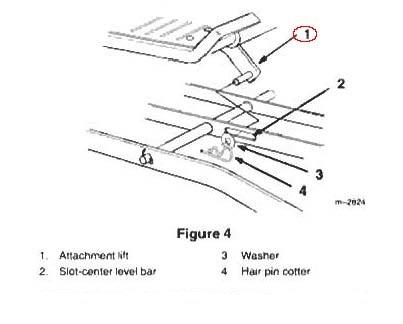

hunterguy92 17 #1 Posted March 18, 2018 (edited) Came home with a C-120 today and somewhere on the way home the deck came loose from manual deft lift lever and I found some parts laying around. Is there only one height adjustment rod that lifts the deck? (Picture below) Pictures of where your deck attaches to the manual lift lever via these rods would really help. Thanks a lot guys. Edited March 18, 2018 by hunterguy92 Share this post Link to post Share on other sites
Tankman 3,523 #2 Posted March 18, 2018 (edited) Great forums, forever better Horses. Ride 'em cowboys. Some years ago I patched a deck. In the picture you can see where your lonely height adjustment rod calls home. After bolting the 16 ga CRS galvanized patch in place, stitch welded in place. Disassembled the deck after welding for cleaning, painting, decals. Edited March 18, 2018 by Tankman 1 Share this post Link to post Share on other sites
ztnoo 2,300 #3 Posted March 18, 2018 10 hours ago, hunterguy92 said: Is there only one height adjustment rod that lifts the deck? What you are showing in the pic is just the lift rod. Share this post Link to post Share on other sites
Tankman 3,523 #4 Posted March 18, 2018 The rod shown adjusts the height of the (cut) deck, deck "floats" on the wheels. For transport off the ground, attachment lift pin (#1 in image). Share this post Link to post Share on other sites
