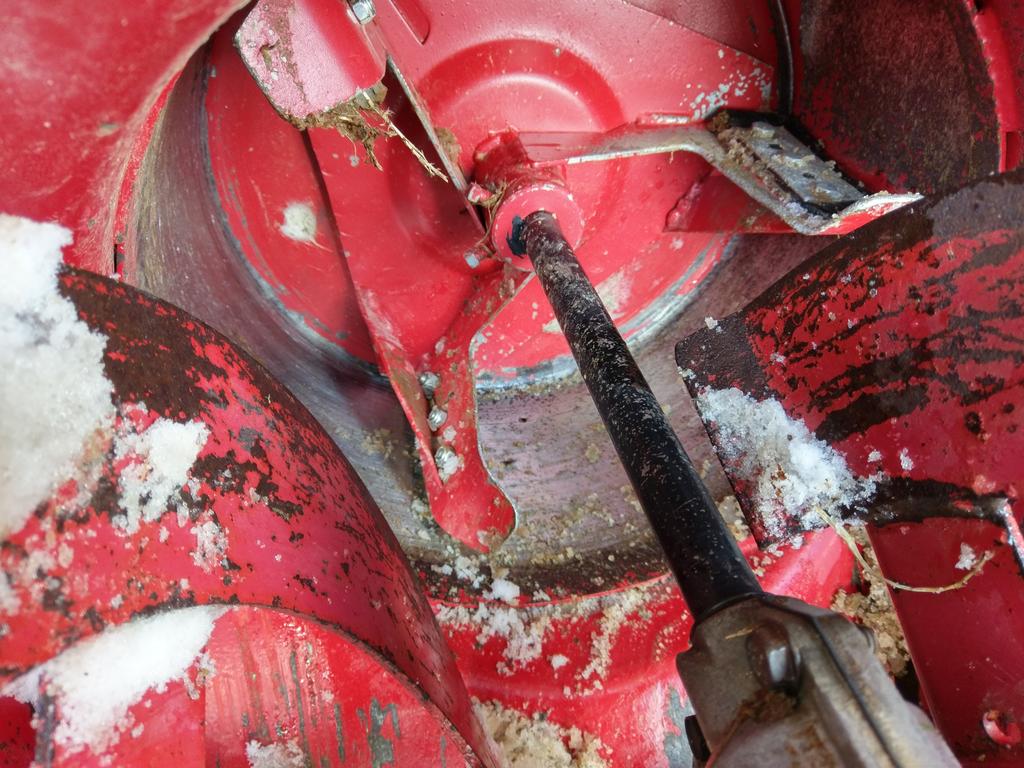

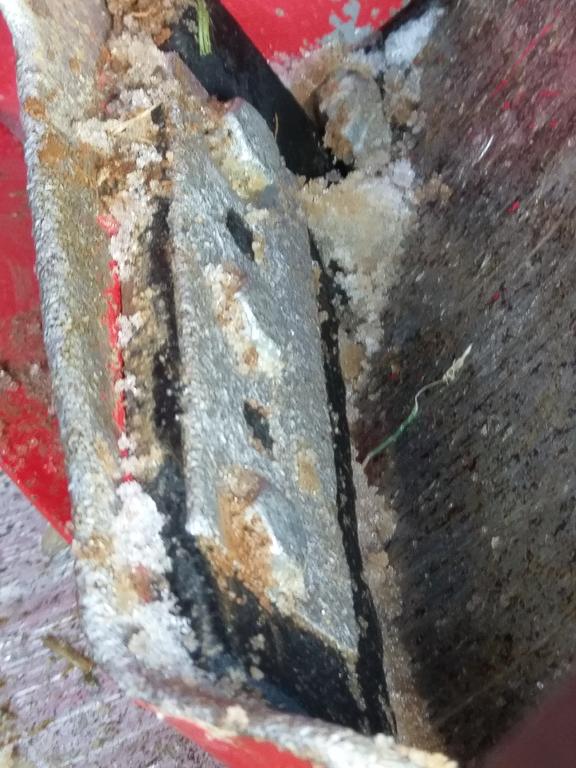

wallfish 20,576 #26 Posted March 14, 2018 We got about 16" yesterday and had a difficult time. Seems the DOT plow caught some of the curb and tore it up coming down the street and deposited asphalt and stones in the snow bank. Sure enough my 2 stage found one right away and wedged a big stone between the paddle and the chute frame effectively stopping the blower cold real fast quick and in a hurry. Got it out with a pry bar and the paddle took a good hit and bent but that can be fixed later. Started again and the belt snapped after 20 ft from being burned up from the sudden stop. Of coarse the replacement belt I have was wrong! For 2 years I've been staring at that belt knowing I have a replacement if a problems arises but obviously made a huge mistake. Luckily one of the local shops was still open so went out and got a belt. Install new belt, go another 20' and the chain snapped. I'm not up for doing that in the middle of a storm with snow and wind. Had to fire up the little 654 and push wet heavy piles which puts a beating on that thing. I know people will say "whatever you do don't ram the snow piles" . Well, I'd much rather spend 2 hours in the Spring fixing the frame than spend 6 hours of freezing my nuts off pushing little bits of snow around the driveway. Anyway, end of rant and just needed to vent 6 2 Share this post Link to post Share on other sites
