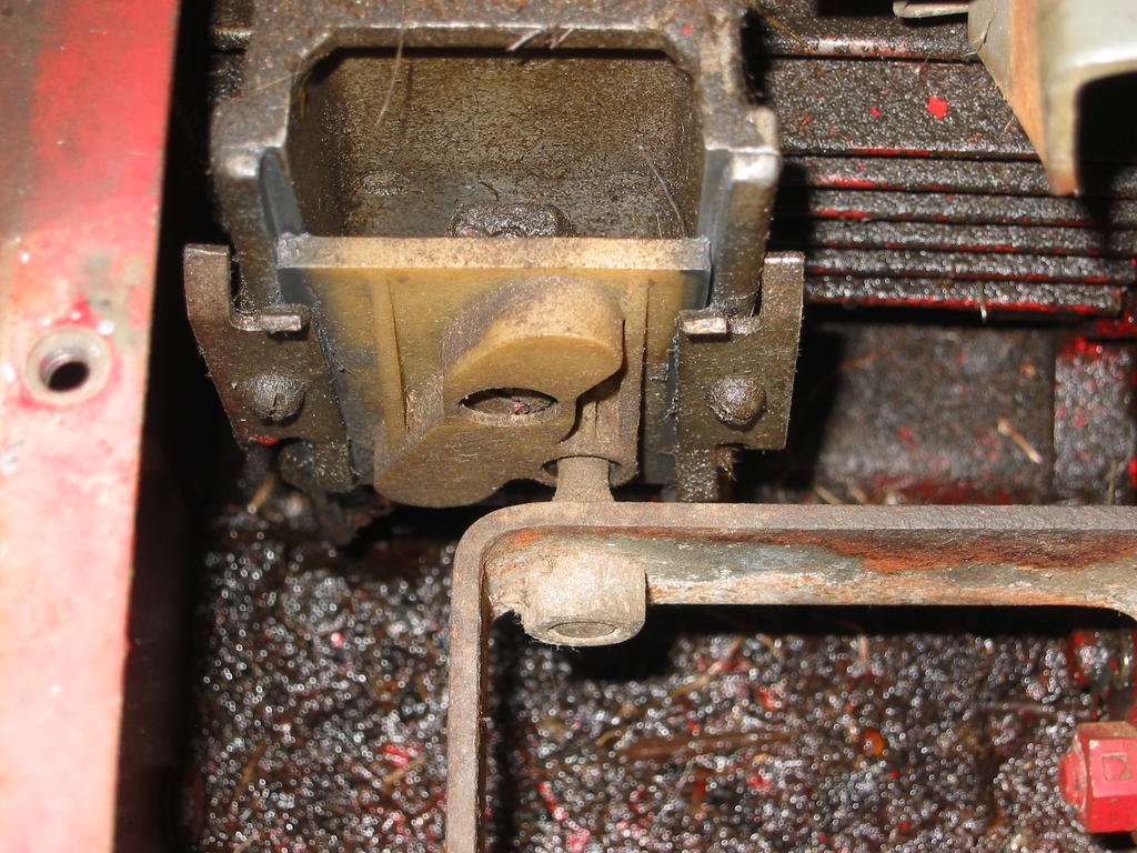

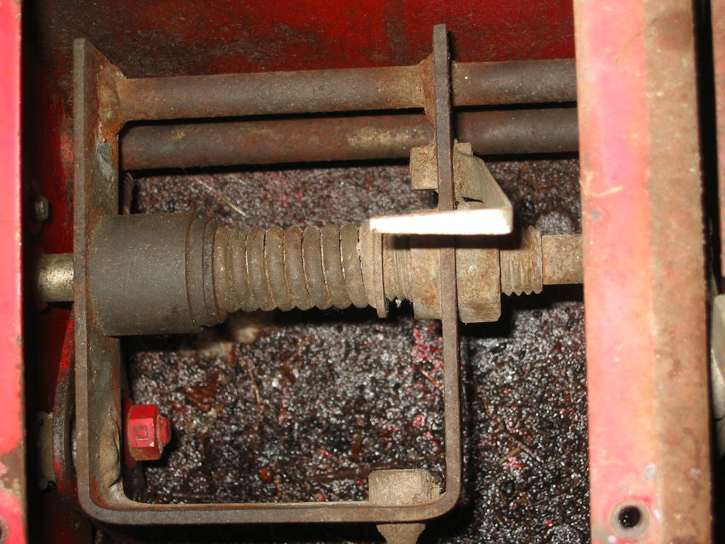

wheelhorse66 10 #5 Posted March 13, 2018 Ok thank yaw very much.the guy that had it said he put another pump on the transaxle.and had the tractor in a 100 peices.geting every thing back together.how does the hydro link hook up to the lever that makes it move?need a pic if any body has one. Share this post Link to post Share on other sites
wheelhorse66 10 #7 Posted March 13, 2018 Thanks this will come in handy I’ve never had a hydro 1 Share this post Link to post Share on other sites
