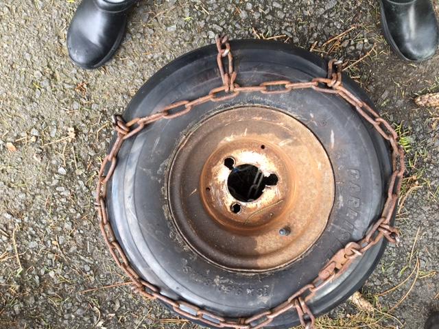

HowieE 0 #1 Posted March 10, 2018 The rear wheel on my Lawn ranger sheared off the hub while I was plowing snow 2 days ago. I need suggestions on where to find a rear wheel or even better how to describe it for a more modern replacement . The tire size is 18 9.50 8NHS 1 Share this post Link to post Share on other sites

SylvanLakeWH 29,452 #4 Posted March 10, 2018 Wow! That looks weird...Were the lugs loose? Rusted out rim? Share this post Link to post Share on other sites
cpete1 332 #5 Posted March 10, 2018 (edited) Maybe some one in your area could weld in new metal, even maybe washers. Its not like its a high speed application . Try talking to somebody at a body shop. I don't think it would be too expensive. I looked closer at your picture. I think the irregularity of your tire chains might have contributed to the failure. Good luck to you regardless, hope you find a fix. Edited March 10, 2018 by cpete1 1 Share this post Link to post Share on other sites
littleredrider 409 #7 Posted March 10, 2018 Get a set of 1" hubs and some 5 lug wheels. if not, like the others said, it can be welded.... 1 Share this post Link to post Share on other sites
