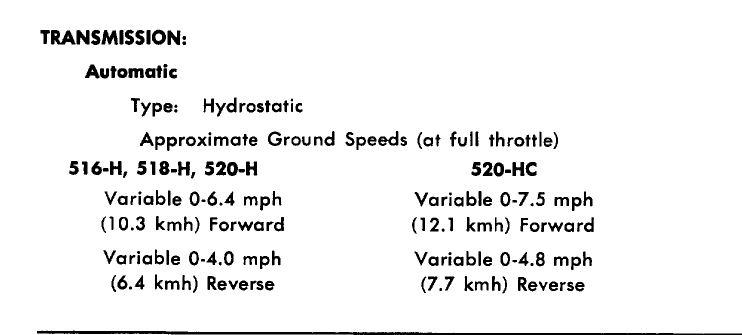

Skipper 1,790 #1 Posted March 8, 2018 (edited) Hi guys I need your big minds to figure this out. I know it is doable, just not what parts I need. I want my C195's to run faster for commute between jobs, and the solution is among other things, an HC conversion. Since I am in Europe, it would be a lot easier to ship only the needed parts, and not whole doner units. So, a shopping list for all things needed to convert the C195 hydro unit / rear end into HC spec, is what I need. Hope someone will spill the beans on this one, Oh and if someone knows how much faster it will get, that would be great too And if any of the people that has done this before could enlighten me on the pros and cons, that would be great too. Thanks Edited March 8, 2018 by Skipper 1 1 Share this post Link to post Share on other sites

Skipper 1,790 #5 Posted March 9, 2018 (edited) Actually is does more i think, it also feels that way. I have several 8 speed and hydros of C and 300 and 400 series, and all are considerably slower than the C195. This is the math as far as I can tell from available data. The wheels turn the same revs as the 520 trans (or any other comparable hydro trans) as far as I can figure out, but it runs on 27" standard. Which in effect should make the C195 std. run 7.5 just like the HC on 23" So if we go with the HC trans figures of 7.5 on 23", that makes for a 17.5% increase over the H trans. Then we go with the 27 tires, which also ads 17,4%, it should be achieving a total of 8.8 mph. Just standard C195 with the HC conversion. Now, if we go from 23" to 31" tires, there will be an extra 34.8% over the 7.5 mph. that makes for 10.11 mph, and that is in total an increase of roughly 35%, for a C195 with HC conversion and 31" tires. Now could we safely increase the rpms of the hydro, we might get close to the 50%, but let's see what the jury says on that first. Could we push it to 4000 rpm, that would make for an accumulated total of 50% increase, or 11.23 mph (18.1 km/h). That would make a heck of a difference between jobs, or a lover rpm commute. Heck, even the 10.11 mph is a really good speed. Please anyone with experience, chime in please. Edited March 9, 2018 by Skipper 2 Share this post Link to post Share on other sites
