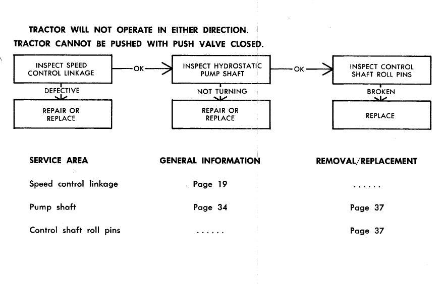

Sarge 3,470 #2 Posted March 8, 2018 I'd start by getting the Sundstrand manual and go through the diagnostic section. Read up on the acceleration valves as most times they are at fault. It helps to know what year and model GT14 you have, the transmission pumps can differ depending upon year/model. Sarge Share this post Link to post Share on other sites
pfrederi 18,776 #3 Posted March 8, 2018 (edited) From the manual Sarge mentioned...i am thinking linkage or control shaft pins given the 3 point works and the unit used to creep (bad neutral adjustment) Edited March 8, 2018 by pfrederi Share this post Link to post Share on other sites

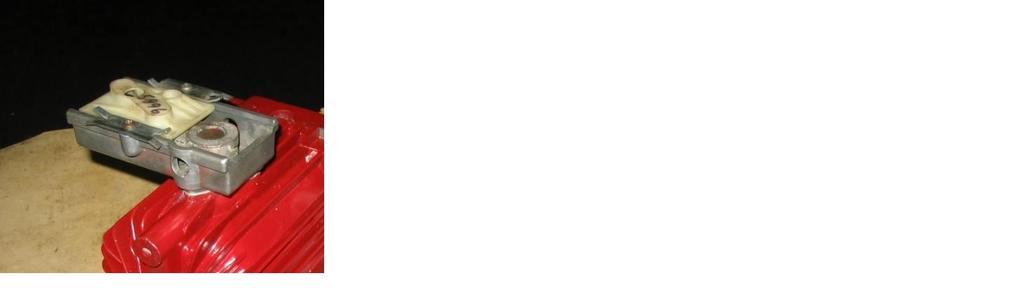

953 nut 60,730 #4 Posted March 8, 2018 Couple of thoughts here. Check out page 6 of this manual. Sunstrand Hydro (part 4).pdf The other thought is the plastic Cam could have broken. Let us know what you find. Share this post Link to post Share on other sites
