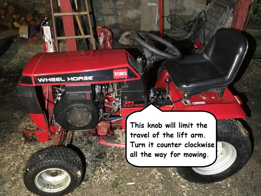

953 nut 60,776 #2 Posted March 7, 2018 Is the height adjustment nut tightened all the way? This will prevent the implement from lowering. Share this post Link to post Share on other sites
Rideawaysenior 28 #3 Posted March 7, 2018 No, no. The dial a height is adjusted to allow full travel. There is definitely an issue with the lift arm connecting with the trunion shaft. Share this post Link to post Share on other sites
