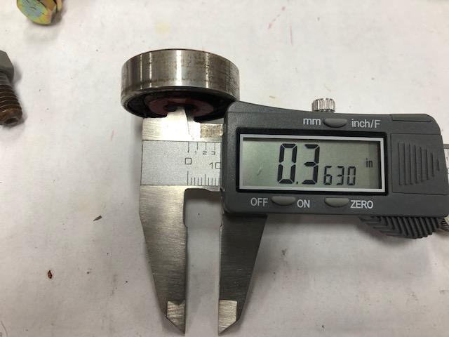

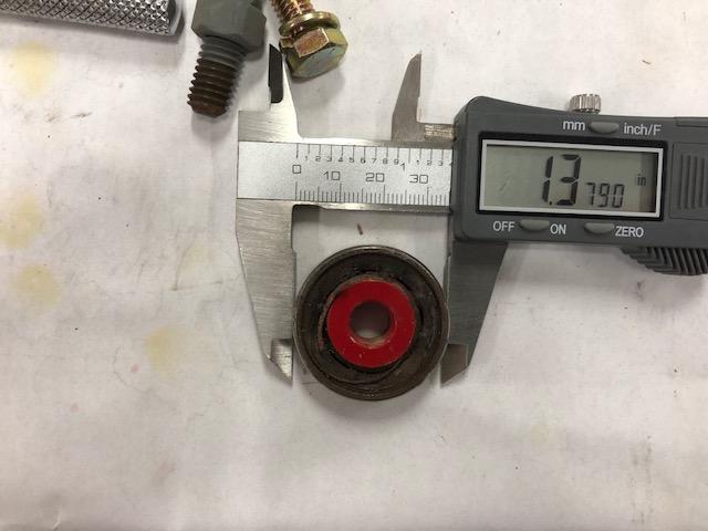

ezeastside 93 #1 Posted March 6, 2018 I am having trouble finding the bearing for the machine mounted deck pulley on my 1077. The parts breakdown only shows the part # of the whole pulley (1623) but its a cast pulley and the bearing pressed out easy. From what I can tell the bearing should be .375" x 1.375". I found the new replacement pulley on line for $54 ouch!! Any direction would be appreciated!! ED Share this post Link to post Share on other sites

Sarge 3,465 #3 Posted March 6, 2018 If you have a micrometer or good pair of calipers you could search for a replacement dimensionally. Sarge Share this post Link to post Share on other sites

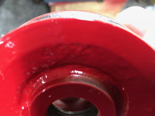

ezeastside 93 #8 Posted March 7, 2018 Thank you for all the suggestions. Although the parts breakdown for the pulley says it is part # 1623, the pulley itself has 4974 stamped on it. I don't have a micrometer only a inexpensive set of calipers. I still think the bearing is as I mentioned .375 ID and 1.375 OD I have searched over the web in several places and even went to Napa and another local auto parts store with no luck. Still as suggested by rideaway I could try EB Atmus. I am hoping to keep the cast pulley for originality but I see I have the option from Wheelhorsman. I have some time yet to procure as the deck is next after the restore of the tractor is finished. Hopefully I will post a full resto soon. 1 Share this post Link to post Share on other sites
