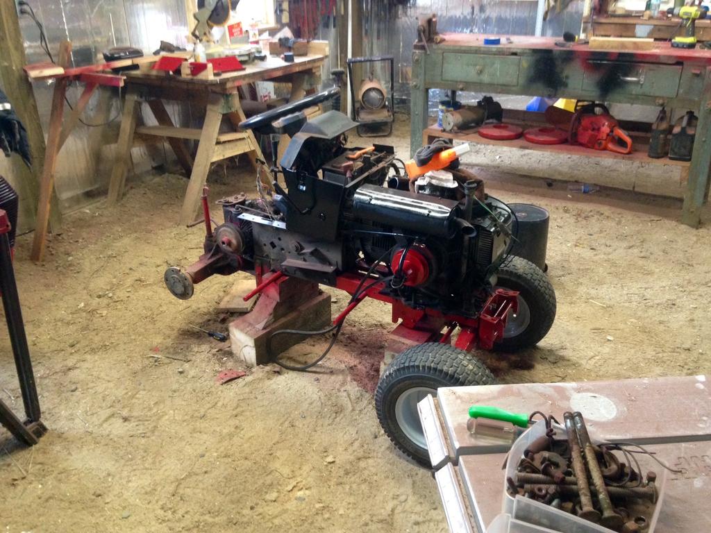

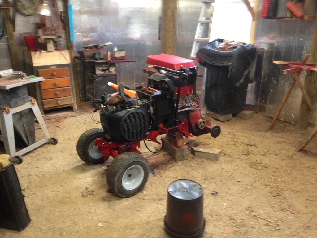

Evil Archer 300 76 #1 Posted February 28, 2018 I'm restoring a 518-H. It has the Eaton 700 Transaxle. I have located a Gentleman that has a replacement 1100. He also has all the parts to turn it into a 8 speed. I have a 310-8 that I love. I'm seriously considering making the change. What are your thoughts. I live on hilly property, The Tractor will be used for mowing and snow removal 3 Share this post Link to post Share on other sites
953 nut 64,115 #2 Posted March 1, 2018 I would go with the 1100. If you go to the eight speed you will be giving up the hydraulic lift. Unless you installed an electric lift from a 417-8 (hard to find) you would have to change the whole lift lever/rock shaft as well as the clutch and brake system. As tough as an Eaton 1100 is I can't see going to the eight speed. This was my first winter plowing snow with a hydro (418-C) and i have become a fan of hydros. 4 Share this post Link to post Share on other sites
WVHillbilly520H 10,378 #3 Posted March 1, 2018 For mowing and blowing hydro all the way, but then again I use my 520H for everything, Jeff. 2 Share this post Link to post Share on other sites
Jerry77 1,218 #4 Posted March 1, 2018 2 hours ago, Evil Archer 300 said: I have located a Gentleman that has a replacement 1100. By all means, go with the 1100 and leave the rest - you won't regret it and it is an easy swap...forget the 8 speed...... 2 Share this post Link to post Share on other sites
Ed Kennell 44,864 #5 Posted March 1, 2018 Try a foot controlled hydro with hydraulic lift for plowing or blowing snow and you'll never go back to shifting gears. 4 Share this post Link to post Share on other sites
