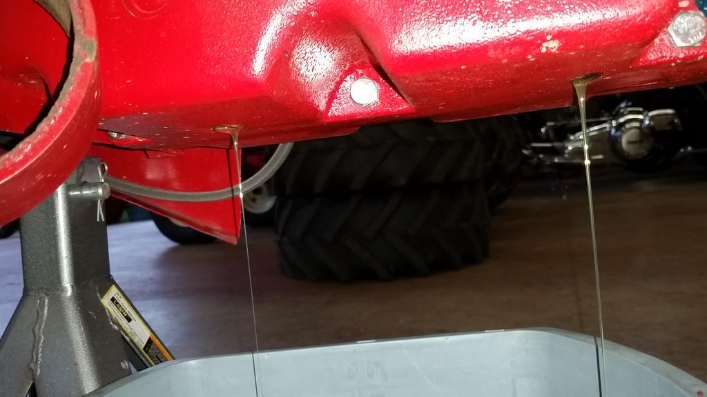

953 nut 64,275 #6 Posted February 27, 2018 When draining your transmission you will want to jack up the front end to ensure complete draining of the old fluid. The transmission case has a hump in the bottom that will trap the old fluid. 1 Share this post Link to post Share on other sites
WHX?? 55,190 #7 Posted February 27, 2018 39 minutes ago, 953 nut said: transmission case has a hump in the bottom Not mine Richard! 2 1 Share this post Link to post Share on other sites
