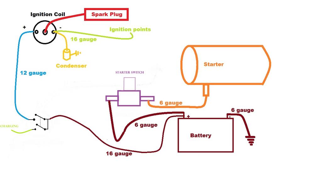

ebinmaine 77,128 #1 Posted February 26, 2018 On the c-160 somebody replaced the o e ignition key switch with a garbage trash crap aftermarket one. It's not very old at all and already the back plastic pass spins some in the front metal case. I don't really have security concerns here and I do have a 30 amp on off single pole single throw switch. Are there safety concerns with running the tractor system voltage through that switch and then just installing a starter button? I do have an old fog lamp relay I could wire in if necessary. I will not be using any incandescent hi draw lamps on this tractor. 1 Share this post Link to post Share on other sites

953 nut 63,986 #8 Posted February 26, 2018 You will want to get a double pole single throw switch to take care of the ignition and charging. 4 Share this post Link to post Share on other sites
ebinmaine 77,128 #9 Posted February 26, 2018 23 minutes ago, 953 nut said: double pole single throw switch Seems reasonable to me.... How about a 35 amp single pole, single throw switch feeding into a 5 or 10 slot junction/fuse holder? I could then feed voltmeter, coil, the lead to the starter switch, a couple sets of LED lights or whatever... ? In your awesome schematic you have the starter switched through the heavy gauge wire. I was going to put the switch through the existing light gauge wire that goes to the small terminal of the solenoid. Should work, eh? Share this post Link to post Share on other sites
squonk 45,408 #10 Posted February 26, 2018 Yes that will work as the solenoid will act like a relay and handle the current 2 Share this post Link to post Share on other sites
953 nut 63,986 #11 Posted February 26, 2018 24 minutes ago, ebinmaine said: How about a 35 amp single pole, single throw switch feeding into a 5 or 10 slot junction/fuse holder? I could then feed voltmeter, coil, the lead to the starter switch, a couple sets of LED lights or whatever... ? You need the double pole switch. Once the engine is running and the charging system is operating if you turn off the single pole switch the charging system will continue to feed the ignition coil and it will continue to run. 27 minutes ago, ebinmaine said: In your awesome schematic you have the starter switched through the heavy gauge wire. I was going to put the switch through the existing light gauge wire that goes to the small terminal of the solenoid. Should work, eh? Didn't know you were keeping the solenoid, yes a light duty momentary switch will be fine. 1 Share this post Link to post Share on other sites
ebinmaine 77,128 #12 Posted February 26, 2018 31 minutes ago, 953 nut said: You need the double pole switch. Once the engine is running and the charging system is operating if you turn off the single pole switch the charging system will continue to feed the ignition coil and it will continue to run. Gotcha. I wondered how I'd killitt without just yankin' wires.... 1 Share this post Link to post Share on other sites

ebinmaine 77,128 #15 Posted February 27, 2018 (edited) 7 hours ago, WHX14 said: ...just let em go till they run out of gas! A bit more time consuming but effective. 1 hour ago, OILUJ52 said: Why switch the charging circuit? I'm NO expert but I do know you need to cut the curcuit between regulator and coil or it won't shut off. My thought is: What is the non-hot terminal of a manual switch connected to? Is the ignition switch ONLY a connector between Regulator, coil, lights, etc. .. can the single pole switch connect regulator on one terminal to battery, coil on the other? Edited February 27, 2018 by ebinmaine Share this post Link to post Share on other sites
953 nut 63,986 #16 Posted February 27, 2018 2 hours ago, ebinmaine said: Is the ignition switch ONLY a connector between Regulator, coil, lights, etc. .. can the single pole switch connect regulator on one terminal to battery, coil on the other? You could make it look like a NASCAR dash and have a separate switch for everything. 2 hours ago, ebinmaine said: What is the non-hot terminal of a manual switch connected to? If you have an "A" terminal it can go to charging and lights. 3 hours ago, OILUJ52 said: Why switch the charging circuit? If you don't switch off the charging and it is connected directly to the battery there will be a parasitic draw that will kill the battery. 1 Share this post Link to post Share on other sites
