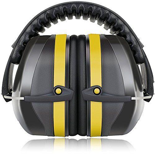

ol550 844 #26 Posted March 2, 2018 Or get a pair of these and they all sound pretty much the same. 3 Share this post Link to post Share on other sites
