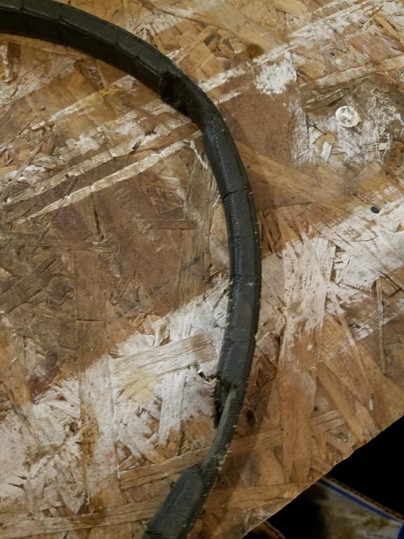

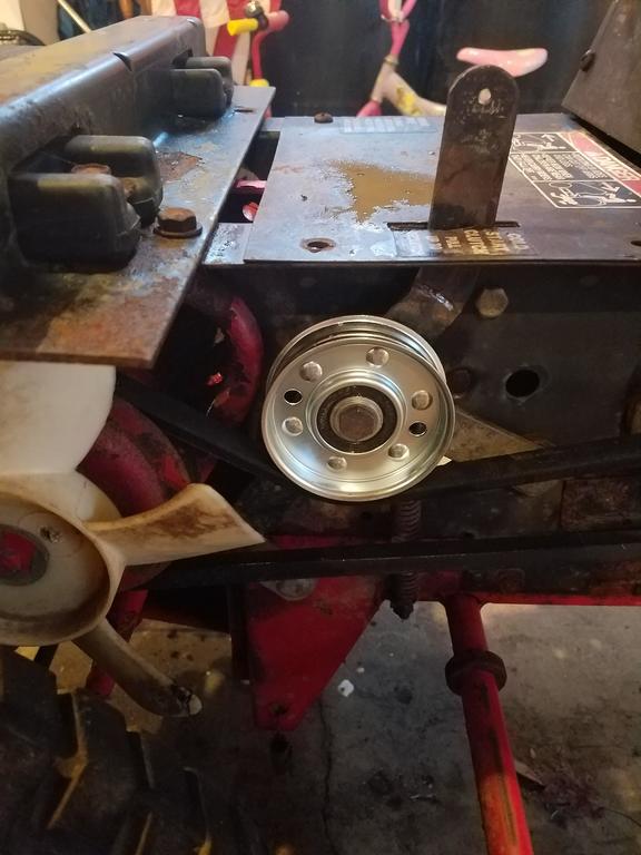

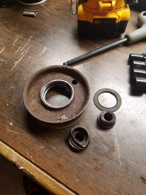

MAD MARK 74 #1 Posted February 25, 2018 I recently stumbled onto a 314-H that came with plenty add ons. Good deal so far getting better seeing it run right. Had a weird sound, almost ghastly when starting it up and riding around. Starting working on it fixing this and that, went to change out the belt cause I knew it needed a new one, and found the cold start pulley in shambles. Replaced it with new one from Rural King and now the belt is nice and tight and the drive is less jerky. This is my first Hyrdo wheel horse and been interesting working with it. Cant wait to run the tiller with hydro, last season I did it all with manual lift and no rockshaft... 7 3 Share this post Link to post Share on other sites
JoeM 9,622 #2 Posted February 25, 2018 That PO got his moneys worth out of that pulley! 1 1 Share this post Link to post Share on other sites
953 nut 64,151 #3 Posted February 25, 2018 (edited) My 418-C had an idler pulley that looked like that and it killed the belt. I picked it up for next to nothing because the PO thought the transmission had quit working. Edited February 25, 2018 by 953 nut Share this post Link to post Share on other sites
Pollack Pete 2,273 #4 Posted February 25, 2018 I keep a few of those pulleys and mounting hardware in my spare parts box.Seems like a common part to wear out. Share this post Link to post Share on other sites
MAD MARK 74 #5 Posted February 25, 2018 7 hours ago, Pollack Pete said: I keep a few of those pulleys and mounting hardware in my spare parts box.Seems like a common part to wear out. I'd love to keep some of those around but going through RK this was a $25 pulley setup. Cheaper on eBay. I have to dig into the other 312-H that I got also so might be the same there. Share this post Link to post Share on other sites
