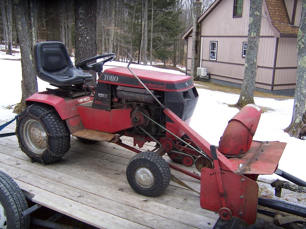

BIGMIKE 78 #1 Posted February 19, 2018 (edited) I have searched this site for information on what to look for but the more I search the more confused I get. I bought this tractor on Saturday. It currently has a snow thrower mounted and it works fine but is really small. Not even as wide as the tractor. I am watching CL for a used unit but have no idea what might fit. A tutorial on what I should look for would be greatly appreciated. One CL ad I am looking at states: "I Have it on a wheel horse 312A. Fits all wheelhorse 300,400, 500 series with tach o matic." The model number looks like 79360. Here are pictures of the thrower currently on my tractor. Edited February 19, 2018 by BIGMIKE Edit grammar. Share this post Link to post Share on other sites

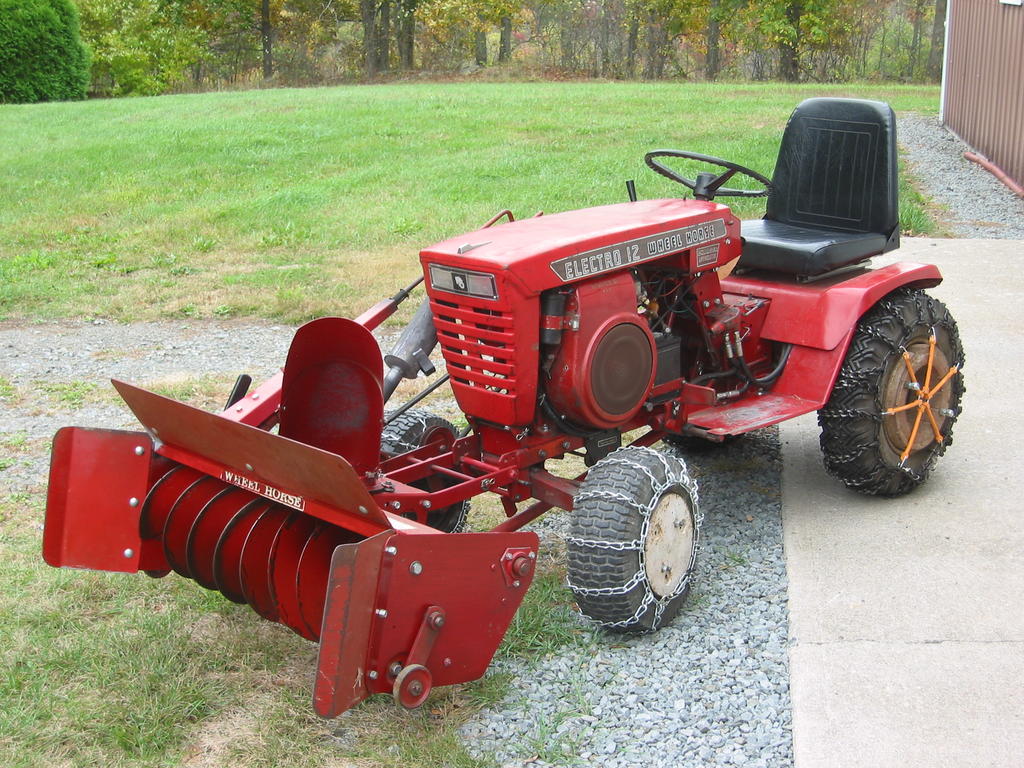

Racinbob 12,738 #2 Posted February 19, 2018 You have a correct short chute thrower but the wing extensions look wrong. The one on the 312A will fit fine as will any for a B-series from 73-77, All C's from 73 and anything for a 3-4-500 series. Share this post Link to post Share on other sites

Ed Kennell 44,787 #4 Posted February 19, 2018 (edited) Yeah, it appears the PO shortened the side wing extensions and has altered the top extension. It should look like Pauls blower. Edited February 19, 2018 by Ed Kennell Share this post Link to post Share on other sites
BIGMIKE 78 #5 Posted February 19, 2018 Wow! Thanks guys! That clears it up nicely. I will take a look at the wings and top extension and see if I can set those right. Thank you Racinbob for confirming the fitments. Thanks Ed for pointing out the changes I will need to make pfrederi: I will take you up on the offer of help if I get jammed up. Mike 3 Share this post Link to post Share on other sites
gwest_ca-(File Mod) 11,992 #6 Posted February 20, 2018 Will guess the one you have is a 32" model 6-0200-8 making it a 1973 model. Two packages were required at the time. Garry Share this post Link to post Share on other sites
BIGMIKE 78 #7 Posted February 20, 2018 23 hours ago, gwest_ca said: Will guess the one you have is a 32" model 6-0200-8 making it a 1973 model. Two packages were required at the time. Garry Thank you Gary. Excellent information. It looks like I have all of that package. Interesting to see that the side wings were not cut down after all. However the top extension, after looking at it closely, appears to be bent down to horizontal. Maybe I can bend it back up to the proper angle. Thank You; Mike 1 Share this post Link to post Share on other sites
