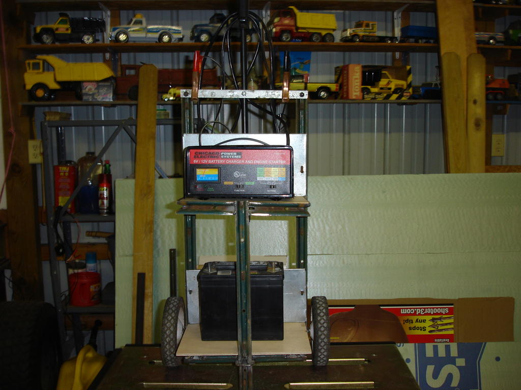

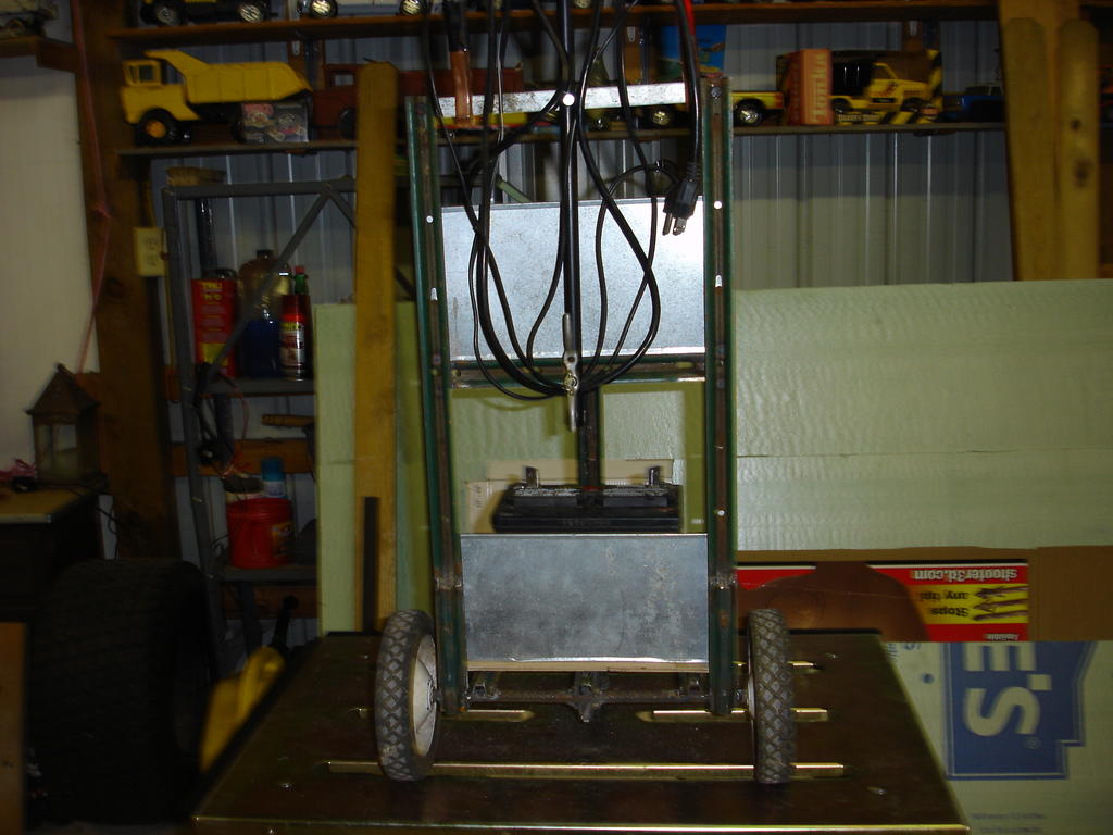

Marv 984 #1 Posted February 19, 2018 Frequently moving charger around to different tractors and finding a place to set it so the cord would reach the receptacle and battery without tripping on it, I decided something needed to be done. AHA, some used wire fence post and a couple of wheels solved the problem. Marv 17 Share this post Link to post Share on other sites
cpete1 332 #2 Posted February 19, 2018 Necessity is the mother of invention, and scrap parts is the cousin...looks like a winner Marv, but I'd put some kind of scrap rubber over the handle where you put the clamps from the charger. Just in case one forgot to unplug the charger before unhooking it. 3 1 Share this post Link to post Share on other sites
Marv 984 #3 Posted February 20, 2018 16 hours ago, cpete1 said: Necessity is the mother of invention, and scrap parts is the cousin...looks like a winner Marv, but I'd put some kind of scrap rubber over the handle where you put the clamps from the charger. Just in case one forgot to unplug the charger before unhooking it. Good point. I must do that for others. See, I never forget (smile). Some folks do though. Now back to serious stuff. What were we talking about. Marv 4 Share this post Link to post Share on other sites
