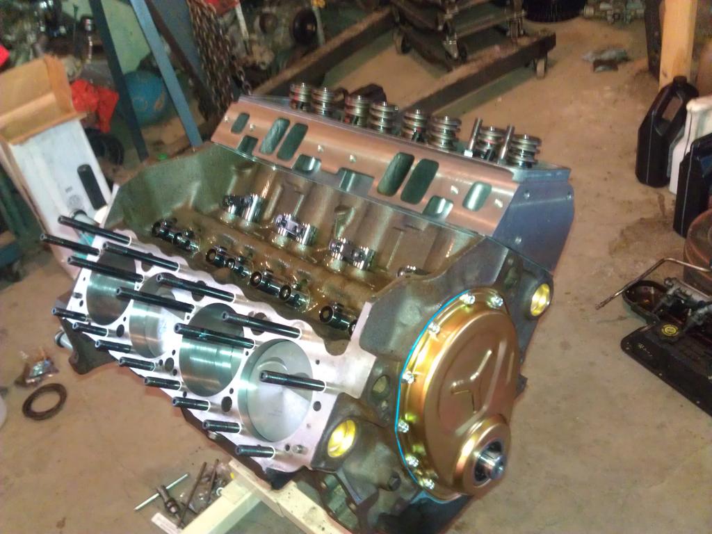

WVHillbilly520H 10,377 #11 Posted February 19, 2018 Kinda like this...red and black it might fit in with the ..., Good luck with your engine/project, Jeff. 1 2 Share this post Link to post Share on other sites
stubs 5 #12 Posted February 21, 2018 i think that would take a little more work than id like to do stuffing a sbc in. haha nice build though 1 1 Share this post Link to post Share on other sites
