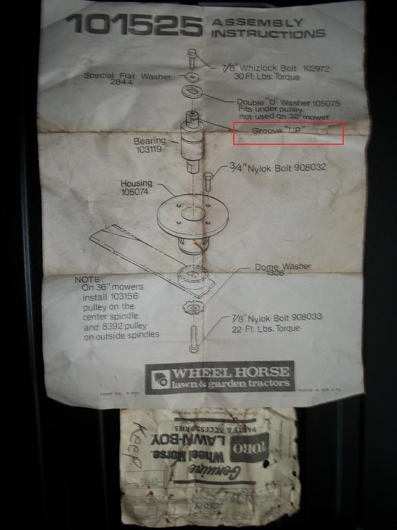

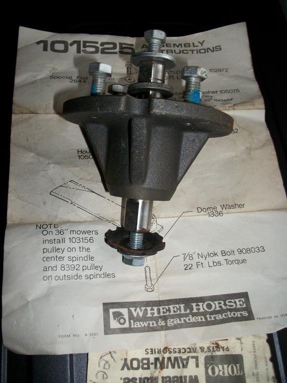

cline 0 #1 Posted February 18, 2018 Hello have a 36" sd deck off raider 12, I am installing drumb bearings and one side is longer. They measure 1 1/8 on one side and 1 1/4 on the other. Can someone say how to install into housing quilt, for I believe it will work both ways but who ever had it had them two different ways and this will throw off the cutting. Thanks ahead of time in progress right now. Mark Share this post Link to post Share on other sites
daveoman1966 3,839 #2 Posted February 18, 2018 pics here: 6 Share this post Link to post Share on other sites
cline 0 #3 Posted February 21, 2018 Wow, thanks a bunch just what I was looking for. Now just hope the new barings I ordered have the grove. Much appreciated. Share this post Link to post Share on other sites
jwalk2cc 7 #4 Posted February 24, 2018 I also am restoring a 36 inch deck and would not have noticed the "grove" if not for this post. I had to find a new 105074 housing because I foolishly drove the old bearing out the wrong direction and snapped of the end nose of the 105074 housing . Maybe my mistake will help someone avoid that. Felt like and idiot. Thank you Johnny Walker Share this post Link to post Share on other sites
