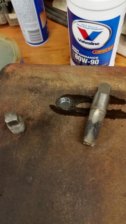

ezeastside 94 #1 Posted February 16, 2018 In the middle of a restoration on a 1077. The allen key of the sundstrand drain plug was rounded out and I had no choice but to drill it out. The 1/4" drain plug has an actual 9/16 - 18 thread. I have that tap and chased the threads out but now its still sloppy and the 1/4" plug will actually thread right into the transmission. I have searched high and low for a oversize or double oversize drain plug but can't find one in 9/16. I don't need to split the cases so I can't use one with the nut on the back side and would be concerned about room inside. My next thought is to go to 5/8 18 and try to repair this. Does anybody have a solution to this that would make my life easy? Thanks, ED Share this post Link to post Share on other sites
pfrederi 19,329 #2 Posted February 16, 2018 (edited) The drain plug hole was tapped for 1/4 NPT (National Pipe Thread) not 9/16 -18. NPT is tapered 9/16 -18 is straight thread To seal you will need tapered threads or some sort of gasket n a very short 9/16 -18 Bolt EDIT:: Drill the hole out to 9/16" then buy or borrow a 3/8NPT pipe tap (Cheapies are abut $10 good ones about $35) and thread it then get a 3/8" plug Edited February 16, 2018 by pfrederi 4 1 1 Share this post Link to post Share on other sites
R. L. Addison 300 #3 Posted February 16, 2018 The drain hole was 1/4 nptf and you put a machine thread in it. The (N)ational (P)ipe (T)apered (F)ine has a 3/4' taper per foot for the sealing surfaces of the threads. A straight machine thread will not seal because there is clearance at the "root" of the thread, and the o.d. of the thread, on a 75% thread. If I was doing I would put in a 3/8' nptf plug with the 3/8' recessed square then there is no hex to round out. Share this post Link to post Share on other sites

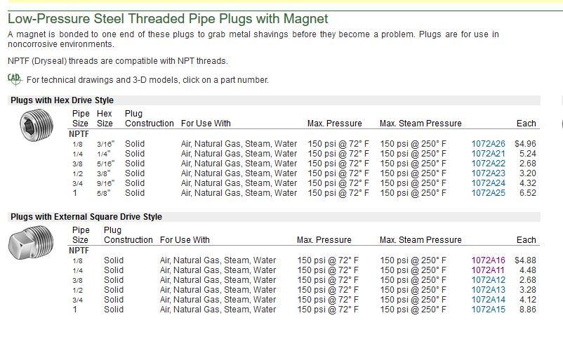

WHX?? 53,446 #4 Posted February 16, 2018 (edited) Every two piece transmission I open gets a front drain hole & magnetic plug. 3/8ths NPT. I use the square head plug and drill a 1/8" hole in it and JB well a cheapy ebay magnet in it. Edited February 16, 2018 by WHX14 4 1 Share this post Link to post Share on other sites

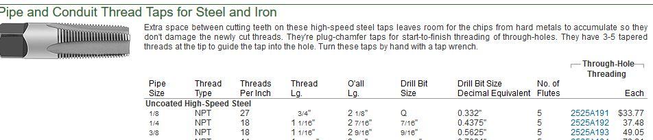

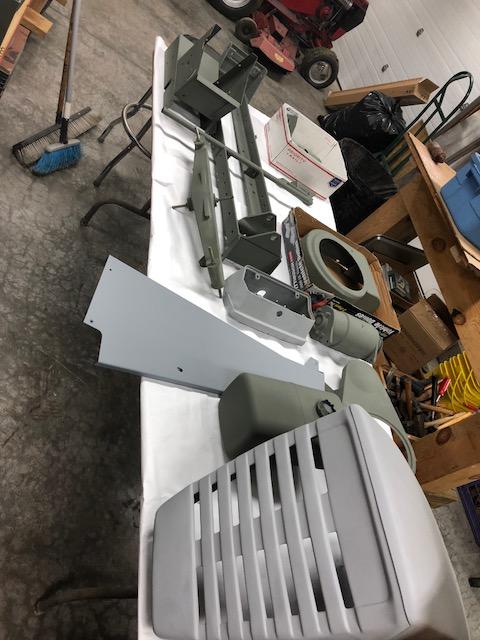

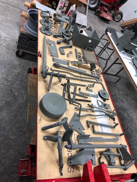

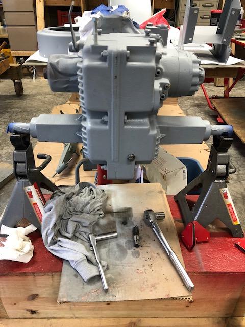

ezeastside 94 #11 Posted February 17, 2018 Thank you for all the spot on advice. I went searching for a 9/16 18 x 1/2 bolt for the easy fix but that was unobtainable locally. I was able to get my hands on a 3/8 NPT tap and stopped at the hardware store and picked up a 3/8 pipe plug. I will definitely try to get a pipe plug with the recessed square hole but at least I have something to put in for now and get this thing ready for paint. Here are the current pictures of this machine.Trying to get everything in etching primer. Final paint will be Candy Red urethane that I found in a old post from Rickv. I will do a post in restorations when I get some paint flying... if we can get some good weather. 4 1 Share this post Link to post Share on other sites
