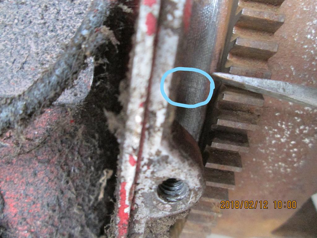

Retired Wrencher 6,537 #1 Posted February 12, 2018 These are the only marks I found on the fly wheel. I suspect this has to be in the middle of the timing hole to be in time? Share this post Link to post Share on other sites
pfrederi 20,137 #2 Posted February 12, 2018 There should be two marks. One S (Spark) and T (TDC). You want S in the center of the hole. I swear Kohler picked the 98 lb weakling to punch the marks on the wheel... They can be very very faint 1 1 1 Share this post Link to post Share on other sites
gwest_ca-(File Mod) 12,092 #3 Posted February 12, 2018 If the engine runs you can stick a length of wooden dowel in the timing hole and let it polish the rust on the side of the flywheel. The timing marks don't get polished leaving them visible. Garry 3 1 Share this post Link to post Share on other sites
Retired Wrencher 6,537 #5 Posted February 12, 2018 1 hour ago, gwest_ca said: If the engine runs you can stick a length of wooden dowel in the timing hole and let it polish the rust on the side of the flywheel. The timing marks don't get polished leaving them visible. Garry Garry I bought this with no points in the engine. It was cheap. But I can use a drill and do the same. The marks should be on the inner side of flywheel= next to the engine. Thanks. Share this post Link to post Share on other sites
Retired Wrencher 6,537 #6 Posted February 12, 2018 I found them I used a small stiff brush with a drill and found the marks. The pick with the marks is the T... 1 Share this post Link to post Share on other sites
squonk 45,893 #7 Posted February 12, 2018 rub some chalk on the flywheel then wipe it off. The marks and letters will remain white. 1 Share this post Link to post Share on other sites
Retired Wrencher 6,537 #8 Posted February 13, 2018 16 hours ago, squonk said: rub some chalk on the flywheel then wipe it off. The marks and letters will remain white. Mike do you need battery power? for this? I would have to get a battery for it if so. Share this post Link to post Share on other sites
LRE 8 #9 Posted February 24, 2018 Any time I get the chance for the flywheel being off or the blower cover off, I always paint the marks whether it be for me or the next guy. I line up the marks and take chalk and mark the outside cover for easy viewing while the engine is running and you can see the marks very easily, adjust the point gap and good to go. Far easier than trying to find the marks thought a little hole in the blower cover. 1 1 Share this post Link to post Share on other sites
