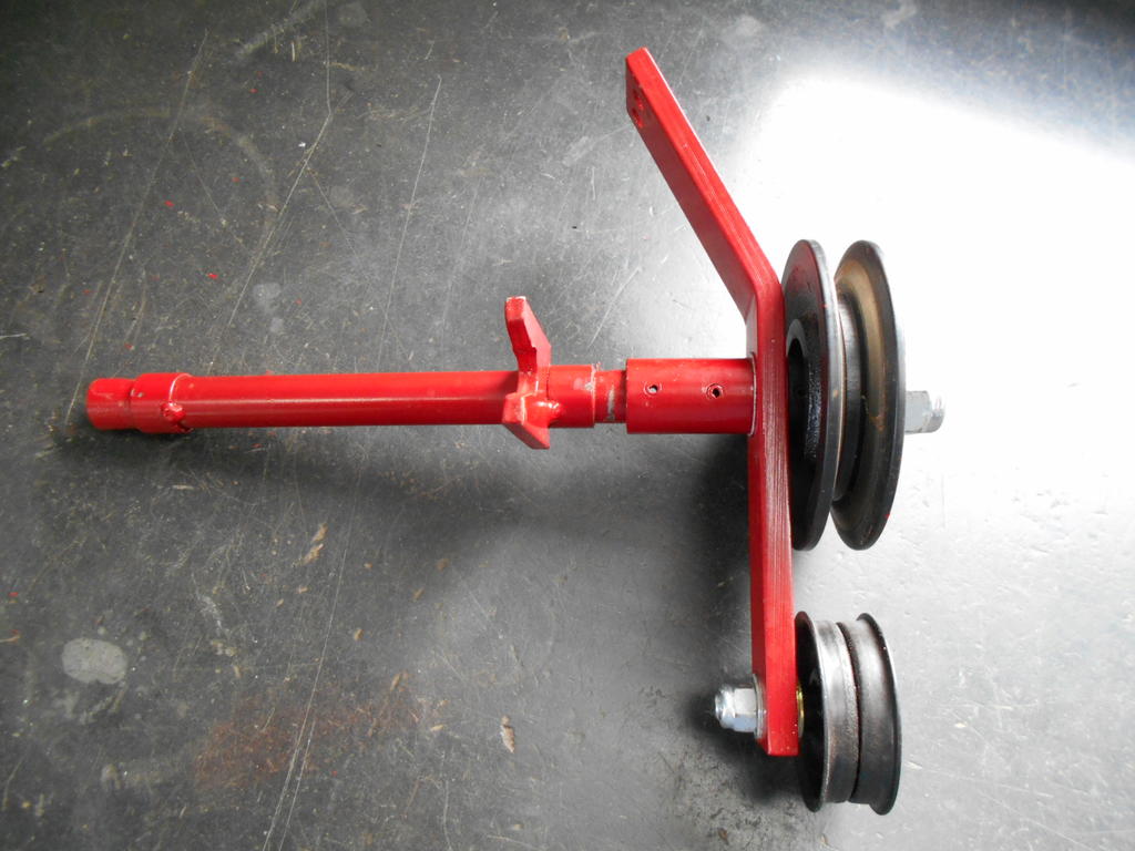

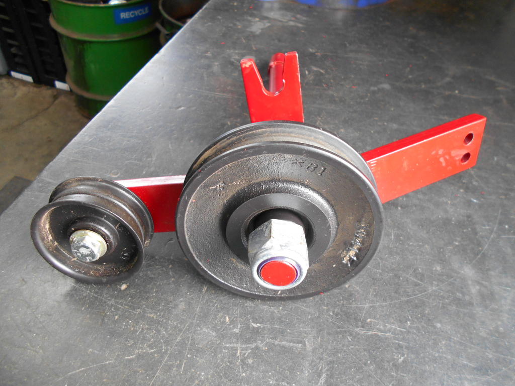

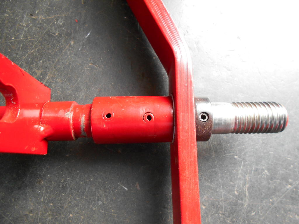

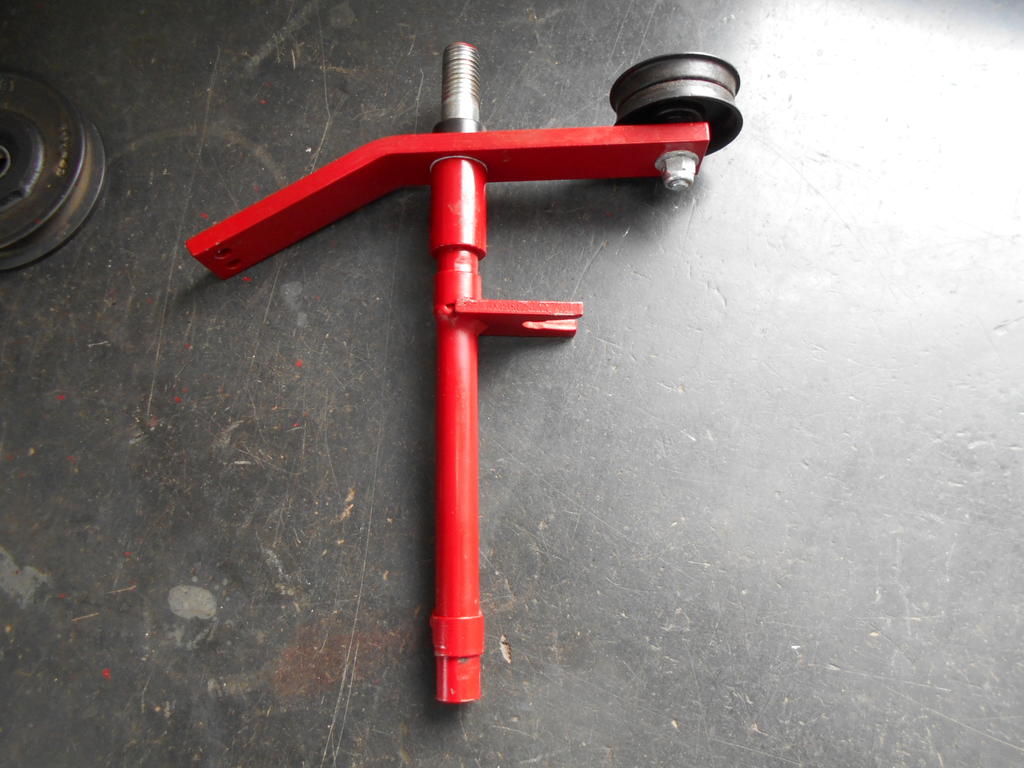

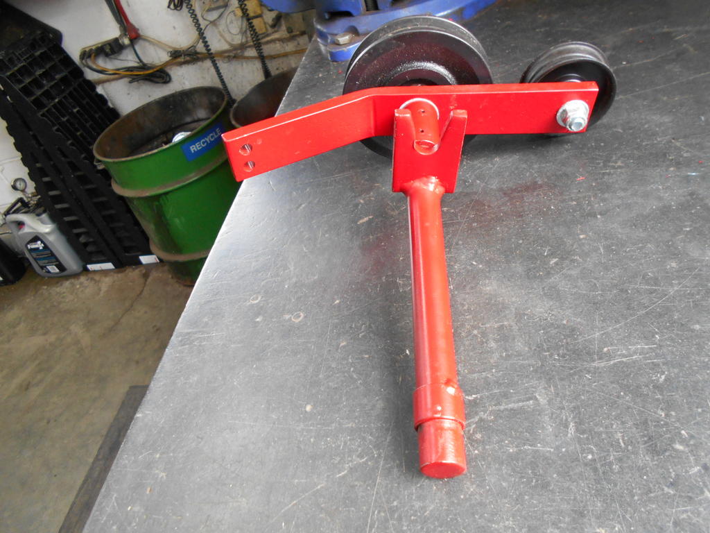

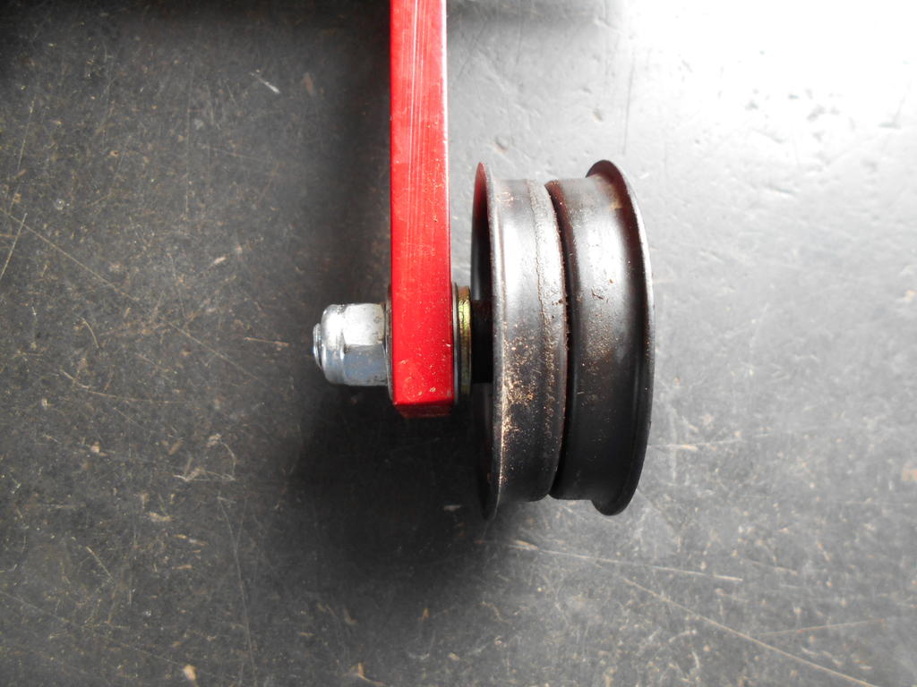

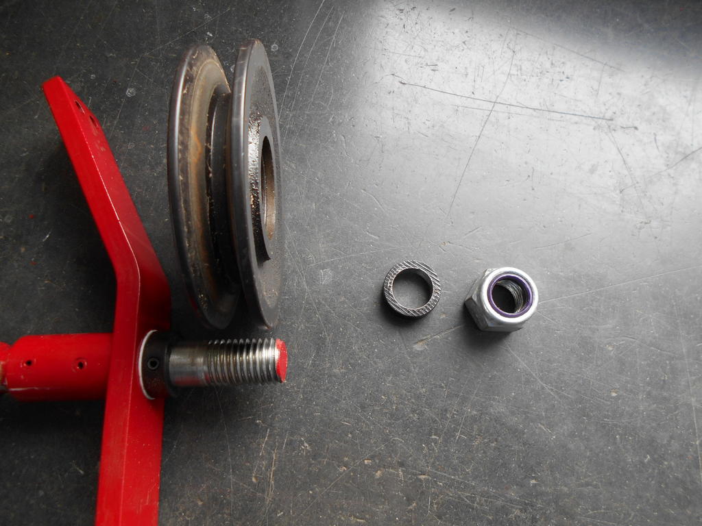

cleat 8,317 #1 Posted February 12, 2018 I thought I would try to make a tiller idler using an old deck hitch as a starting point. I used a little piece of 3/4" pipe to couple on a cut down 3/4" bolt. I think I used schedule 80 pipe but use whatever is basically a press fit. I then drilled and installed spring pins for added security. A 'V' pulley from a deck mule drive goes on the bolt. Two spacers are also made from pieces of 3/4 pipe but drilled or filed out until they are a slip fit. One has also been pinned into place. I added teflon washers for smooth operation but this is optional. This is the finished product. Here are the plans I drew up. Tiller idler plans 1.pdf Tiller idler plans 2.pdf I used a hydraulic press and 'V' block to bend the flat bar but I imagine you could heat and bend it in a vise as well. Cleat 5 8 Share this post Link to post Share on other sites
