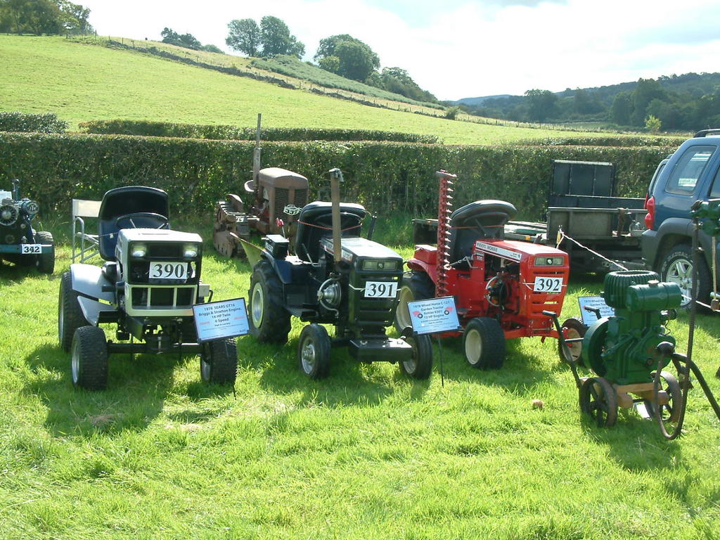

Stormin 9,987 #11 Posted February 25, 2018 For a front weight I use one off one of those gym equipment things, fitted to a modified front mule. 391. The Black Horse in the centre of the photo. Share this post Link to post Share on other sites
Tankman 3,528 #12 Posted February 25, 2018 Other than wheel weights up front, filled tires, chains, wouldn't Stormin's front weight interfere with snow plowing? Thinkin' narrower weight might work. I've used front suitcase weights when turning (plowing) earth. My first plowing a garden was fun although the front wheels were a foot above the ground. Ride 'em cowboy! Share this post Link to post Share on other sites
