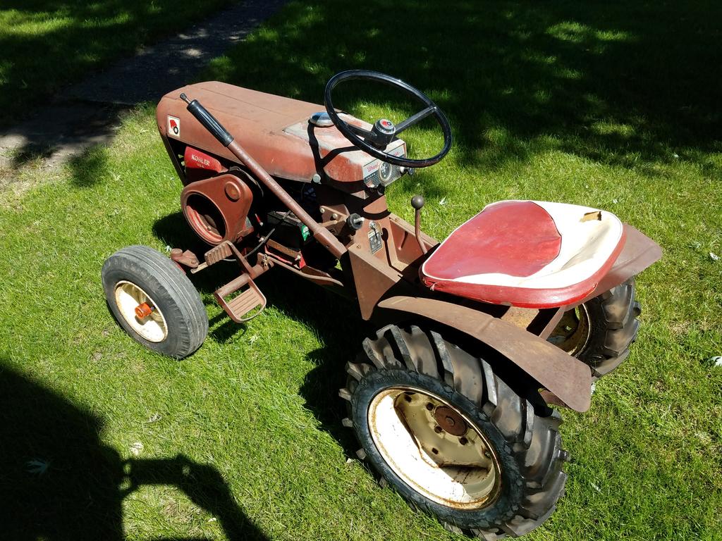

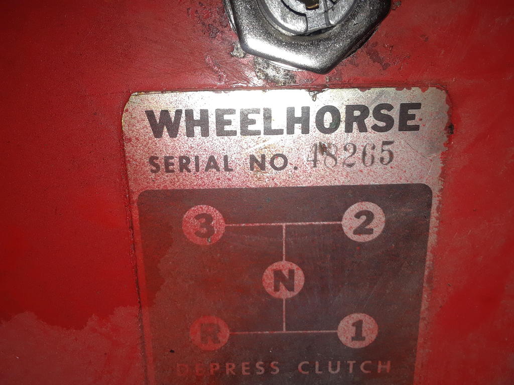

peanut437 29 #1 Posted February 8, 2018 So i actually acquired this 754 back in September. I have done quite a bit of research and I know there was only 421 produced in 1964. (753 kohler/854 frame). My question is if i go by the serial number, is there a way to tell exactly the date of when it was made? I did some looking in the forums on here but i didn't see anything or I might not be looking good enough. Either way thanks for the help in advance. I guess a serial number would help. The number is 48265. 4 2 Share this post Link to post Share on other sites

AMC RULES 37,196 #8 Posted February 9, 2018 (edited) If you scroll down the file page here... you'll see all the 754 serial #'s Garry has documented to date. Notice...your # has already made the list. Edited February 9, 2018 by AMC RULES 3 1 1 Share this post Link to post Share on other sites

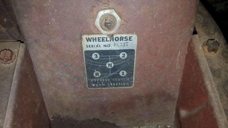

CasualObserver 3,411 #10 Posted February 9, 2018 20 hours ago, peanut437 said: there was only 421 produced in 1964 That's a common misconception due to bad math. 18 hours ago, 953 nut said: Interesting, I've always heard the production numbers don't exist Most don't... but many years ago there were a few of the limited production models that were counted in the old handwritten production ledgers. The 754 was one of them. 15 hours ago, Shynon said: Maybe @CasualObserver could shed some light on this. The true number is 48337 - 47916 +1 = 421+1 = 422 And for those who might question the math, if you start with a serial ----6 and you end with serial ----7 .... you don't end up with a quantity of --1. If you do, you either didn't count ----6 or ----7. Or think about it more simply. Serial number 1 and 2. I have two tractors.... but if I take 2-1 that says I only have 1 tractor. There has to be an addback of +1 for subtracting within the starting and ending range numbers. 48337 - 47916 +1 = 421+1 = 422 I have in the past been lucky enough to have seen the hand written ledgers at Toro and allowed to take some notes. The 754s did begin at 47916 and end at 48337. Production started May 26, 1964 and ended on June 11, 1964. They are one of the very few models that had a straight run of serial numbers. For the majority of production a variety of tractors came down the line in batches making serial numbers jump across models. 3 3 1 2 Share this post Link to post Share on other sites

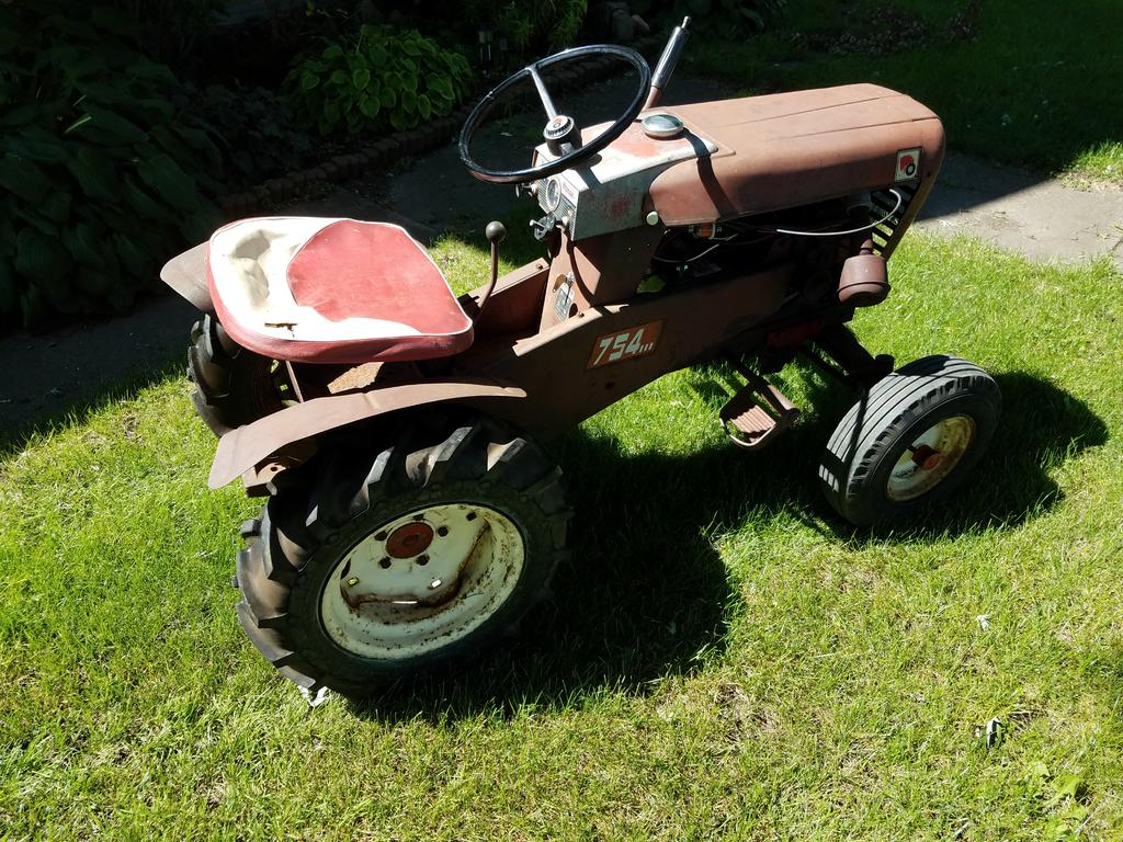

Shynon 7,479 #11 Posted February 10, 2018 (edited) 12 hours ago, CasualObserver said: The 754s did begin at 47916 and end at 48337 That's cool, I have the last 754 to be produced in original condition. Edited February 10, 2018 by Shynon Added pics 2 8 Share this post Link to post Share on other sites

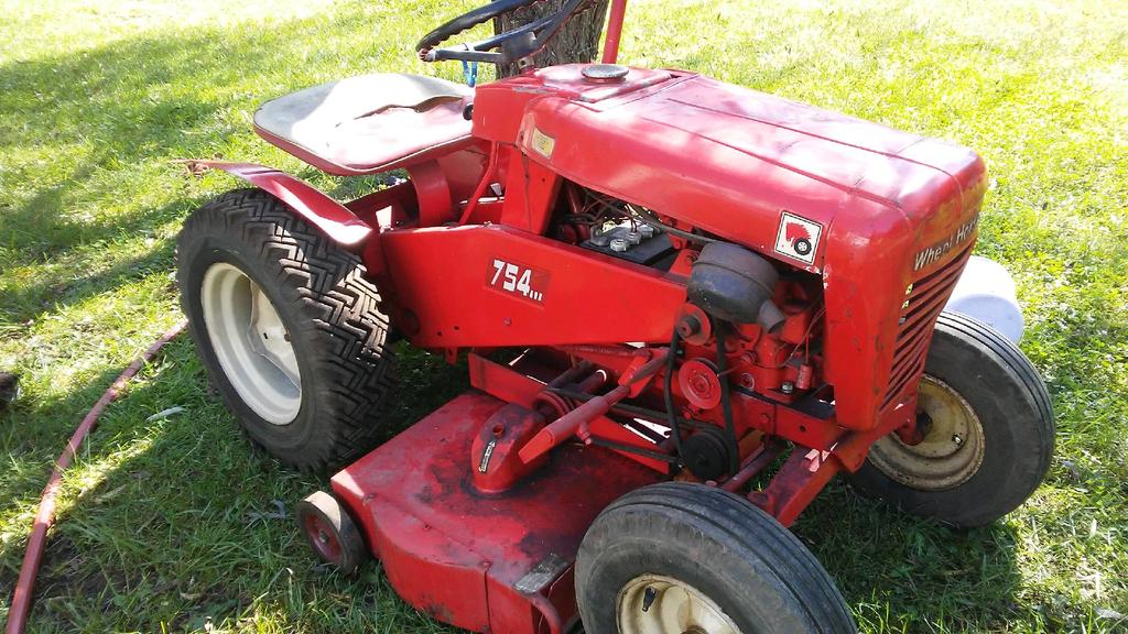

stevebo-(Moderator) 8,527 #14 Posted March 13, 2019 I finally added one of these rare birds to my collection. Not my first choice as this one was restored prior to my purchase. The number I have on the tag shows #47974. 1 3 Share this post Link to post Share on other sites
