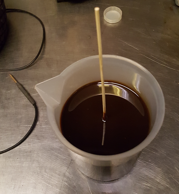

henryhpsd 127 #10 Posted February 6, 2018 U guys are just about amazing..... Last evening... I started to push the wheel horse in neutral and i actually found it to be "heavy" compared to mine. So.... from all your advice: I started to "flush" the transmission, when i removed the "bolt"...Something happend... What came out of it...I can only describe as... How a little child must feel about dessert, how she/he thinks it is....when he/she really doesnt want it. It was so thick, it actually had a little test. Last night when i got home with a sample, i put in a small wooden rod, this morning....it was still there ! After "flushing" a couple times new oil in (ill change that again) ...its much better...the owner says it never shifted that good and its easy to push hihi.. So on behalf of him .....THANK YOU ALL 2 1 1 Share this post Link to post Share on other sites
C-101plowerpower 1,606 #11 Posted February 6, 2018 geez, what was in there? appel/suikerstroop? 2 Share this post Link to post Share on other sites
Sarge 3,470 #12 Posted February 6, 2018 That looks like very old 140W oil or heavier - someone may have filled the poor thing with grease, who knows...lol. I'd pour it out in a larger and flatter pan - might see some interesting results. Hopefully, no metal flakes... Sarge 1 Share this post Link to post Share on other sites
henryhpsd 127 #13 Posted February 6, 2018 (edited) No metal ...thankfully.... I tried to put it in a pan....turned it upside down....and It remain seated ...like ketchup lol... well...almost... Now, without joking: ...there actually were a few big "bubbles"...how u say that..."behaved"...ehm... "not liquid anymore" investigated it with that wooden stick, just too make sure there wasn't metal in it. He couldn't remember if it ever was changed... It must have been in there for at least 25 years. But im happy, im not a mechanic (neither is he) but helped and improved (with forum help obvious) so...all happy ! Edited February 6, 2018 by henryhpsd 1 1 Share this post Link to post Share on other sites
stevasaurus 23,448 #14 Posted February 6, 2018 That is good news. These transmissions are pretty much bullet proof. I would use it this winter and change the oil again in the spring. 2 Share this post Link to post Share on other sites
Sarge 3,470 #15 Posted February 7, 2018 May want to flush and change it again if that stuff is that old and thick . Wouldn't even pour out of the cup ?? I'd really wonder about the condition of the engine on this poor animal - but, it does show just how insanely tough these things really are despite previous owners. I've had old small engines brought here or on equipment I dragged home that took using tools to remove the engine oils as well as transmissions - nothing can take that abuse like the older Kohler and Briggs engines or a WH transmission - even their hydro units. My 1277 had it's original filter and oil in it from day one when I got the thing almost 20yrs ago - a flush/oil change and it lived almost 2yrs before the swash plate exploded and wiped out the pump completely - not an unusual problem with the older style hydrogear units. The '66 876 from the same guy's buddy was the same way and I used that entire assembly in the 1277 since they are identical - simple flush/fill and oil changes at least once a year - it's still running perfectly despite the abuse I've put it through. There's a reason I like this brand of tractor - brutally tough and simple - can't beat that combination and the same reason I own an old Land Cruiser, lol...these things wear out their owners or just outlive them , and move on like nothing happened but some battle scars, gotta love that. Sarge 2 Share this post Link to post Share on other sites
henryhpsd 127 #16 Posted February 8, 2018 Hello Sarge ! Thanks for the advice ! I was leaning towards the same. The transmission was flushed good.... (several times) so...i also got the relative "safe" feeling for now... (as stevasaurus indicates). And it really wasnt that thick it remained seated...I was joking a bit....though it did scared the heck out of me.....i wouldnt have been suprised if it did stuck in that cup.. hihi. So Im going...as soon as he starts mowing again (thats all he does with it) ill get it to flush it again. Good thing is: He has change the oil of the engine and he does keep the battery charged and he uses a brush to get old oil on the blank spots Thats as far as he goes...dont think he changed other thinigs like the filters or Sparks or grease on the "known" points......but overall it is iin good shape. He just never looked at the transmission... Best thing is... im new into Wheel Horse, and seeing this...well...hats off..impressed...and proud to have one. ! (owh two that allready is hihi) 2 Share this post Link to post Share on other sites
