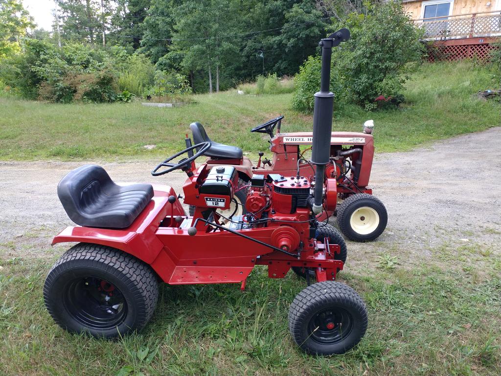

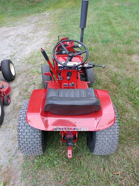

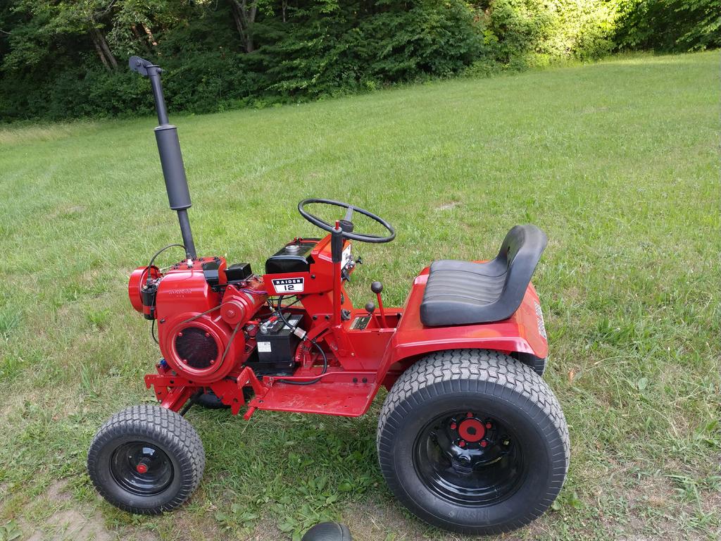

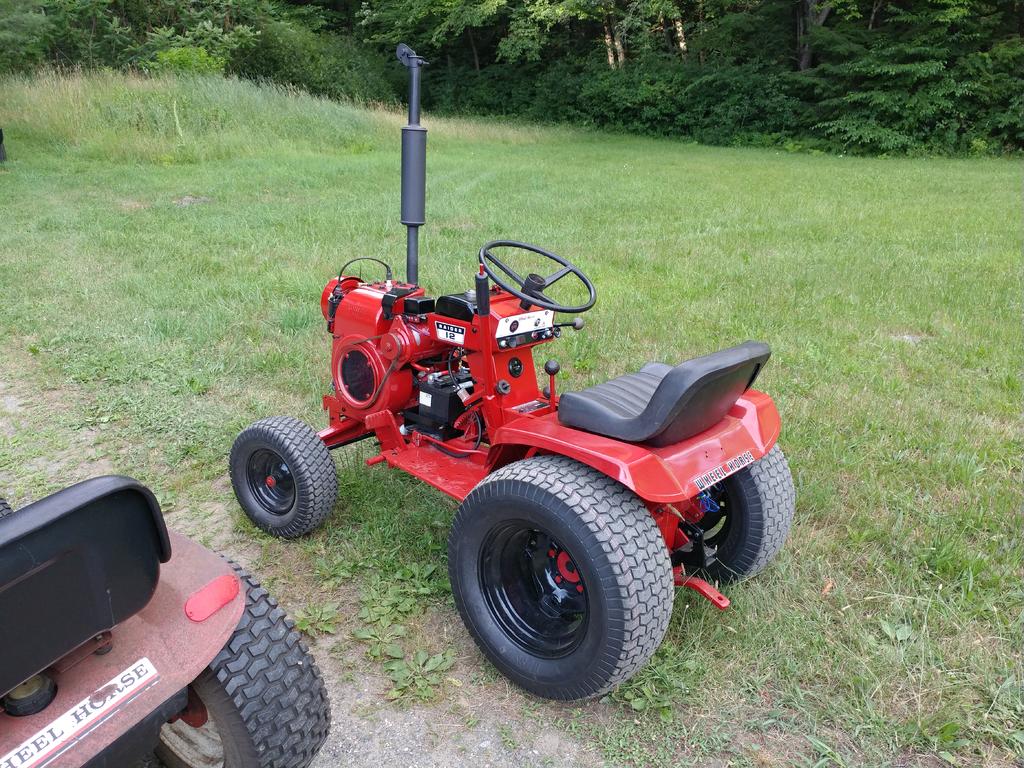

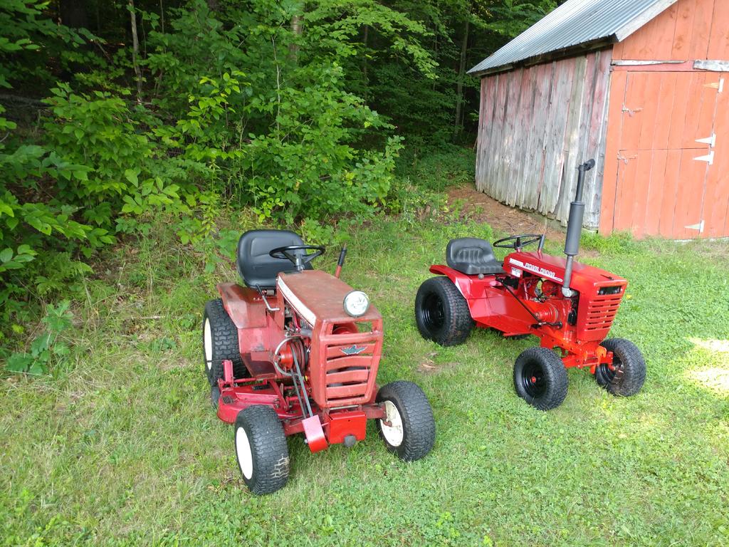

Joshn569 273 #108 Posted July 7, 2018 Finally got the fenders done and guess what... I got to drive it today for 2 hours! Got the carb adjusted and dialed in. Runs real nice. Fixed the brake band and put the old belt back on. Turns out the new belt is 1mm thicker and its just enough to not allow it to shift. May try to remove the paint from pully and see if that will work but for now she is drivable. I had the fenders powder coated. Its a different shade of red so when in direct sunlight you can tell its off a bit. Close enough lol. Still need to weld a tab on the frame for the deck lift and get the hood finished. 1 5 Share this post Link to post Share on other sites

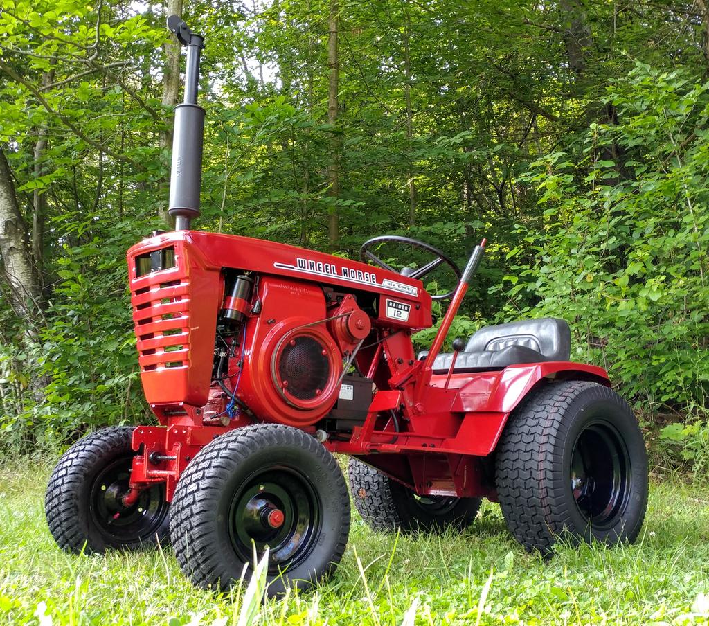

Joshn569 273 #114 Posted August 16, 2018 Still not done, but almost 10 Share this post Link to post Share on other sites
