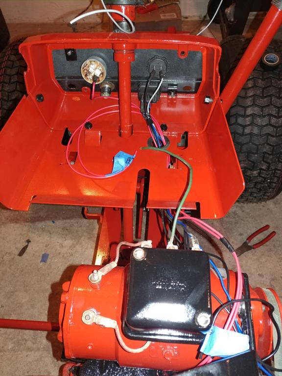

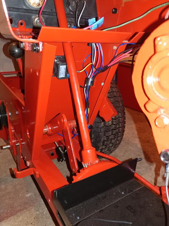

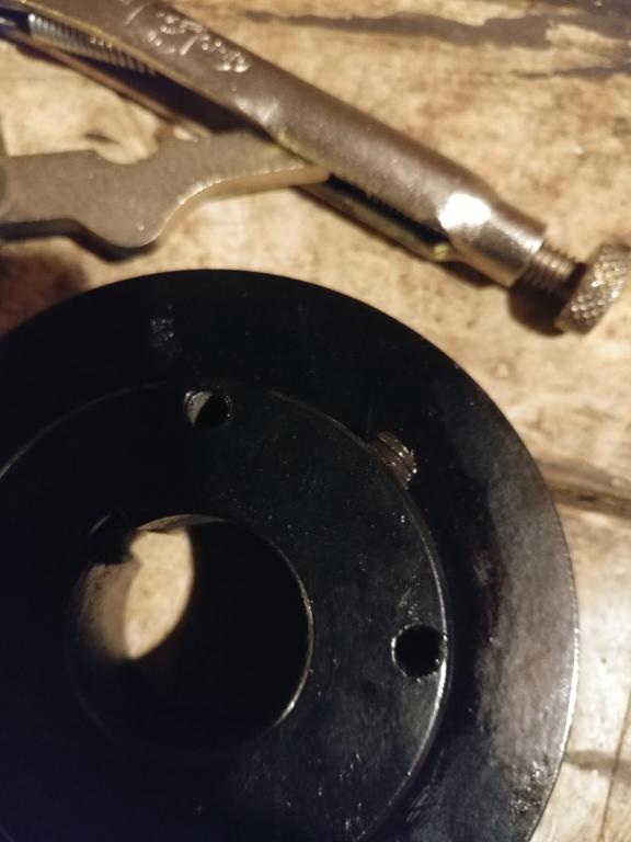

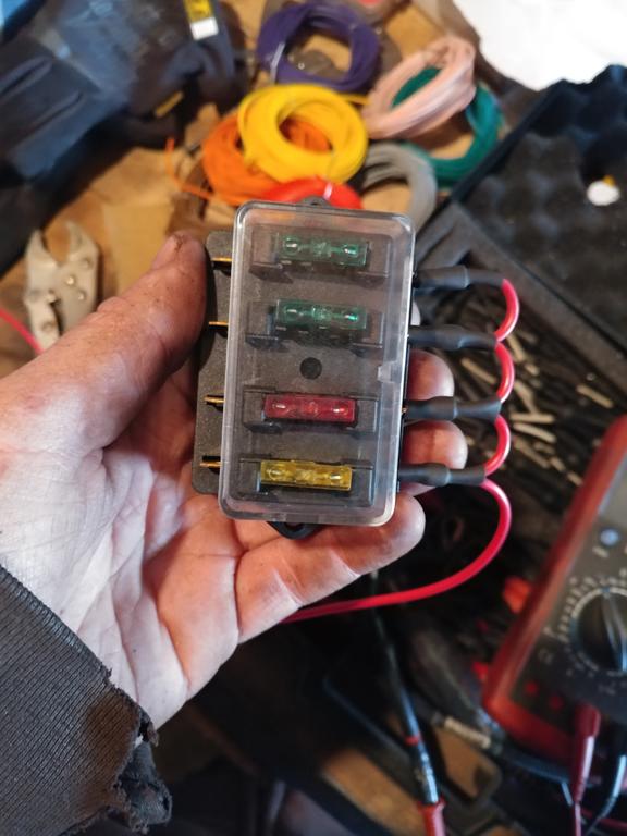

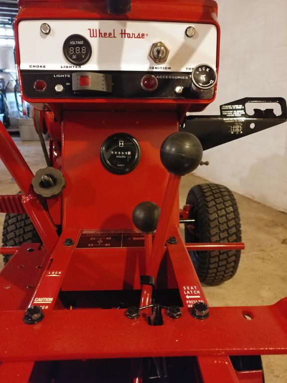

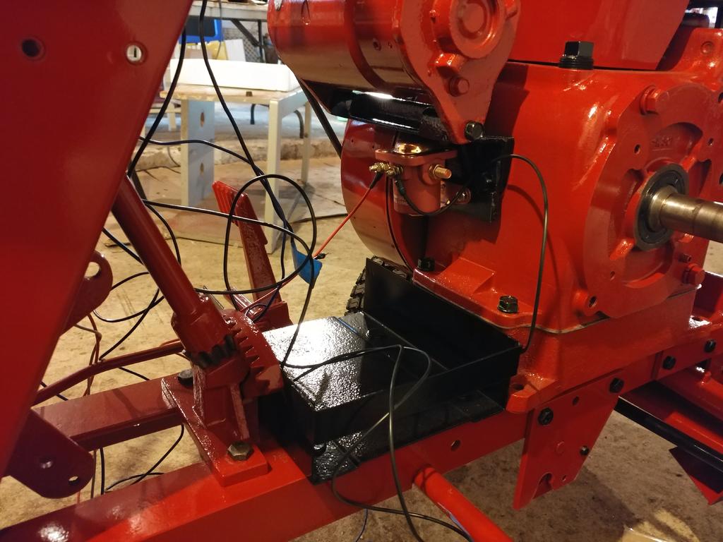

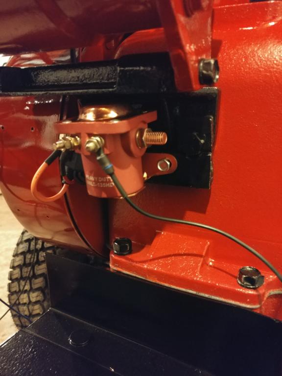

Joshn569 273 #77 Posted March 27, 2018 Got started on the wiring. Im not sure yet but I may have got the wrong ignition switch. Made a bracket to mount the start solenoid. Also put the fuses under the seat. Got to find some kind of clips to hold the wires in place and some harness tape. The middle terminal off the regulator I think went to the red light in dash. It wasnt working, but is it supposed to come on with key on then go out when charging? And The left terminal I think went to cig lighter. Is that hot all the time or only when running? When I first got this thing it had a battery cable run straight to the key switch right behind the fuel tank without any fuses anywhere so it should be a little safer now Also drilled the seized screws out of the drive pully and got some new ones.👍 3 4 1 Share this post Link to post Share on other sites

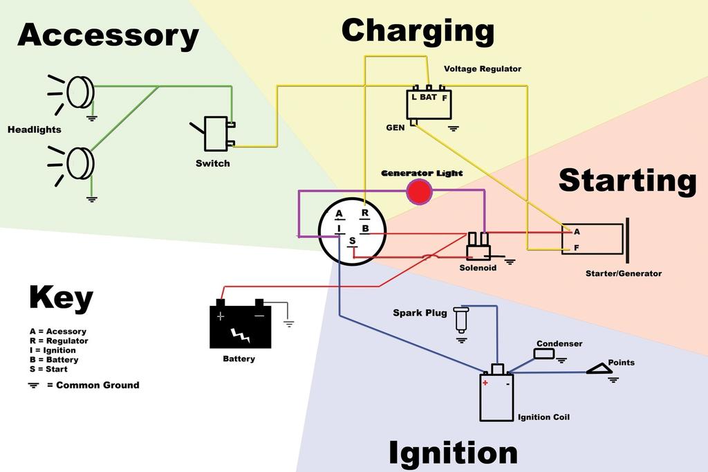

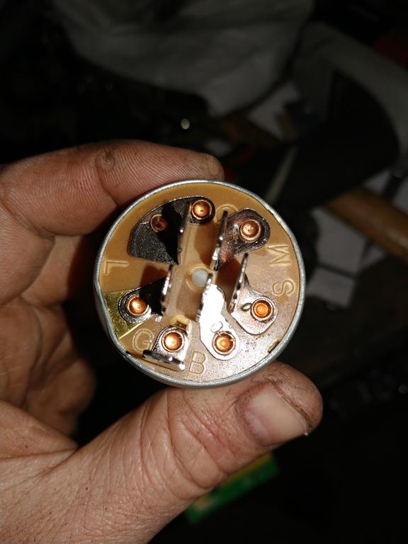

R. L. Addison 300 #78 Posted March 27, 2018 That switch has a "M" (mag. ground) terminal on it, battery run switch has "I" (ign. terminal to coil) #103990 3 Share this post Link to post Share on other sites
953 nut 67,798 #79 Posted March 27, 2018 This simple diagram may be helpful. As Mr Addison told you the switch you have is not correct. Also there are no fuses shown on the diagram, but they are strongly recommended. Your lights can come off the "A" terminal of the key switch or the "L" terminal of the regulator. 3 1 Share this post Link to post Share on other sites

Joshn569 273 #82 Posted March 27, 2018 3 hours ago, Achto said: What brand / model tires are you running on the back? The tread looks a lot like the original tires. They are Russo brand I believe. Very similar tread pattern, and a bit wider than the originals. 2 hours ago, Mike'sHorseBarn said: This is looking great! Are you using 12 or 14 gauge wire for the harness? 14 gauge mostley, its what I had 😁 running bigger stuff for the start circuit 4 hours ago, 953 nut said: This simple diagram may be helpful. As Mr Addison told you the switch you have is not correct. Also there are no fuses shown on the diagram, but they are strongly recommended. Your lights can come off the "A" terminal of the key switch or the "L" terminal of the regulator. Thanks, I have a diagram like this but didnt have the gen light in it. I will have to get another key switch. I want to run all the accessories switch powered off the key switch 3 Share this post Link to post Share on other sites

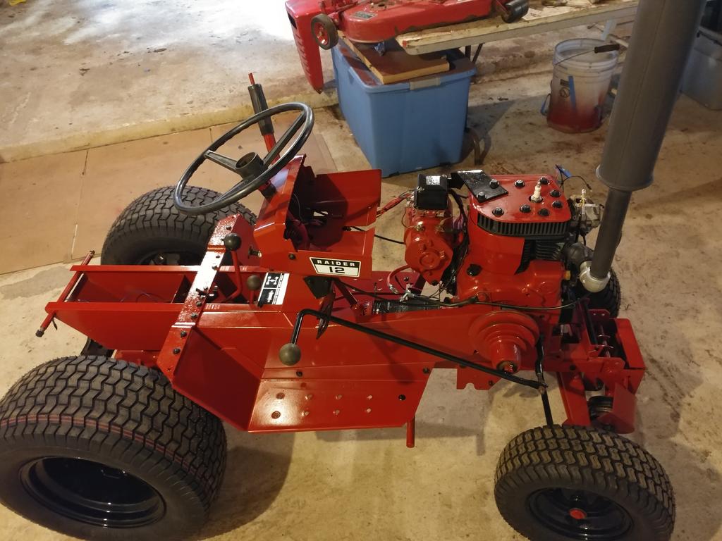

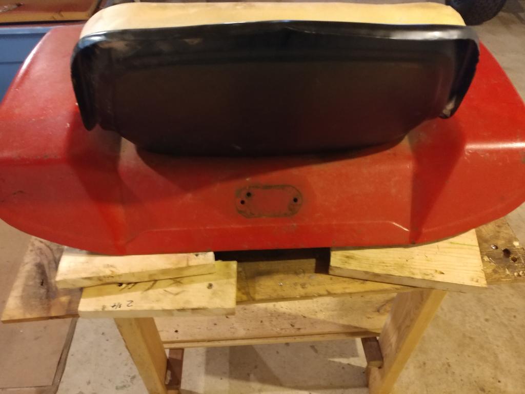

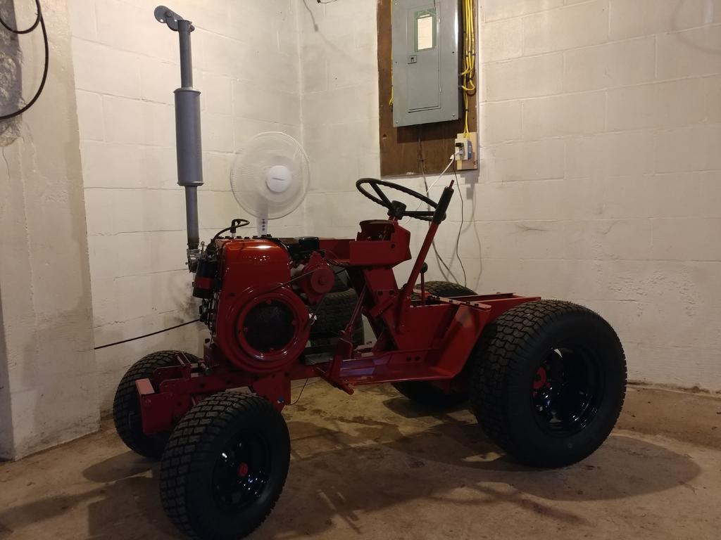

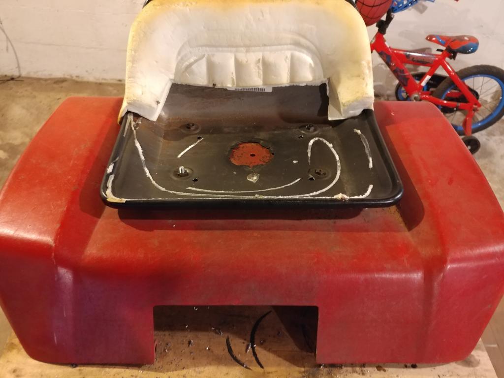

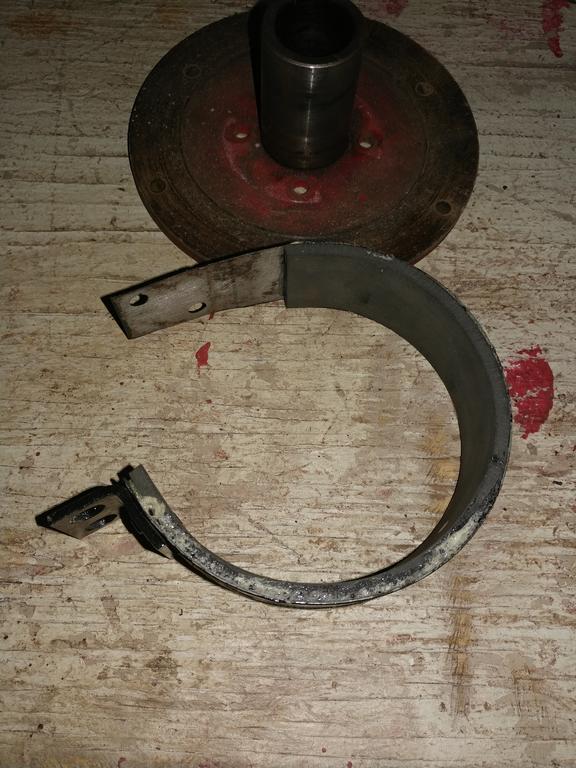

Joshn569 273 #83 Posted April 6, 2018 Started working on the exhaust. Got the wiring mostly finished up, I need to get a battery and battery cables still yet. Round 2 of the dash decal was a success 👍 Started working on fenders, there are a few dents i would like to fix. Looks like somebody at some point tryed to pick the rear end up by the fenders in the back. Ive got it pretty close to where it should be. Also drilled some new seat pan holes, previous owner didnt do a very good job there lol. I glued the new brake lining in. Used gorilla glue, although messy it worked good. I havnt searched around yet but if anyones got a pic of throttle cable routing I would appreciate it And one more question, is there a minimum thickness for the pto clutch disc? 3 Share this post Link to post Share on other sites

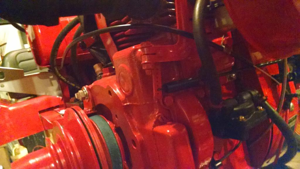

Achto 32,141 #85 Posted April 7, 2018 4 hours ago, Joshn569 said: I havnt searched around yet but if anyones got a pic of throttle cable routing I would appreciate it Throttle is the easy one. The choke cable on the other hand is the fun one. Choke cable goes over the battery, between the bearing plate and the block, then up to the choke. 1 Share this post Link to post Share on other sites

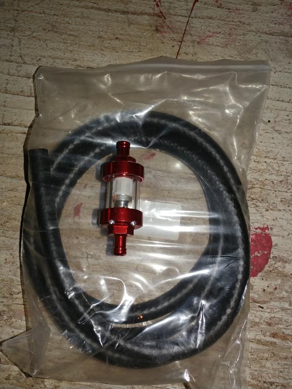

Sarge 3,473 #86 Posted April 7, 2018 Be careful with that fuel filter - I've seen a lot of those leak pretty easily, they like to loosen the two ends from vibration. Sarge Share this post Link to post Share on other sites
Joshn569 273 #87 Posted April 7, 2018 1 hour ago, Sarge said: Be careful with that fuel filter - I've seen a lot of those leak pretty easily, they like to loosen the two ends from vibration. Sarge Grade C china 10 pack fuel filters. $5.99. I have a few left over from other projects. You would think I would learn lol 1 Share this post Link to post Share on other sites
Sarge 3,473 #88 Posted April 8, 2018 I know, many folks have made that mistake. I prefer the filters directly at the fuel tank but on some models that's not really an option. For the most part, I just use good quality Wix inline plastic filters or a sediment bowl and micro screen. Reason I brought it up - have seen several vehicles with those filters catch fire, badly. The end seals leak too easily as most of the bodies are not machined correctly, typical mass produced junk goods. Sarge Share this post Link to post Share on other sites
Joshn569 273 #89 Posted April 9, 2018 13 hours ago, Sarge said: I know, many folks have made that mistake. I prefer the filters directly at the fuel tank but on some models that's not really an option. For the most part, I just use good quality Wix inline plastic filters or a sediment bowl and micro screen. Reason I brought it up - have seen several vehicles with those filters catch fire, badly. The end seals leak too easily as most of the bodies are not machined correctly, typical mass produced junk goods. Sarge I will for sure be buying a quality fuel filter. Inline petcock too, leaking fuel is seriously no joke! Share this post Link to post Share on other sites

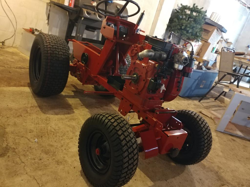

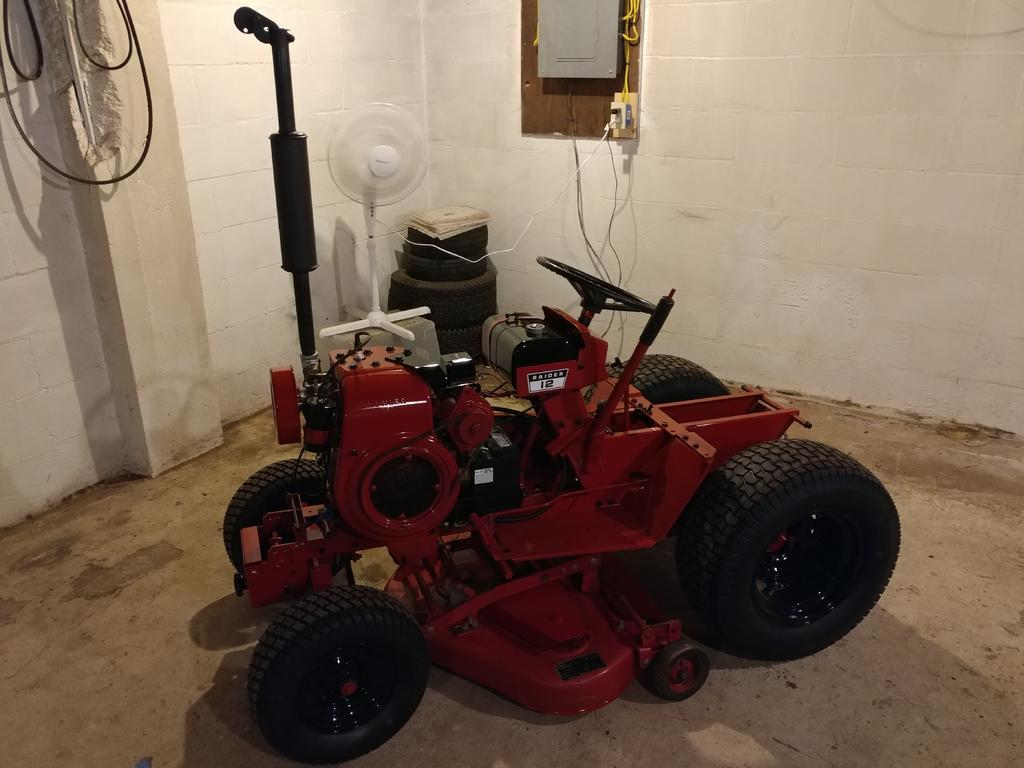

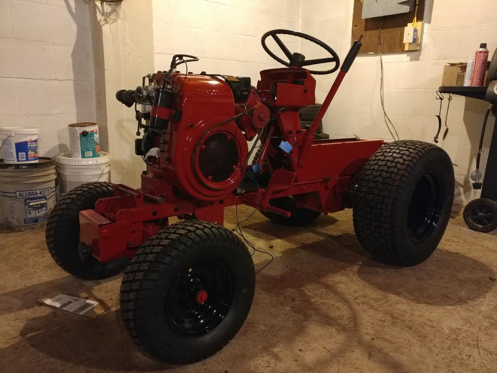

Joshn569 273 #91 Posted April 27, 2018 Progress update: been kind of slow going but I got the battery in, cables routed and a few other odds and ends done. Hope to drop the hood and fenders off to be blasted next week. Need to coat the fuel tank this weekend and then I think I can fire it up. 5 2 Share this post Link to post Share on other sites
Achto 32,141 #92 Posted April 27, 2018 Looking great!! 1 Share this post Link to post Share on other sites
rjg854 13,247 #93 Posted April 27, 2018 Very nice! 1 Share this post Link to post Share on other sites
RandyLittrell 3,944 #94 Posted April 28, 2018 Very nice, I am digging the black and red theme!! Randy 1 Share this post Link to post Share on other sites
Sarge 3,473 #95 Posted April 29, 2018 That thing is really coming along - can't wait to see it finished. Sarge 1 Share this post Link to post Share on other sites

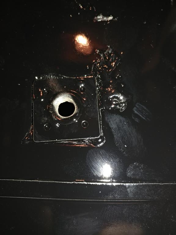

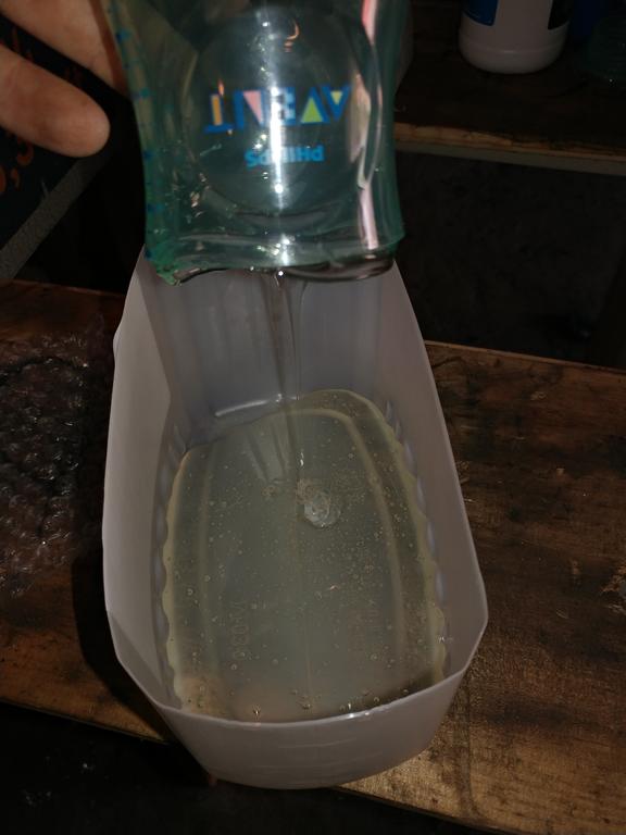

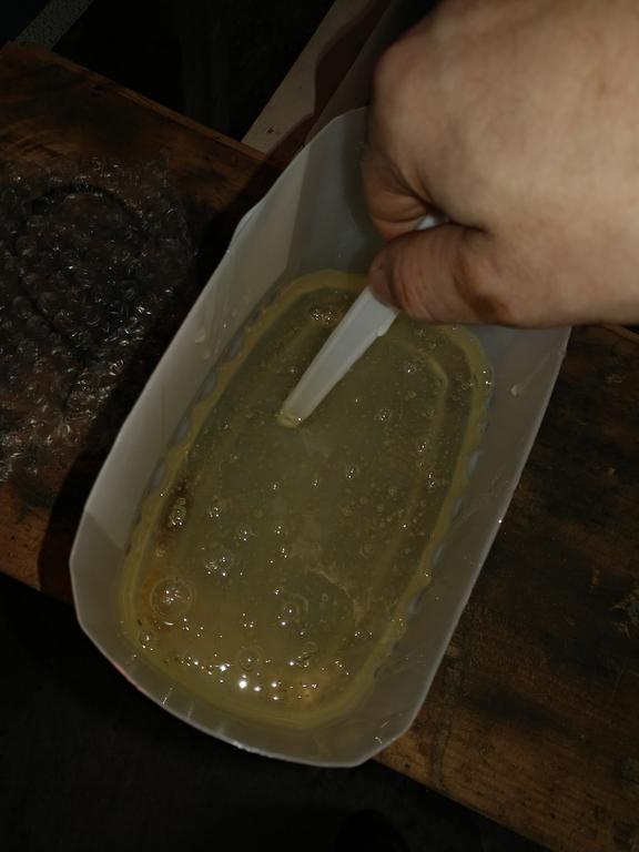

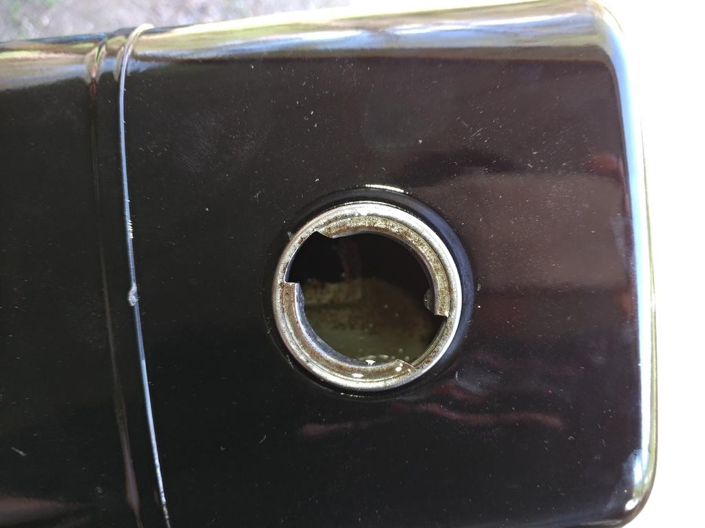

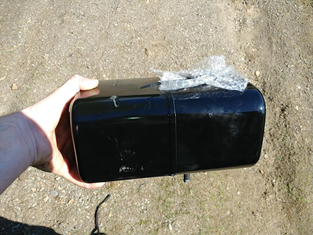

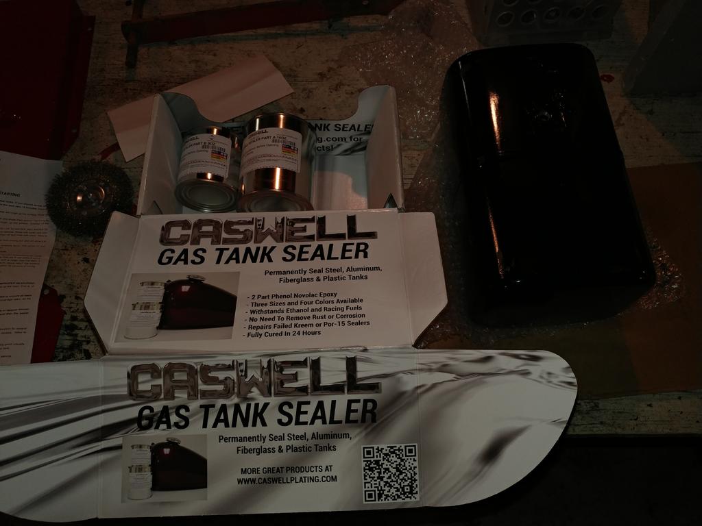

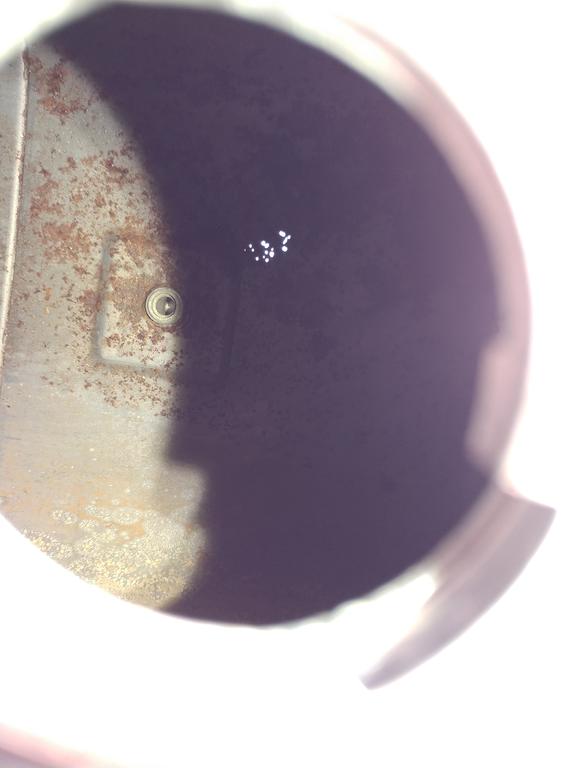

Joshn569 273 #96 Posted May 9, 2018 Finally got a chance to seal my fuel tank. I had to solder some rust pin holes that appeared after I stripped the old pain off. I leak tested it and it held so after the sealer it will for sure be good. Im using Caswell and they say you could just use duck tape over any holes so my haggard solder job should be good. Mixed up some epoxy and coated the tank. Needs to dry for 24 hours then I may need to repaint it because I spilled some epoxy on it eats up spray paint quickly but so close to firing it up. I had to get emergency surgery last week (appendicitis) 👿so I was not able to get my hood out for blasting. I have the deck almost rebuilt but the grass is already needing mowing so the c81 will have to do it. Thats ok though, she can always get the job done! 3 Share this post Link to post Share on other sites
Achto 32,141 #97 Posted May 14, 2018 Nice save on the gas tank! Looks like your getting close & I'm getting anxious to see the finished product. Hope all is well after your surgery. 1 Share this post Link to post Share on other sites
Mike'sHorseBarn 3,637 #98 Posted May 14, 2018 Never saw that brand of tank sealer before. Anxious to see how it holds up! 1 Share this post Link to post Share on other sites
