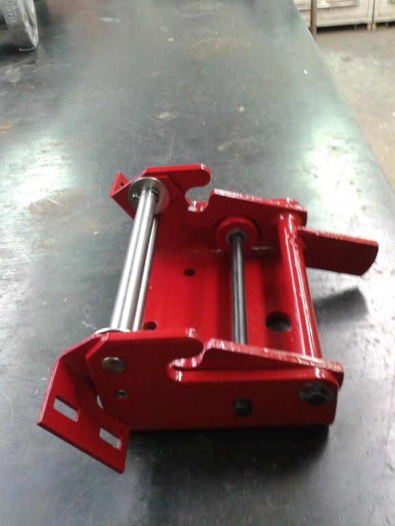

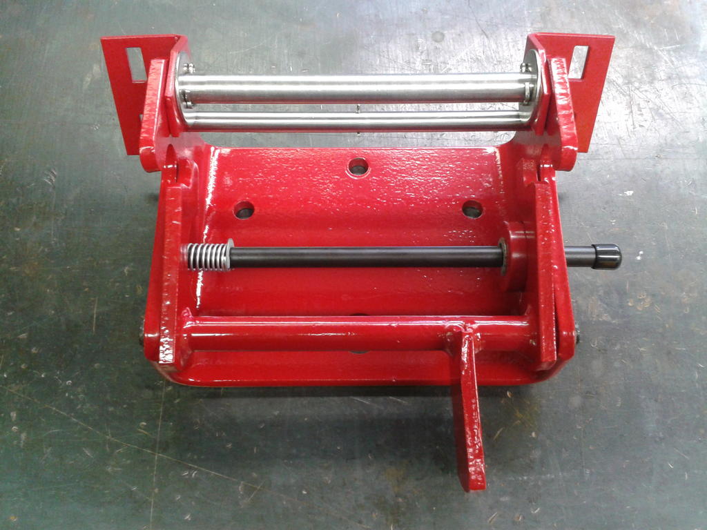

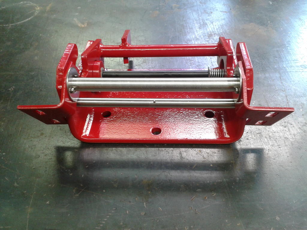

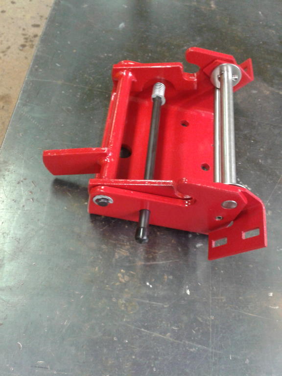

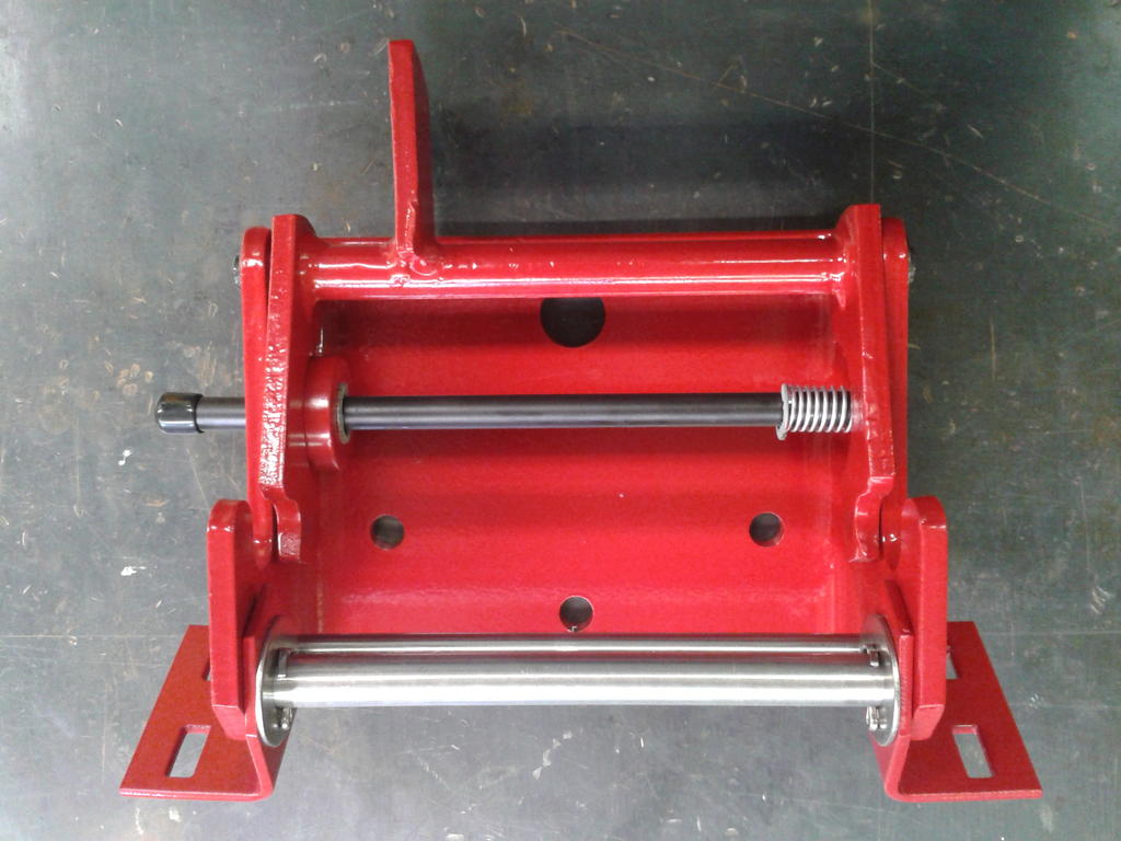

cleat 8,740 #1 Posted January 30, 2018 I rebuilt this front hich. Hood hinges were worn so pivot was drilled to 1/2" and a new pin made up. Hood stop was worn and I don't really like how the factory put the cotter pins at the ends where the hood hinge hits them so I made up a new 2 piece design. Here are the plans for the pivot pin and hood stop. Oversize hood pivot pin.pdf Wheel Horse hood stop pin.pdf Cleat 13 9 Share this post Link to post Share on other sites

cleat 8,740 #8 Posted January 30, 2018 Thanks guys, I have done this to all 4 of my 520's now. Hopefully the 1/2" rod lasts longer than the 30 years it took to wear out the originals . Cleat 3 Share this post Link to post Share on other sites

cleat 8,740 #11 Posted January 31, 2018 1 hour ago, WHX14 said: And I suppose you are gonna tell us those pins are stainless?? If so be prepared to move here and don't for get to bring your machine tools..thats all you will need.. I got a nice condo I can set you up in! It's just geography..... Yes, both pins are 316 stainless as well as the cotter pins and washers. Time will tell how it will wear. Good I hope as I now have stainless pins all over my machines. Condo will work as long as it comes with a large shop and garage. Cleat 1 1 Share this post Link to post Share on other sites
