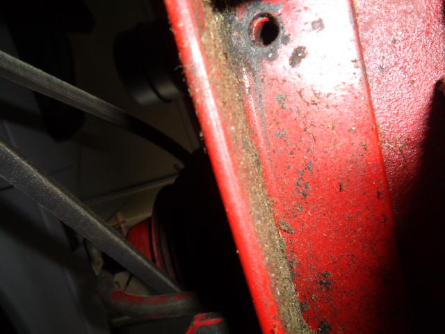

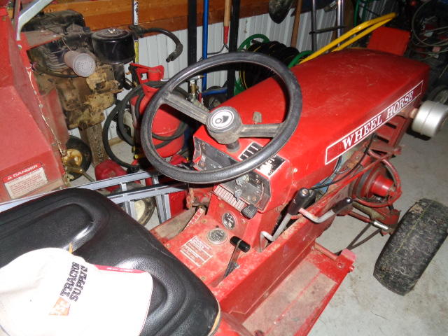

etohio 4 #1 Posted January 29, 2018 I just bought a c-160 and the bottom line is I just did not know what I was doing. The problem is I noticed the engine had been changed but it looked ok and it was a k341. I got it home and noticed a lot more vibration than I thought it should have. The tag on the tractor says c-161 and I saw a post on the differences between 160 and 161 so I started investigating ( I know I should of done it first) the gas tank is on the tower and the battery is behind the engine but the engine has what i think is the large oil pan and it is mounted with 2 bolts with the right hand mounting holes with nothing in them since they are outside the frame. Do I need to find a small oil pan? Does the small oil pan mount directly to the frame? there are what look like mounting holes that might line up. Any ideas would be a great help Please don't laugh too hard....... Share this post Link to post Share on other sites

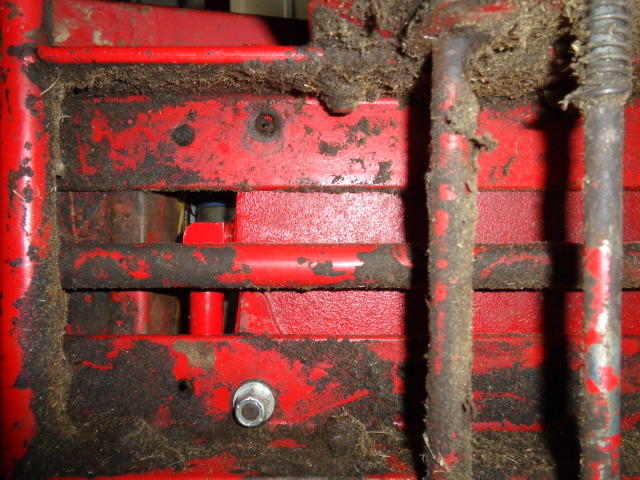

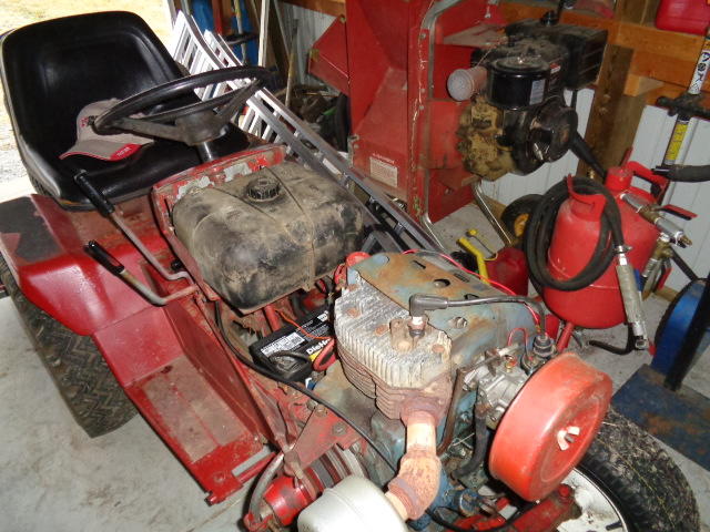

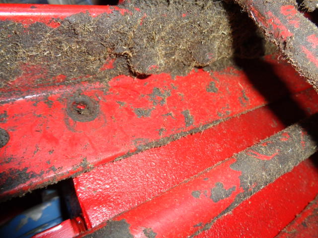

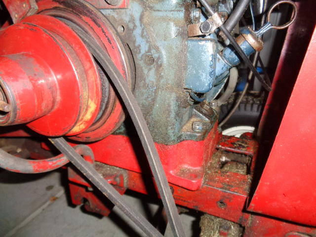

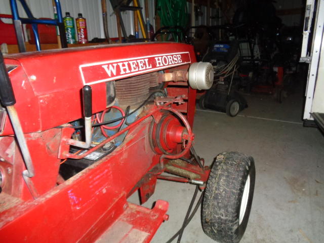

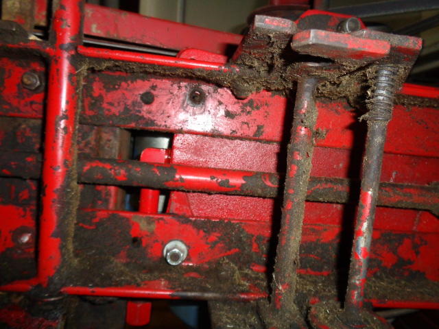

etohio 4 #8 Posted January 29, 2018 Here are some pictures. If I am looking at this correctly the worst is that I have to replace the oil pan. It appears that there are no bolts mounting the right side of the engine also I think this is a C-160 but I could be wrong. Is the oil pan taped for the mounting on the right or does it go through to the block? I really do appreciate any help. I have always loved Wheel Horses and I just jumped in. The tractor came with a nice deck and it does look OK I am just a little frustrated but it will work out. Ed 1 Share this post Link to post Share on other sites
oldredrider 2,553 #9 Posted January 29, 2018 The engine mounting bolts are missing on the right side. They only thread into the pan, not the block. Check to see if the pan is threaded where the missing bolts should be. It is a C-160, however, it has a replacement engine. No biggie. Appears to be a 1976 model. Let us know if you find threads in the pan. 2 Share this post Link to post Share on other sites

etohio 4 #12 Posted January 29, 2018 The front mount is threaded but the rear looks like it has a snapped bolt it it. I might be able to use a easy out but my luck with them is not good. Any idea what size and thread the mounting bolt should be and how long? Ed 1 Share this post Link to post Share on other sites
BOB ELLISON 2,983 #13 Posted January 30, 2018 I think the bolts are 3/8 -16x1 or 3/8 -16x 1 1/2. I know there 3/8 but to be sure put a rod up the hole and use 1/4 inch shorter bolt. Use lock washers on the bolts. 1 Share this post Link to post Share on other sites
