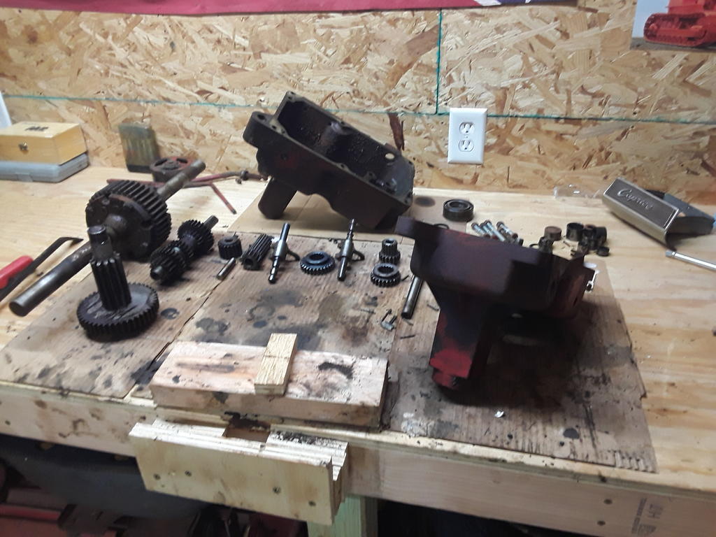

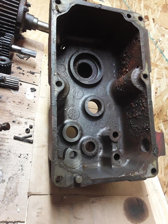

ClassicTractorProfessor 5,455 #26 Posted January 12, 2019 Not much progress to report on, but little progress is still better than no progress. Broke down and bought a parts washer last weekend, best $100 I ever spent. Got most of the pieces to the transmission cleaned up. Looks like everything besides bearings should be able to be salvaged. 4 Share this post Link to post Share on other sites
Pullstart 71,135 #27 Posted January 12, 2019 They sure do make messy jobs nicer to work with, huh? Share this post Link to post Share on other sites
c-series don 12,374 #28 Posted January 13, 2019 I would be so scared that I would not remember how to put that back together 😳 Share this post Link to post Share on other sites

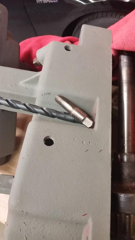

WHX?? 57,846 #29 Posted January 13, 2019 Now would be a good time to add a 2nd over the hump drain plug Prof. 1 Share this post Link to post Share on other sites
ebinmaine 80,401 #30 Posted January 13, 2019 1 minute ago, WHX21 said: Now would be a good time to add a 2nd over the hump drain plug Prof. Jim I thought about doing that with a couple of mine but I had not dared to try to cut threads into that cast-iron. Is that something that can be easily done ? Share this post Link to post Share on other sites
Pullstart 71,135 #31 Posted January 13, 2019 10 minutes ago, WHX21 said: Now would be a good time to add a 2nd over the hump drain plug Prof. 8 minutes ago, ebinmaine said: Jim I thought about doing that with a couple of mine but I had not dared to try to cut threads into that cast-iron. Is that something that can be easily done ? A good pipe tap, the right sized tap drill and some cutting oil, I can’t imagine it’s that tough. Great idea Jim! 1 Share this post Link to post Share on other sites
WVHillbilly520H 10,379 #32 Posted January 13, 2019 14 minutes ago, ebinmaine said: Jim I thought about doing that with a couple of mine but I had not dared to try to cut threads into that cast-iron. Is that something that can be easily done ? Cast iron is actually quite malleable, as long as you're tools are sharp should go quite well. U know our Ace hardware sells taps with the correct drill bit packaged together. 1 1 Share this post Link to post Share on other sites
ClassicTractorProfessor 5,455 #33 Posted January 13, 2019 40 minutes ago, c-series don said: I would be so scared that I would not remember how to put that back together 😳 They're not too bad, I've got all the pieces laid out in the order that they came out in, and the book is handy on the shelf beside my bench if I need to refer back to it. I figure after doing several NV4500s and a few Ford ZF-5s one of these shouldn't be too hard. Now the real challenge will be when I finally decide to tackle the 4L60E in our TrailBlazer...THAT might be a challenge 18 minutes ago, WHX21 said: Now would be a good time to add a 2nd over the hump drain plug Prof. I have considered this idea before, not only on this tractor but on my worker C125 as well, but like Eric I'm a little concerned about cutting threads in the cast housing 1 Share this post Link to post Share on other sites

WHX?? 57,846 #35 Posted January 13, 2019 Cast is very easy to tap. Hardest part is getting the tap started in strait with the called for 7/16 drill on a tap chart for a 1/4-18 NPT. Using a tad larger drill, 29/64 will help and still give good threads. I also make magnetic drain plugs. 3 1 Share this post Link to post Share on other sites

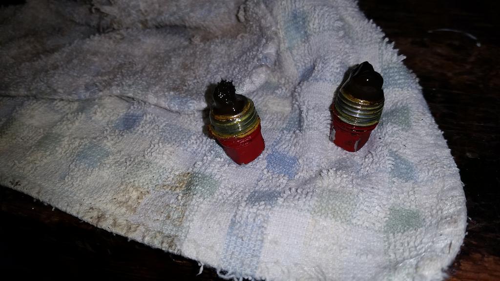

ebinmaine 80,401 #36 Posted January 13, 2019 7 hours ago, WHX21 said: make magnetic drain plugs. Make? Do tell..... I've been known to stick a neodymium magnet to an engine block on the outside near the drain exit. Share this post Link to post Share on other sites
WVHillbilly520H 10,379 #37 Posted January 13, 2019 2 hours ago, ebinmaine said: Make? Do tell..... I've been known to stick a neodymium magnet to an engine block on the outside near the drain exit. You can buy them at auto parts stores already magnetic. Share this post Link to post Share on other sites
WHX?? 57,846 #38 Posted January 13, 2019 1/8×1/4 round magnet off eBay cheap. 1/4-18 npt square head drain plug from the hardware store. Drill a hole in the end of the plug and a little JB weld to hold it in. I usually get the deer in the headlights look when I ask for them in 1/4-18 npt at the auto stores. 1 Share this post Link to post Share on other sites
AMC RULES 37,259 #39 Posted January 13, 2019 Just search "magnetic oil drain plug"...ebay has 'em in multi packs for cheap $. Share this post Link to post Share on other sites
