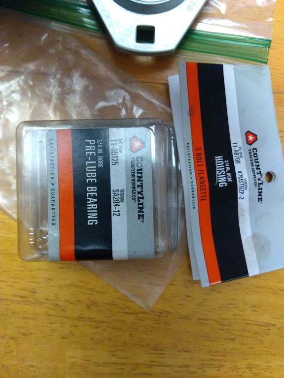

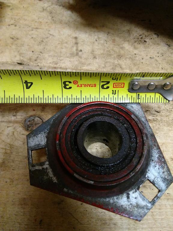

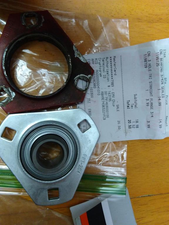

Jgoodsell 19 #1 Posted January 26, 2018 I just wanted to share with everyone that I was able to replace the original bearing that was 3/4" ID and 2" OD with one from Tractor Supply. The only thing I had to do was locate a replacement housing for the bearing, which happened to be located right next to the bearing. The holes line right up with the existing and the total cost was $20.The bearing was almost impossible to locate since I didn't want to spend $70+ for the wheel horse branded one. Part numbers are 11-95125(bearing) and 11-98409(housing). See the attached pictures for more information. Let me know if you have any questions or concerns. The bearing being replaced was the upper on on the shaft that runs the chain. 4 3 Share this post Link to post Share on other sites

Jgoodsell 19 #4 Posted January 28, 2018 On 1/26/2018 at 4:35 PM, squonk said: Those bearings are common to any Napa or Ag eq. store. The trick is having the Brg. number and not the Toro number. I find TSC always seem to have all of it in stock including the sprockets. The problem is they stock 1 in the store and you need 2. Fortunately I have 3 tractor supply stored within 50 miles of me so I usually don't have an issue locating them. Napa couldn't get these bearings supposedly because they didn't have access to the correct size, but I have little to no faith in the NAPA around here. On 1/27/2018 at 12:40 PM, USHorse said: That is good to know. I have the need for one right now. I am not sure if the shaft on my blower is 3/4". I feel there wheelhorse had another shaft size. You can just measure the shaft easily with a tape measure. I was not able to use the existing bearing because the shaft wrecked it because I did not catch it when the bearing started blowing out. Luckily Tractor Supply has a no issue return policy here so I just had to make a few stops to get it figured out. Share this post Link to post Share on other sites
